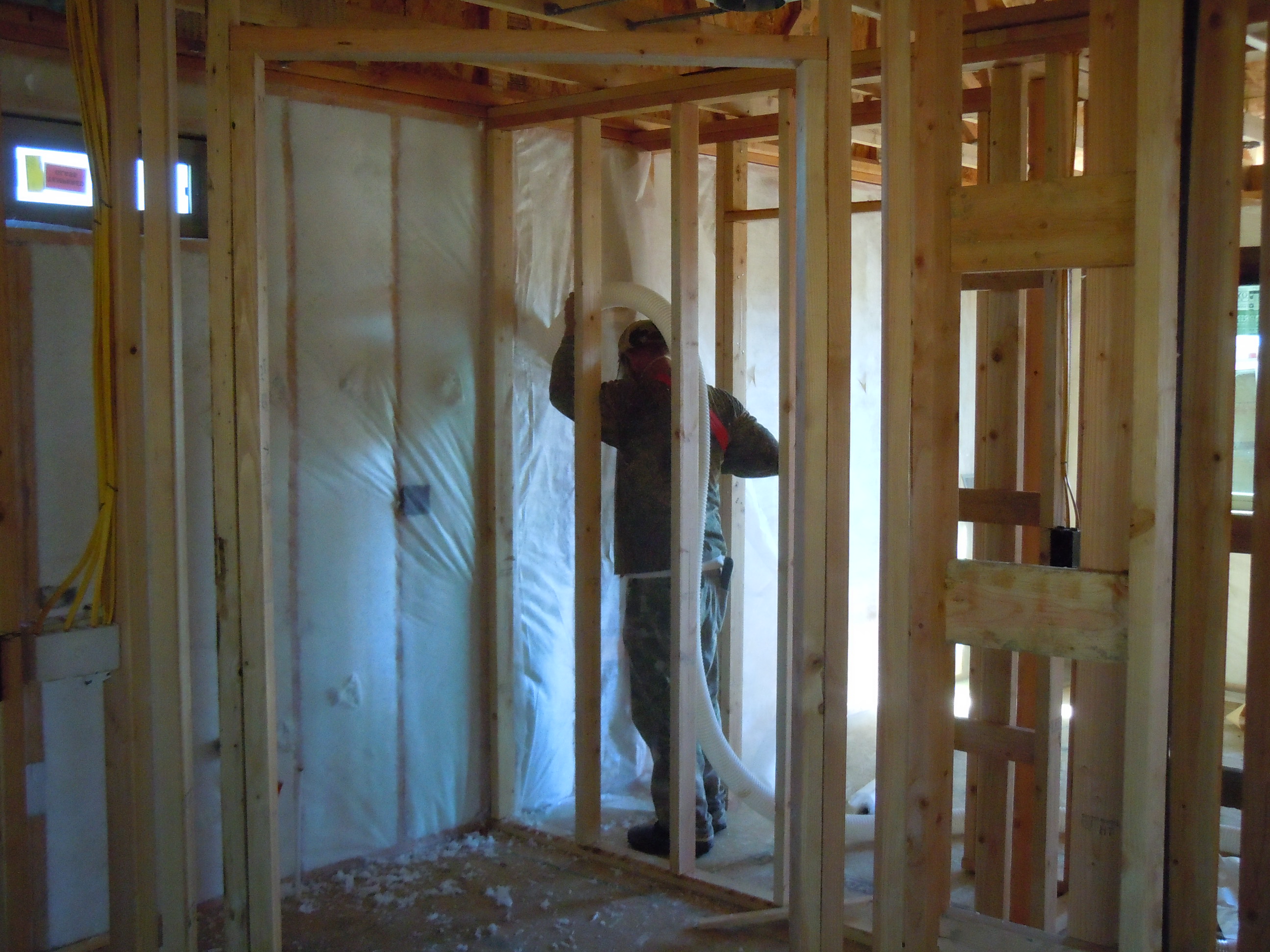

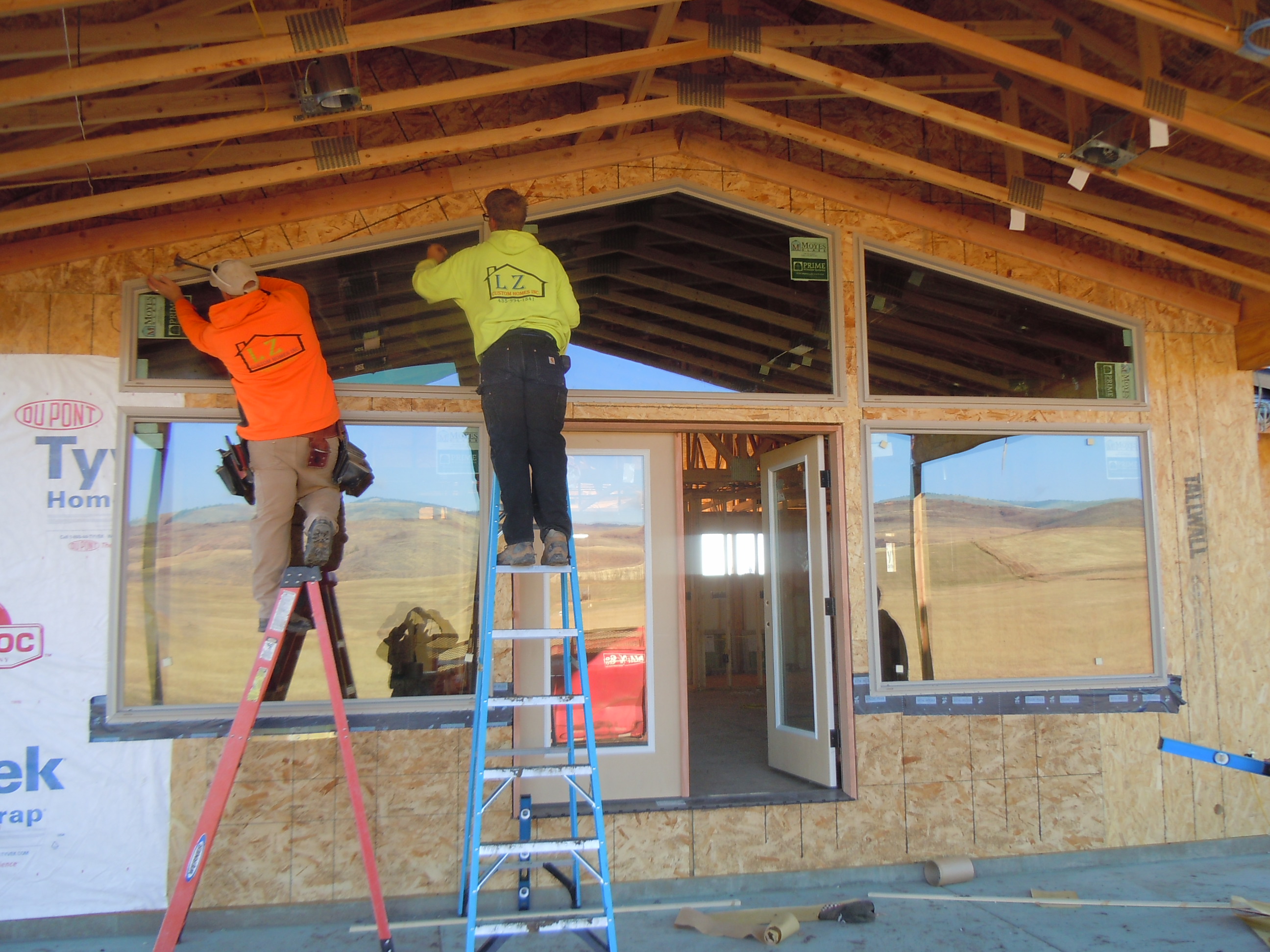

Since you are spraying foam in your walls, does that mean that you are not using house wrap? How will you get a good seal around your windows?

The house will still get the wrap. In fact it should be today. I'll get some pictures.

Would spray foam on the inside and house wrap on the outside not trap any moisture that happens to get in between? Or am I worried about nothing?
   / Starting our new life #484
My thought as well. Suppose if it is sealed well on both sides, no worries but I understood that depending on your local climate/humidity, the vapor barrier should be on one side or the other.
   / Starting our new life #485
In our area diligence is needed in regards to ventilation. Often in conjunction with spray foam an ERV system is added to control the humidity level inside the house.
   / Starting our new life #486
There would be no voids for air or moisture with the house wrap attached the the exterior walls The foam will stop all air movement, so the house wrap is more of a moisture barrier to protect the OSB from what might get behind the siding of the house.

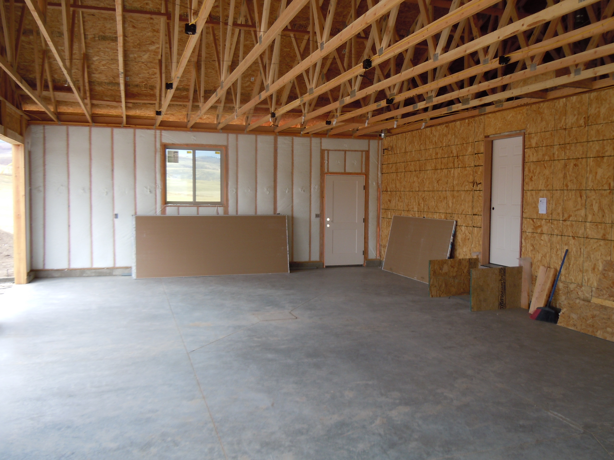

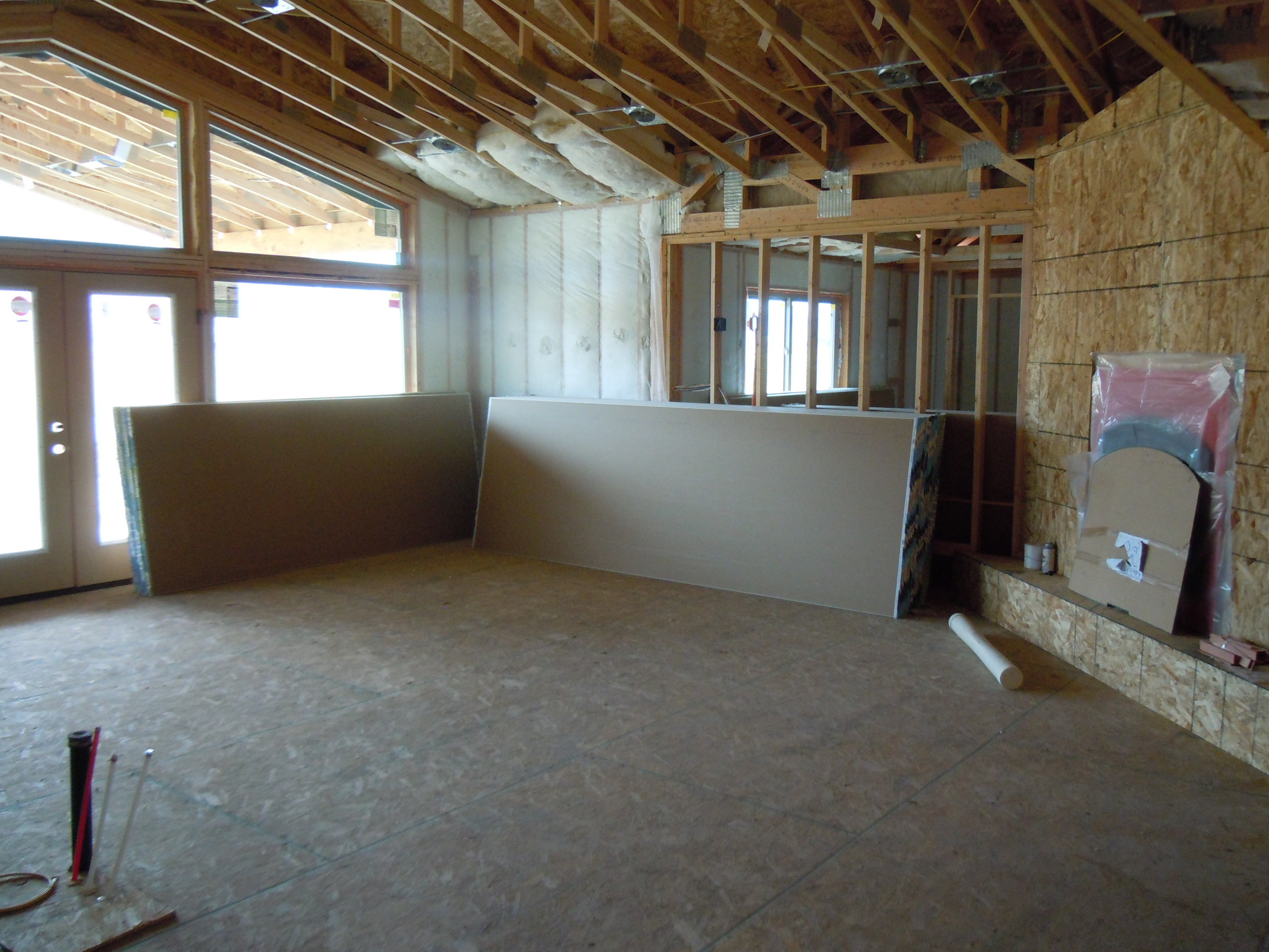

Eddie nailed the moisture issue! Plus we don't have the high humidity that many of you deal with.
Doors/windows are installed. Insulation complete.
The rest of the concrete work will be poured tomorrow morning. Steps/landings a small pad out the front of the house and 10' more in front of the garage.
The sheetrock was delivered this morning so I would expect it'll get rocked soon.
Here's a few more pics.

Just in time. Love the new sound (or lack there of) after insulating. Great window's for that great view.
