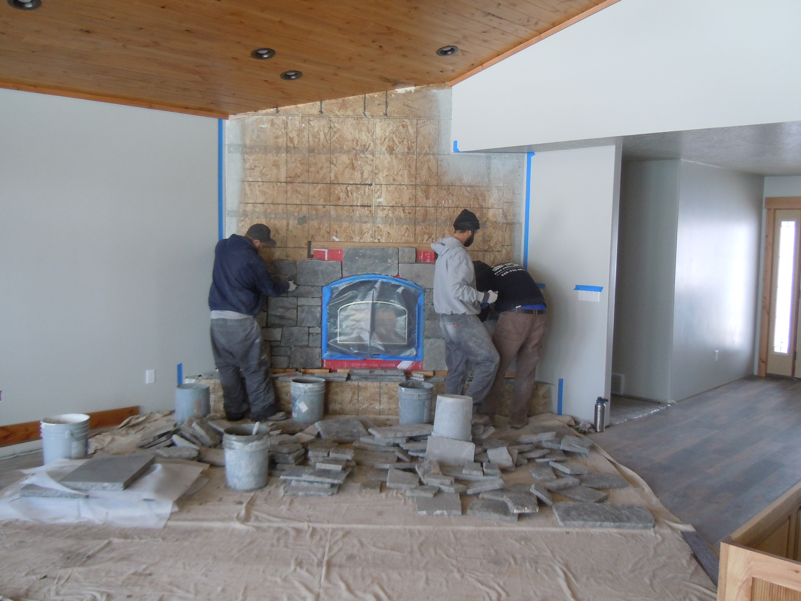

Forgive my lack of the right terms;
They stapled up some wire mesh, mixed up some commercial grade quickcrete, smeared the concrete on the back of the rocks and smashed them into place. It was all very simple. They were very particular on which stone went where. They did a lot of cutting and chipping to get the rocks just right.
They did suggest that I wait a couple weeks then wash the rock faces off with water, let it dry, then wash with water and a small amount of muriatic acid mixed in. Then wash again with plain water. Said it would really bring out all the color in the rocks.
Pardon me for digging deeper, but was the wire mesh stapled to plain old 1/2in sheet rock?
Be curious to know as well. Normally they use lathe screws (big wide flat head) and screw the metal lathe down through the wallboard (sheetrock or plywood) so that the screws hit studs.
The wire mesh was stapled to the OSB that was nailed to the 2X4 studs. I do not remember how thick the OSB was, but more than 1/2" for sure. No sheetrock was put on that wall.
Here is a "as it was happening picture".
   / Starting our new life #675
I love watching those guys work, poetry in motion. The way they flip the stones around and chip is amazing.
   / Starting our new life #676
What kind of staples? Those stones are heavy. You are not really in earthquake country so that is good.
#677
They were big staples; 1.25" long and an inch wide. Just guessing, I've never seen staples that big and they were shooting them in like they were free. I guess to everyone but me they were free.:laughing:
