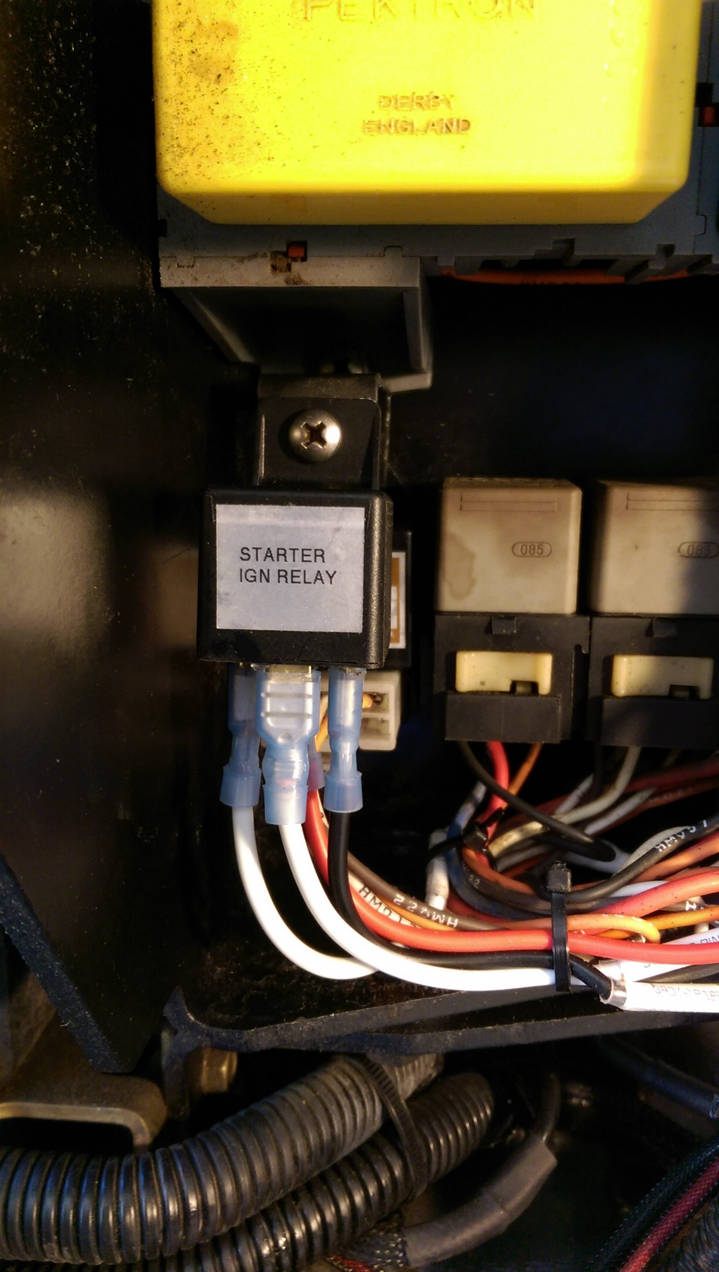

@HotDogNewHolland - I'm with @thclimer on this... We have both (& many others) suggested this fix multiple time on this forum... It has worked on our TC40D for the past many years with no issues...
If you think you are comfortable enough installing a pre-wired starter relay mod, I could wire one up & send it out to you... You would need to splice it into you harness...

Below is a PDF diagram that was posted a while ago by another member of this forum... It is a pretty clear outline of the NH Starter Mod...
I also attached a pic of the relay I installed on our machine
  • Starting Circuit Modification.pdf
