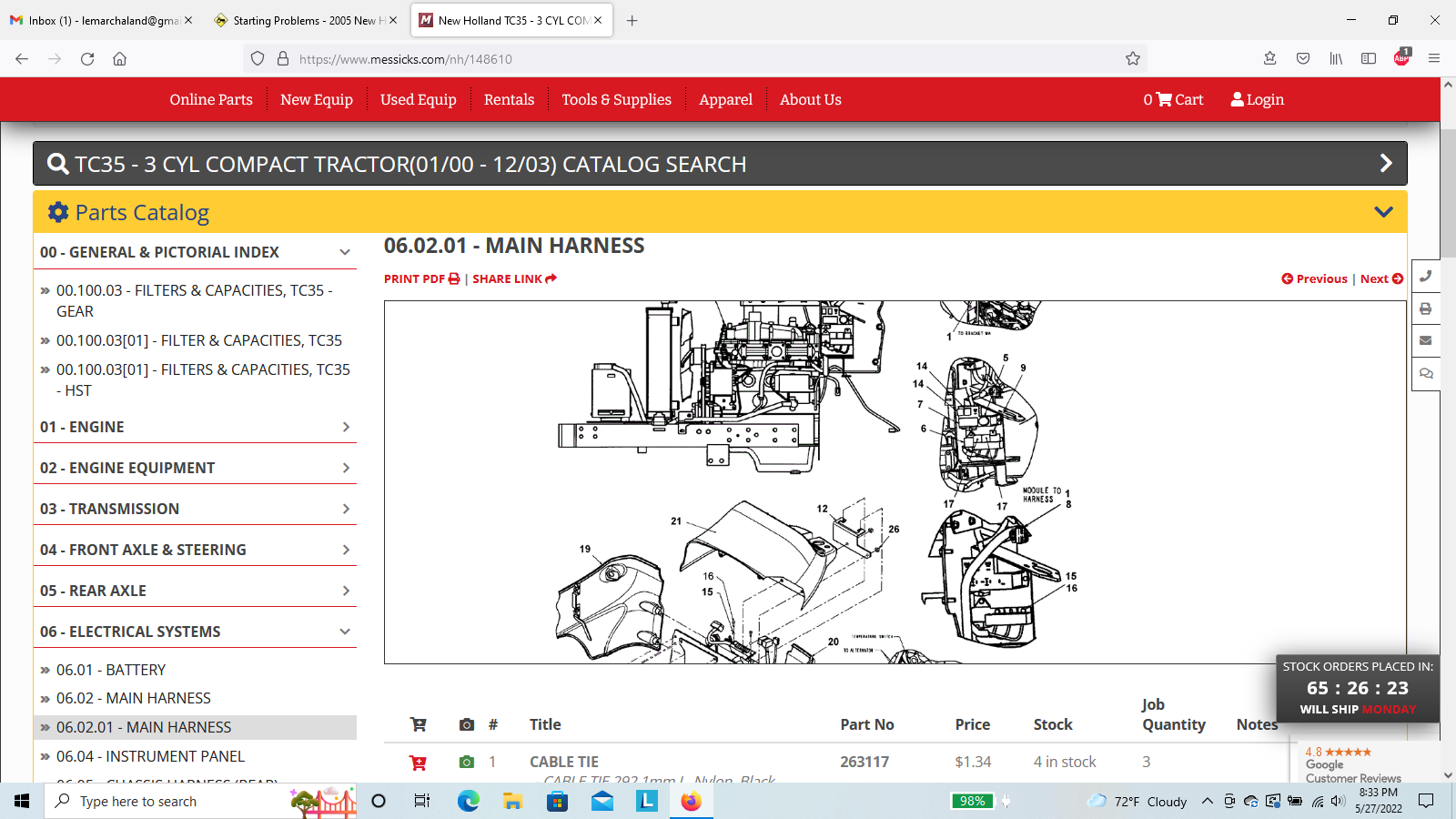

New Holland TC35 - 3 CYL COMPACT TRACTOR(01/00 - 12/03) Parts
items; #7, 9, 14, and 17 are all relays.
When you switch your key on if you can put your fingers on the relays when you turn the switch from run to start you may be able to feel
the relay activate you could swap the one that feels like it's getting energized with another of the same configuration.

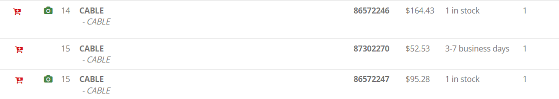

The safety switches will allow it to turn over. They stop the fuel solenoid from opening so the tractor turns over but does not start. A common problem was internal corrosion at the factory battery terminals where they were crimped. It allows voltage to pass but not amperage, so a voltmeter shows everything OK but not enough amps flow to allow it to start. To check if that is an issue you can bypass the cables with a pair of jumper cables. Or just replace them with new ones from the auto parts store. At the age of the tractor new ones won't hurt. Clean the connections at the same time.
   / Starting Problems - 2005 New Holland TC35A #18
This is why I recommend cables from the auto parts store instead of NH cables. The #14 is the ground cable, #15 is the positive cable.

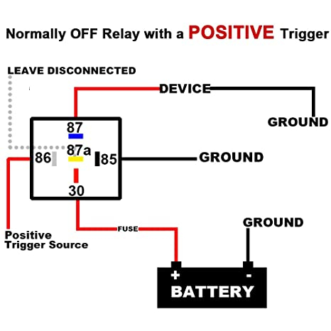

I have had this problem on several tractors (especially older John Deeres). There seems to be to much voltage drop on the small wires in the loop to the starter solenoid. From where ever the ignition switch is getting it's power through the switch contacts then through the various safety contact switches then to the starter solenoid. There isn't enough voltage/power to pull the starter solenoid completely and engage the starter motor gear and make contact with the heavy duty switch at the back of the solenoid which connects the battery to the actual starter motor.
To remedy this put a small 40amp relay right at the starter "https://www.amazon.com/PACK-AMP-Wat...lja1JlZGlyZWN0JmRvTm90TG9nQ2xpY2s9dHJ1ZQ&th=1"
All the key switch has to do is pull this small relay which will power the starter solenoid. See attached diagram. What you want to do is remove the small trigger wire from the solenoid and connect it to pin #86(white wire). Ground pin #85(black) to block. Wire pin #87(blue) to small terminal of solenoid where you removed the key switch wire. Run a wire from the large battery terminal to pin # 30(red). Now when the key switch actuates the low power relay the solenoid is going to get full 12 volt power. Hope this is making sense and good luck.
