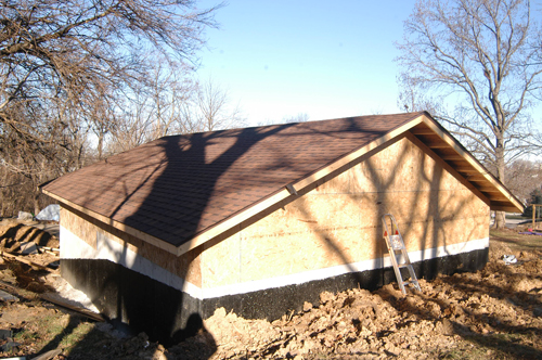

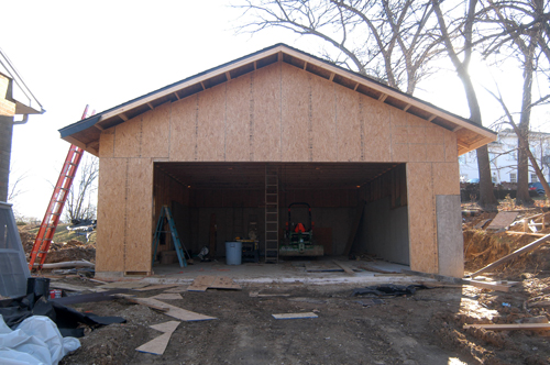

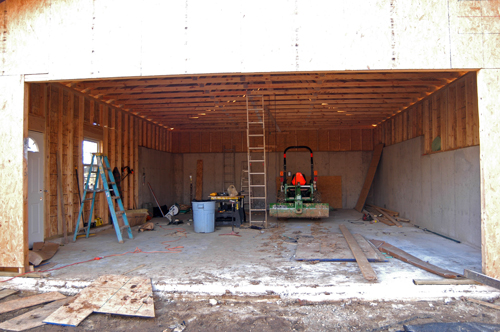

well step by step things are getting done, now more slowly now I am back at work 6 days a week.
We got the door window and sheeting all done plus roofing, then I did bracing in the trusses and at last the back filling or some of it.
I am hoping that I finish this garage before my granddaughter gets out of high school and her mother pictured her is my age.
Roger

   / Step by step photos of new garage #136
Fear not, your progress is not in doubt. It will be finished before you realize it.:D
   / Step by step photos of new garage #137
Roger,
Nice to see all the progress your making. Isn't it fun to look back and remember the hill and dirt that was there before you started, and to know that an idea you had has turned into an actual building? That's one of my favorite things, to turn pictures in my brain into reality.
I think you'll find that things really start to slow down now as far as noticable progress. You'll work just as hard, but it will be tougher to see the changes. Then all of a sudden, it will be done. This is what happens to me when I build something.
Thanks for the updates,
Eddie

ok i can weight in on the bracing issue as im an engineer for Alpine (now ITW building components group) Home
The links posted showing various rows of lateral and diagonal bracing are indicated as TEMORARY bracing ment to be used during the erection of the trusses. a separate PERMANT bracing plan can be issued by a design engineer.
The truss drawing you show will indicates what permanent bracing the component truss needs. This information that is circled on your truss drawing. IF you use a diaphragm on the roof (OSB sheathing) you do not need any other diagonal and or lateral bracing of the Top chord (TC). Temporary bracing can be pulled off as you put down the permanent sheathing.
From your pics it looks like your BC still needs bracing. Your drawing indicates that 1 continuous lateral brace is required ever 10' OC or less. you can contact your truss supplier for a CLB detail, they should have one on file. It will show you what is considered appropriate material for CLB bracing, and how to attach it.
Additional bracing is needed on the gable ends to. But it is relatively minor due to your low 90mph wind criteria. Again Mytec has a detail of standard gable bracing that can be applied (ask the fabricator for a copy).
Next time sheet the gable on the ground (or laying down on the wall plate temporarily supported flat) BEFORE you stand it up and it avoids your sheathing problem.
