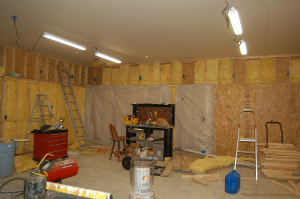

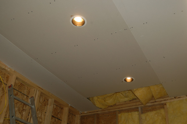

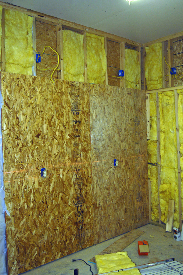

Well got the ceiling lights installed, and started puting up the osb. I can already tell how much better it is to heat. I stuck a thermometor in behind the insultion against the cement and then room temp and temp at the osb and there is better than 20 deg diff I would say.
I love being able to walk in and turn on lights instead of using floor lights. Made it like day time in there.
Over this work week when I get home from work I hope to have all the lower 4x8 sheets up, some time this week the garage doors should be up. Then I have to cut the drive down 5 or so inches to get ready for base rock for the drive.
