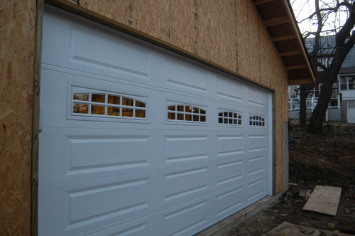

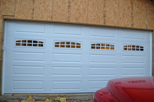

Doug, I check with insurance company and any kind of wood or pellit heat is out. I would love to heat by wood, I do my house go figure. I am thinking of doing the siding myself just got to find a book on how.
Got one of the two doors in today, boy that made a diffrence on the looks of the garage and a lot of hep in heating the garage. Tomorrow the matching door for the garage in the house.
Roger
