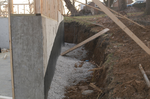

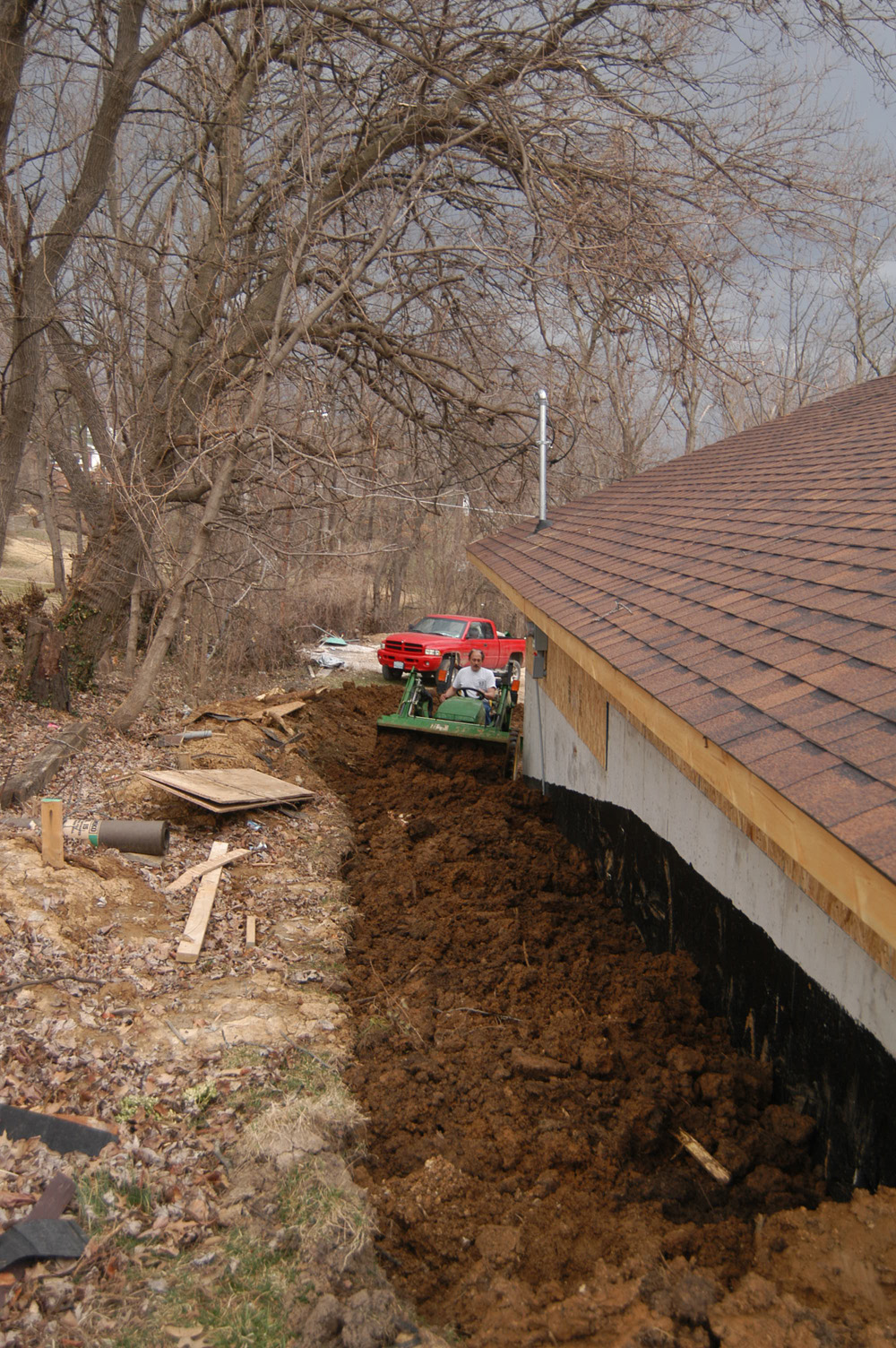

Well with the nice weather (80 dr) I was able to back fill the west side of the garage. With the post is a before back fill and a after back fill showing about 80% done. Still need to bring it up about 2 ft.
This had to be the most scary thing I have done with my tractor: 24 horse jd with bucket.
The ground was uneven and I had to make a larger opening on the right so I could drive in over the fill as I went up hill. The trouble was the opening was just wide enough to get the bucket and back rear blade in. ( I use the blade for counter weight)
The soil on the left was very soft and the tractor wanted to settle in on the left. The soil on the right was harder because it was not cut into as much. So every 4 loads or so I would place a half bucket more on the left to bring it up more so I would stay level. A few time the wheel went down and the bucket would pin its self againist the wall. Oouch.
I had at time just 1 inch to play with.
3 hours later I was done and I turned off the lights and sat down glad it was over.

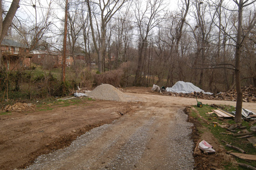

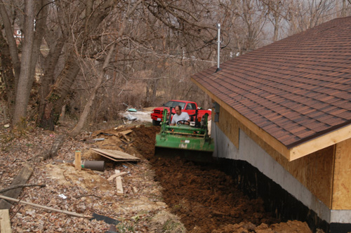

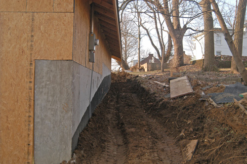

this evening I finihsed the back filling of the west side and south side of the garage, or until it settles and I need to top it off some.
About a hour later the neighbor came over with his bobcat and doug out the area for the pad and the drive. He did it in a hour, it would of taken me two days with my tactor. He might have another hour or two of digging.
I am hoping that I can get the gravel in on Fri.
One step at a time. I guess.
Roger

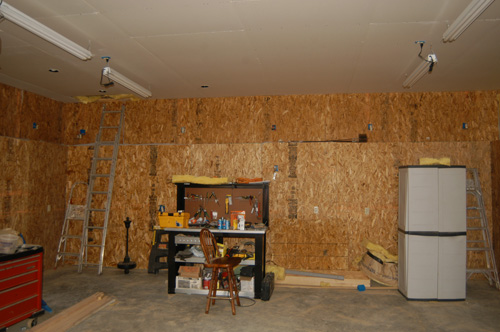

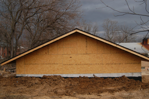

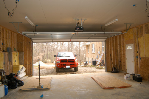

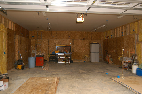

step by step I am getting closer to having the garage finished. I am about half way in getting the osb up and I have some out side wiring to finish before I can place the rest of the osb up on the inside to close in the walls.
Then I have to figure out the siding and the brick work on the front.
I have laid the 1st of the gravel down only to find the guy that cut the dive did not cut it wide enough. So over the next few night I will widen it myself. Tring not to dig up to much of what is down already.
I can now see all my work will soon pay off.
The weather is much better and I can work late now.
Roger
