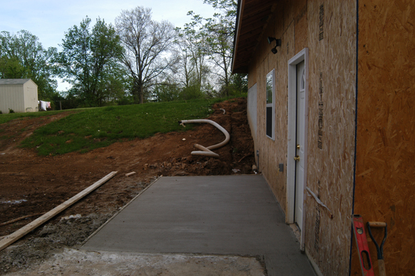

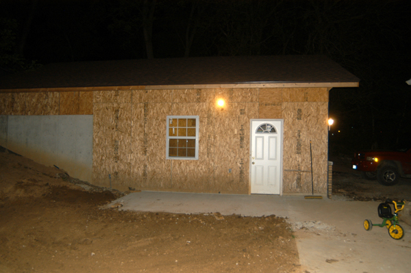

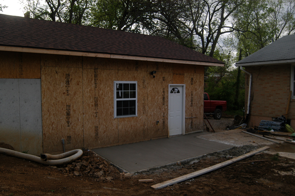

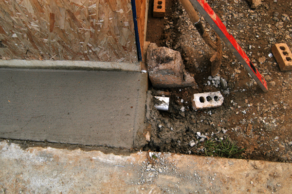

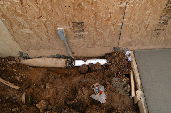

Got the pad in today. 14x8 5 inch thick 5 bag mix on 5 inch of crushed rock. With ½ rebar ever 2 feet going each direction.
Photo 1 pipe right shows the boot that takes the drain tile to 3-inch pvc. Then under the new pad.
Photo 2 shows the pipe leaving the pad on its way to a pipe laid when the house was built back in the 50’s that is under ground and on to the street.
The other photos show the pad and garage. It looks like in the picture the original pad is sloping at a funny angle but when you walk on it feels fine. While it does slope away from the house and to the left you cannot feel it. Why it looks funny in the photo I am not sure.
Sofit work tomorrow and brick work wed. Then on to pouring the paid I hope on Fri, if I can get off work.

Your rebar placement seems to be OK, however please be sure and use ample expansion joints. You cannot get too many, no matter how over-done it may seem.
One thing I'll tell you about rebar, you may already know; spacing is important on a horizontal plane but be sure and use rebar risers, brick chips, or something to get the rebar off of the ground. Even lifting it with a rake as one places the concrete (common among wire mesh users) the rebar will settle right back, rendering it much less effective than raising it up into the near center of the form. This is as important of a prep as I can think of. Otherwise, it's almost wasting your time and effort. Rebar in the bottom of a placement is not functional.
And another thing, fiber reinforced concrete should never be considered as a primary reinforcement method. It's not for the intent, as is the rebar that you are installing.

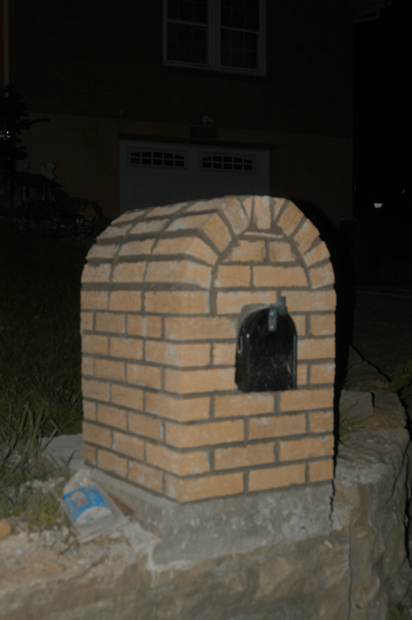

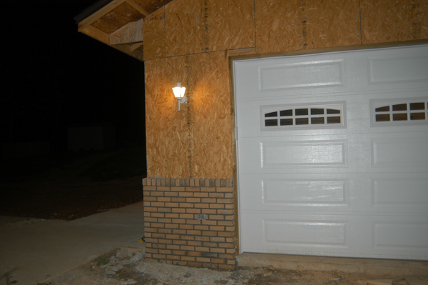

This evening I pulled off the forms and did some leveling on the yard. I had the brick on the front, and mailbox installed of the same brick as the garage a room addition I did last year.
I am going to form up the apron tomorrow and pour Fri.
At work I had 8 florescent light burn out had to rewire the whole office. And put in new lights. Also put a roll roof on the 100-year-old building.
Of course I have had help to cover all this work.
I am getting close to the end.
Roger

Nice mailbox enclosure. I like the brick, even on the garage.
