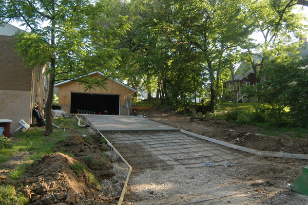

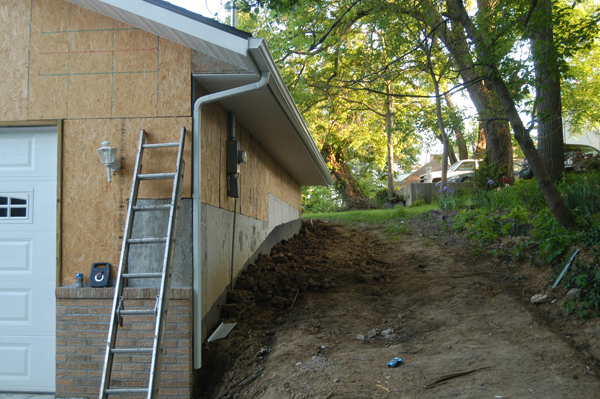

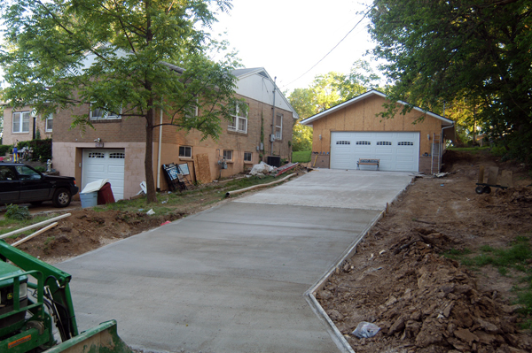

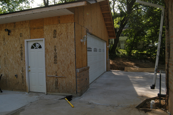

I am getting closer to getting this garage done. Fri. poured parking pad. Sat. hooked up drain line from east side of garage and tied to the house line. Cleaned up 4 months or trash from all the work. Got up some of the sofit.
Fri another 18x25 pour for the drive. Next week the last pour 30x18. I am going to try to find the vinyl siding to match the house and work on it this weekend.
I am now wonder what I will do after I am finished. Oh yea play in it.
Roger

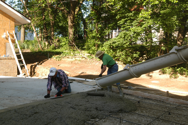

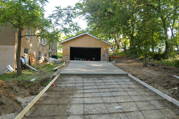

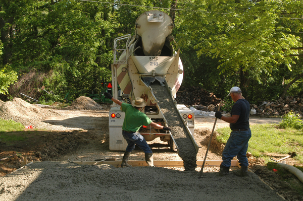

2 of three pours. 3rd and last pour tomorrow at 9:30.
Things started fine. Then the cement came fast and hard. And the fun beagin.
Last 2 photos show the spacing for rebar and for the next pour. And the flair out for the entrance.
Next step siding and guttering. Then landscaping.
Roger

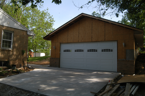

Garage 1 show my gutter I got up today. Heired it out because it is seamless.
Garage 2. showing the finished garage: I do not think I want to do more concrete any time soon,
2 yard for patio.
8 yard for parking pad
7.50 yard for middle pad (drive is 80x 16 faned at the pad)
8.50 yard for the last pad
14 yards for footing
8 yard walls
7+ for floor
total of 55 yards x 82 per yard. 4,510 dollars plus 1,000 buck for brother in law to help with it all.
Not bad for 5500 I thought.
Siding and landscaping tomorrow.
Roger
