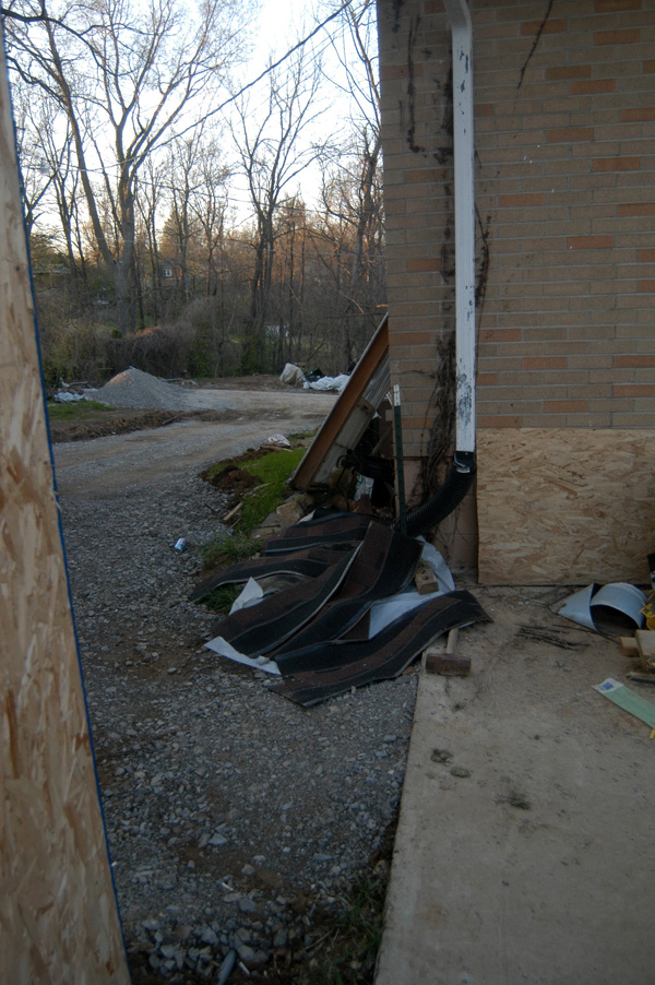

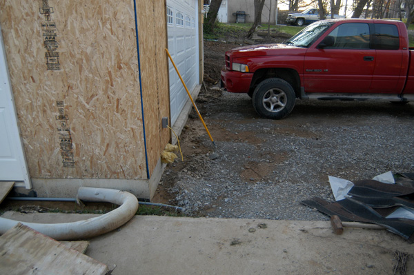

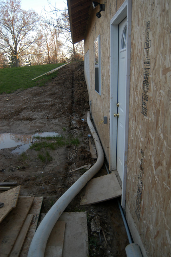

Ok guys the work on the inside is done. Finished up today boxing in the chase for the electric. I have a new dilemma.
The drain tile runs in back of the garage then on the west side to the front that’s ok.
On the east side the bank drops to ground level.
Question:
What do I do with the drain tile on the east side.
The 1st pic shows the hill and the length of the drain running along the garage. I cannot burry it because of the footing. Plus in front of the door I have to poor a pad and if the tub goes under that I would only have 1 inch of concrete on top of the tub.
I could go solid pipe going from 4 to 2 inch.
Our I can turn the pipe out into the yard.
Pic two is where the tub would run and finally into a down spout and drain line.
Any ideas.
Roger

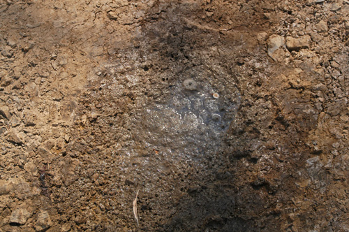

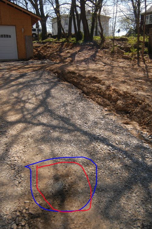

To date I have not had any issues I could not find answers to or help either here on this site or from friends. I have a new one pop up last week and I hoping for help here.
Picture one is a close up of a spot in my drive where a clear liquid is bubbling up and has been wet for 2 weeks, never gets wetter or dryer since it first showed up. I do not think it is a sewer or water line because it is slow, plus I had dig rite come up and the water line is on the other side of the property. Other water lines for other homes are hundreds of feet away.
I thought of springs but the yard was never soft before. I cut a lot of trees root could it be from that. Then if it does not dry up will it hurt to pour my drive on top of this. The rock on top is about 3 to 4 inches and I cut the yard down about 5 inches.

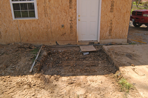

The last photo shows a small pad of 6x6 5 inch deep whole where my pad for the door will be. Would you mix by hand or wait until I pour the drive and pour with it. I do not want a mixer truck to bring just one yard. But I would like to have the mud whole gone. Not going to pour drive for a week or maybe 3.
Thanks for any help

   / Step by step photos of new garage #320
Roger do you have a septic tank and could that be a leach line that is now too near to the surface or a line that was crushed by a heavy truck.
