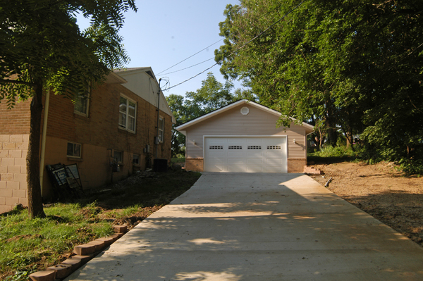

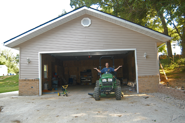

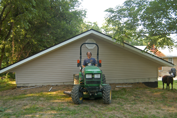

well all the siding is up:
the side shot shows I could all most drive my tractor up on the roof.
The back shot shows the floor of the garage is 8 foot down.
I still have to grade the side yard and build a wall to hold some soil on the east side so the tractor still has some work to do besides cutting grass.
roger

Wow Roermo... that looks fantastic!!
Of all the pictures you have posted, I like the one with you on the tractor in front of the garage with the door open... way to go... and I mean it.
   / Step by step photos of new garage
#375
thanks ultrarunner, when the wife wanted to take a picture of the gargae and myself thats all I could think to do, woow and a sie of relief. It has taken me almost 7 months to build working on the week ends and evenings. It has been fun and a large learning experience and a lot of fun.
Thanks for viewing.
Roger

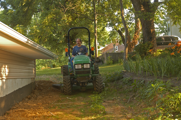

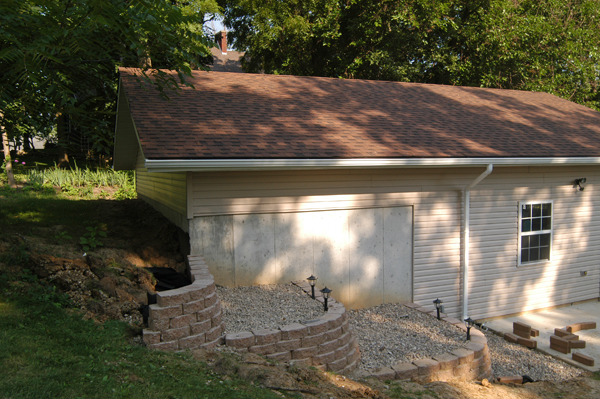

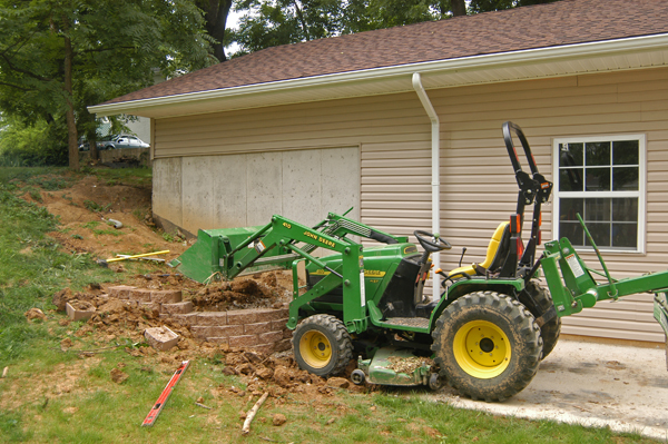

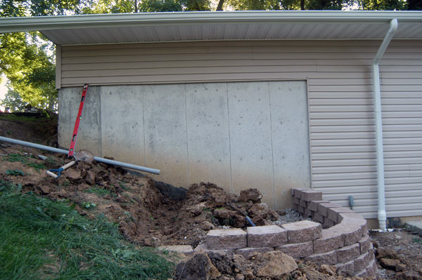

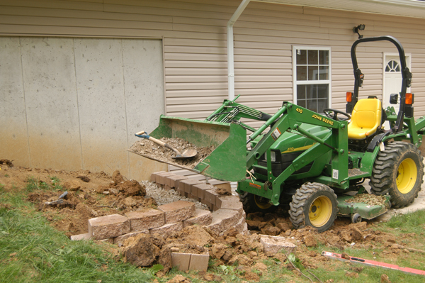

well on this fine sunday found yet another use for my tractor. Hauling the blocks and gravel to make my retaining walls on the east side of the garage.
Its fun to work on your project using your best tool.
Roger

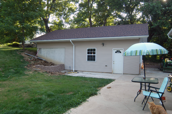

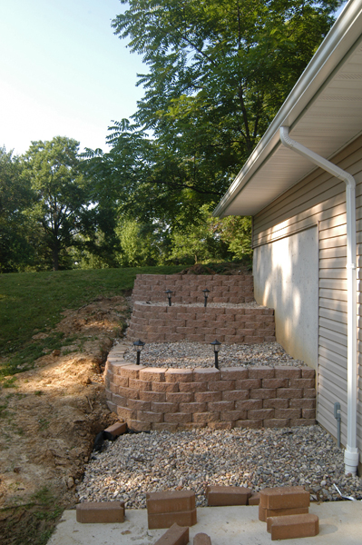

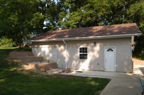

Ok folks; hope I can get yet again some good ideas like I have in the past on this project. ????????
I’ am just sprucing up around the new garage and house. I came across a problem with the grading of the yard. The drive has a few elevation issues. I thought I had it under control that was my 1st mistake. (see picture ground 2.) As you look from the street to the garage the left had side has a wall holding back the yard, which is higher than the drive. That works fine. The trouble is on the right side (see picture ground 1)the yard is level with the driveway and slopes to the drive and mud crosses it at an angel, then runs to the street. I want to try to get the water to stay in the yard and to the gutter not across the drive.
The way I see it is to remove 4 inches or so back to the right to the edge of my property, sloping it away from the dive. The only trouble is the street falls from right to left and has to leave some time. On the right side of the drive the neighbor ground is higher and there is a trough that diverts his water to the street. I cannot cut it out, so I would in a since have a berm there and my yard sloping to that berm. But I do not think I have enough height on the drive to does.
The other idea I have is to bring the block wall all the way down the drive. Which I can then back fill away from the drive.
Do any of you have any ideas? My tractor is game for more work
The 3rd and 4th pictures are of the almost finished terraces wall with out the capstone in place, which I am not sure I am going to spend the extra money for.
Once again thanks all for your ideas and viewing the project as I finishes up on this adventure.
