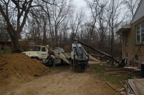

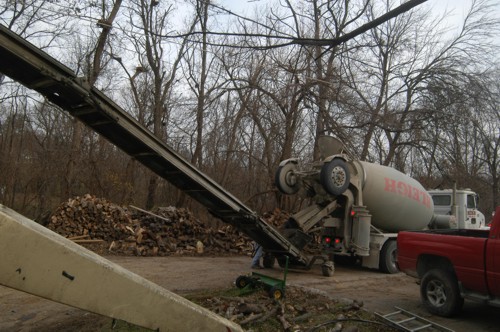

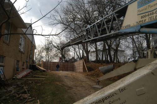

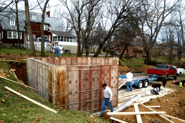

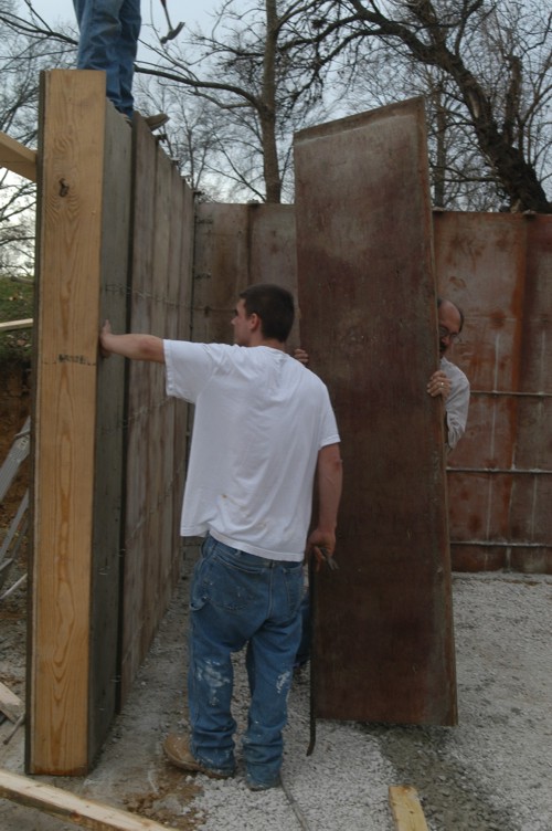

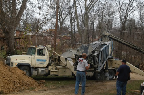

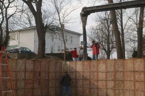

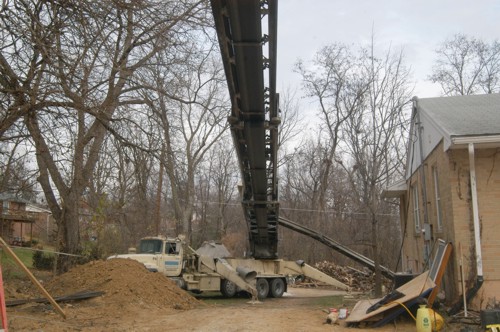

well today we poured our walls about 66 ft 8 ft tall 8 inch wide. The truck came from about 100 miles away. This was the only choice we had could not get to back of the property to pour the normal way from the mixer. We had to drop the eletric line for clearance. wall the belt for the cement truck up the street becasue he need a 60' wide open spot to turn the boom. took two hours total to set up and tear down and only 30 minutes or less to pour. it sure worked slick.
Tomorrow tear down and paint the wall and hope to pour the floor thurs. or fri. wish me luck
Roger
