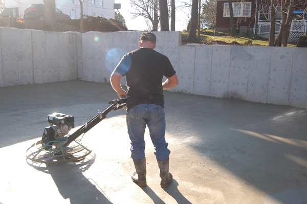

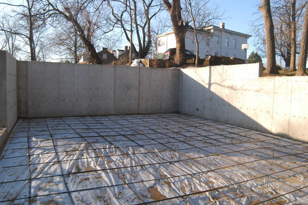

oh one more thing I left out. I am pouring 5 inchs and deeper around the edge up to 7 inches. Pluse around here they use 5 and 5 1/2 bag mix. I am using 6. Pllus around here last week we were down to 10 degress at night and 30 during the day. Over the next few days we are going to be 50 and 30 at night. So we are adding 1 percent calcium.
Any thoughts.
Roger (is it morning yet, where are the cement trucks?)
   / Step by step photos of new garage
#52

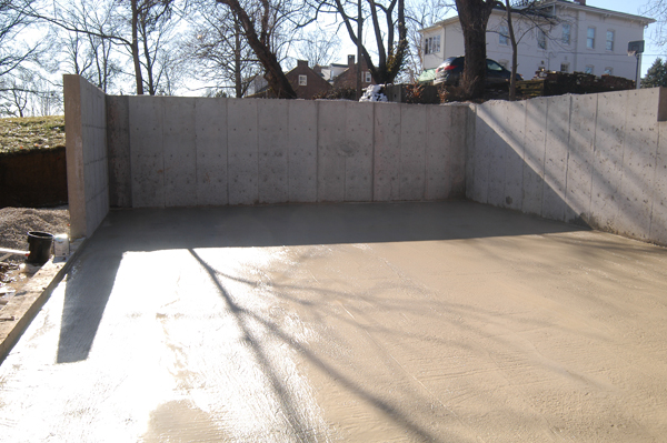

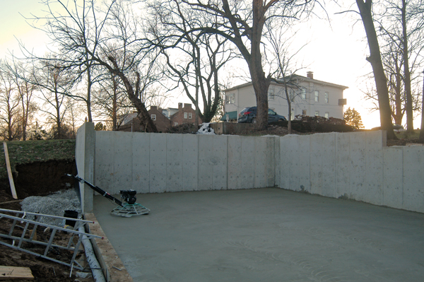

Well at 9:00 the 1st truck pulled in and could not make it up the side yard that had 3 inches of rain, then 14 inch of snow on it last week. We took my tractor and dumped gravel on the ruts. Then 30 minutes later the 2nd truck showed up, that drive went right in with little trouble. The 1st driver did not hit the gas enough to get it moving. All in all we dumped 15 yards of 6 bag mix with 1 percent cal in it. This proved to be a mistake for it hit 60 today so the set up was fast.
Hope you enjoy the pictures. Now the brother in law is done and my job begains with the framing. I am puting in 26 ft trustees and two foot over hang on each side. 5/12 pitch. Load of 30pd per sq.ft.

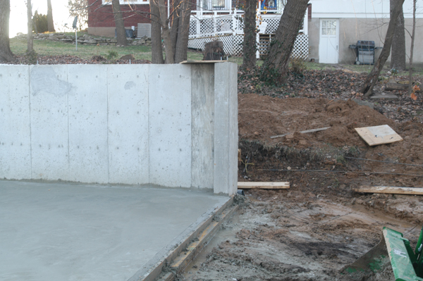

Now I need some help on what to do with the drain tub. On the left side of the garage (pic 6 t drain 1) the drain tub is resting on the foot note just 1/2 below the door cut out. A pad will have to be poured infront of the door. I do not think a 1/2 inch of concrete would be enough to cover this so it could run on down beside the house. So my question is this. Can a person block or cap one end of the drain tube on up the line and ther by force the water on the other sdie of the garage where it could be managed better (see pic 7t drain. or should I make a right turn with the tub and take it down the middle of the yard in a trench.
The other pic are just general photos of the work.
Its a good thing I do not do this for a living, I would have to fire myself.
Thanks for your help and input.
Roger

I'm a little confused on your solution for the drain tube. From what I understand, it has to go past an area that you can only pour a very thin layer of concrete over it.
Two options that I can think of right now are to cut the plastic drain line and splice in a metal one for the area that you pour the concrete. The metal wont flex and should hold the thin concrete without cracking too bad. Maybe put expansion joints on either side of the pipe just to control it, and if it gets bad over the years, it will be a fairly easy job to remove and repour with something stronger.
Option two is to buy an open drain with a grate over it.

As far as the drain tube: I have it laid on the footing on all three sides. But the east sid has a hill that fall to level ground about half way down the wall, so the promblem is where to end the drain tube. in the hill with a cap, or do I bring it to the front of the garage? The troulbe with that is it is almost ground level and in front is the drive way. Along side of it is the patio and my walk out door. I might try and draw it out. I am hoping I can cap it and there by force any waer to the other end.
