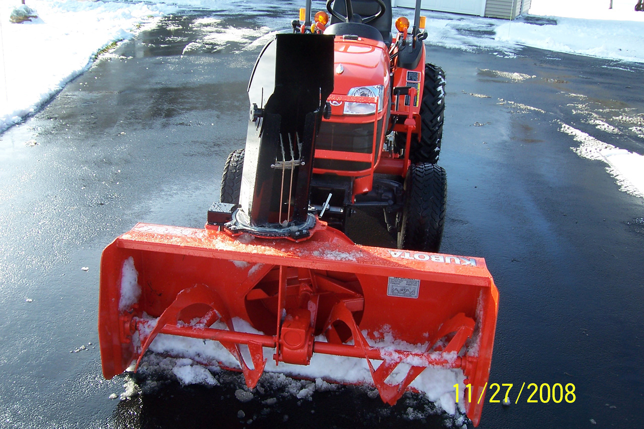

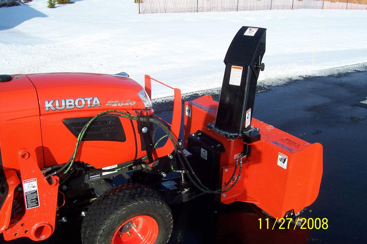

He walks, he talks, he crawls on his belly like a reptile! Hi there Dyer retired....... not true I heard. Congratulations on the ugrade! That will be a great tractor for you. Are you getting chains......... what tires? Here's a picture for you to have a coffee over. ( I take no credit for the photos since they were contributed by another member, and I saved them for the same reason)

Look at Chuck's first picture. Mine is exaclty the same arrangement
I found another post with a Char-lynn J-2 series motor mounted like Chuck's and pictures of yours I've looked at. The other post shows a cog mounted on the top of the motor and directly connected to the chute base. I think I've got the correct part numbers for that and it looks like the J-2 motor mounts directly to the plate that the worm gear gets removed from. The worm gear, as it is attached now, appears to be mounted at an angle to accomodate a hand crank and that would make it a touch more difficult to mount a motor with half couplings between (as I did on my 2750), but I think I'll be able to rig something without too much trouble. Thanks, John

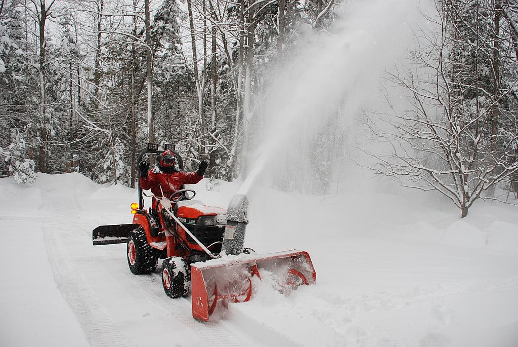

Thanks! I don't drink, but I have a hooded snowmobile suit, ski goggles, and snowmobile mask that covers most of my face....almost like being in a cocoon, ha! Cab still sounds like a lot more fun!
