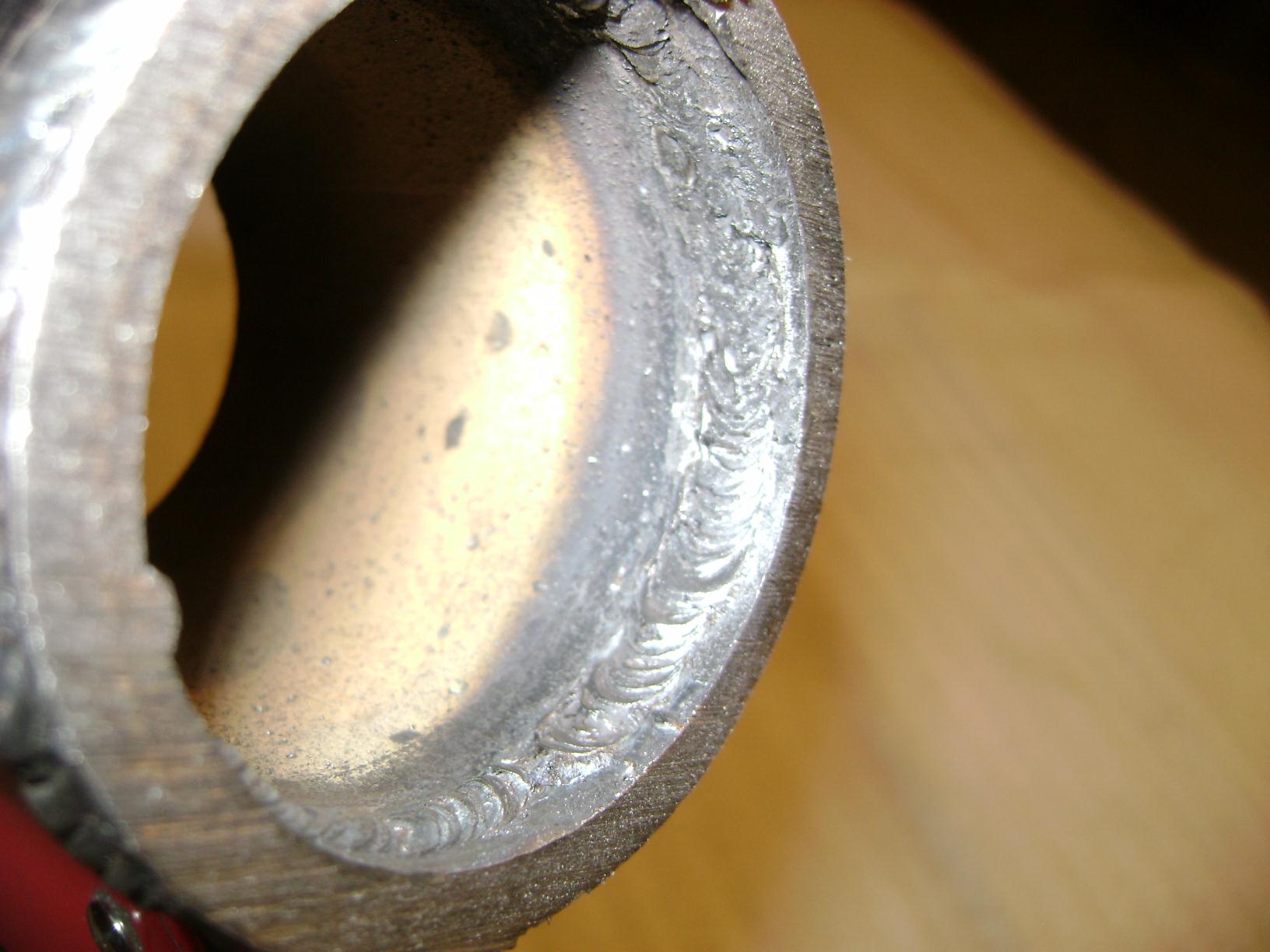

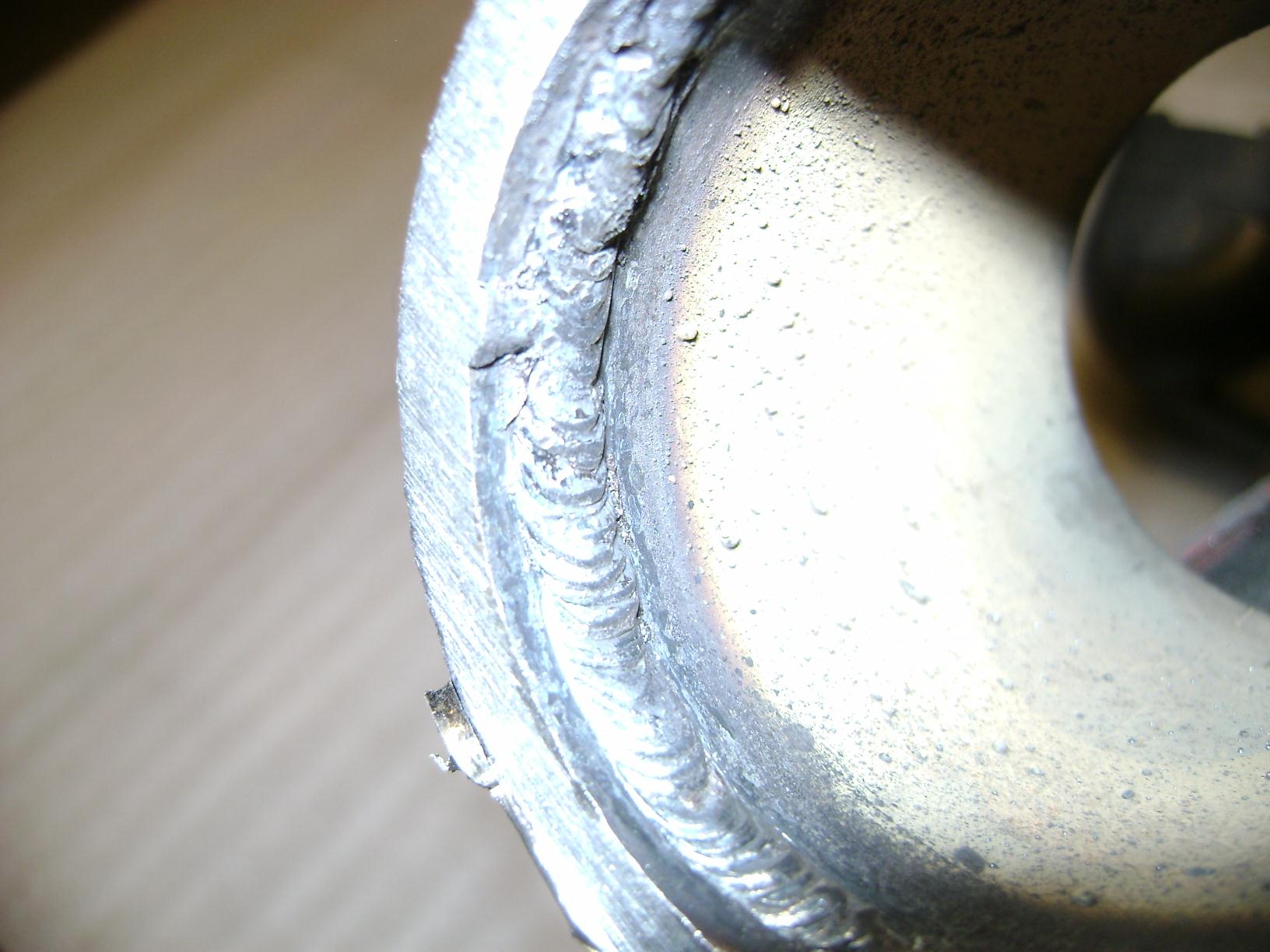

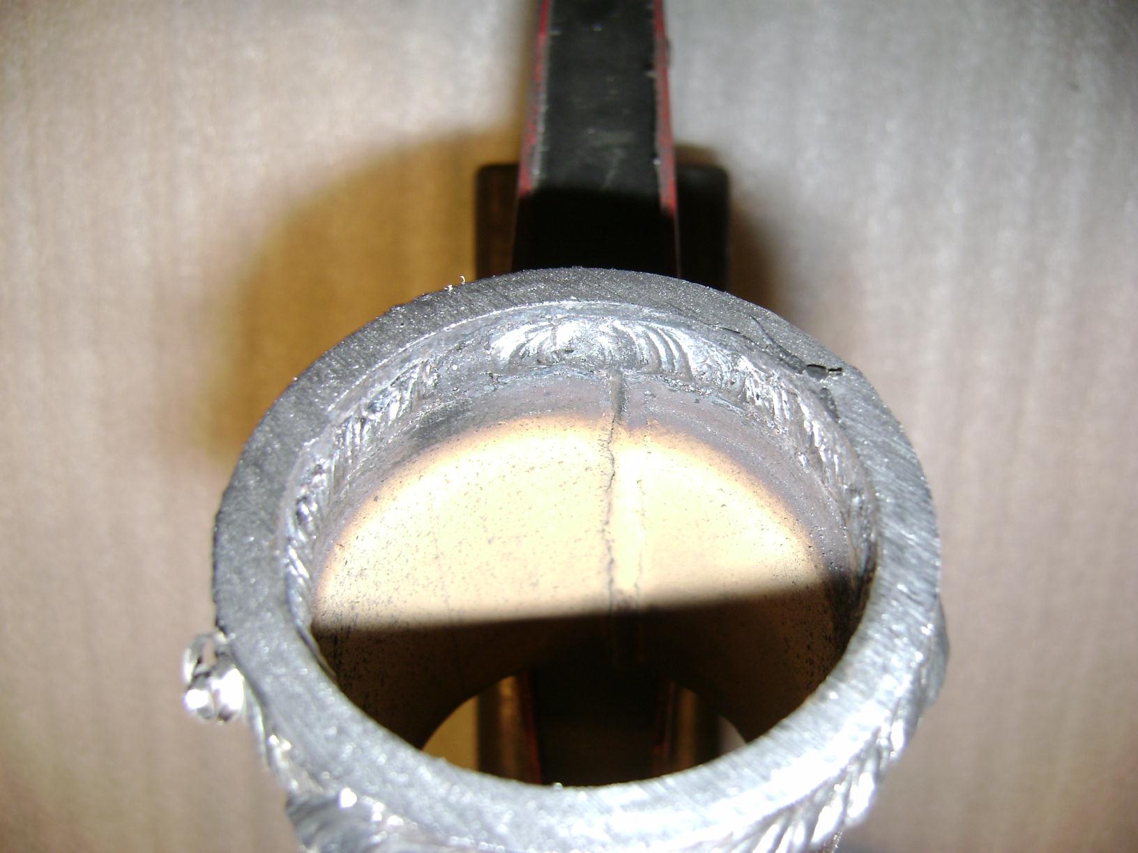

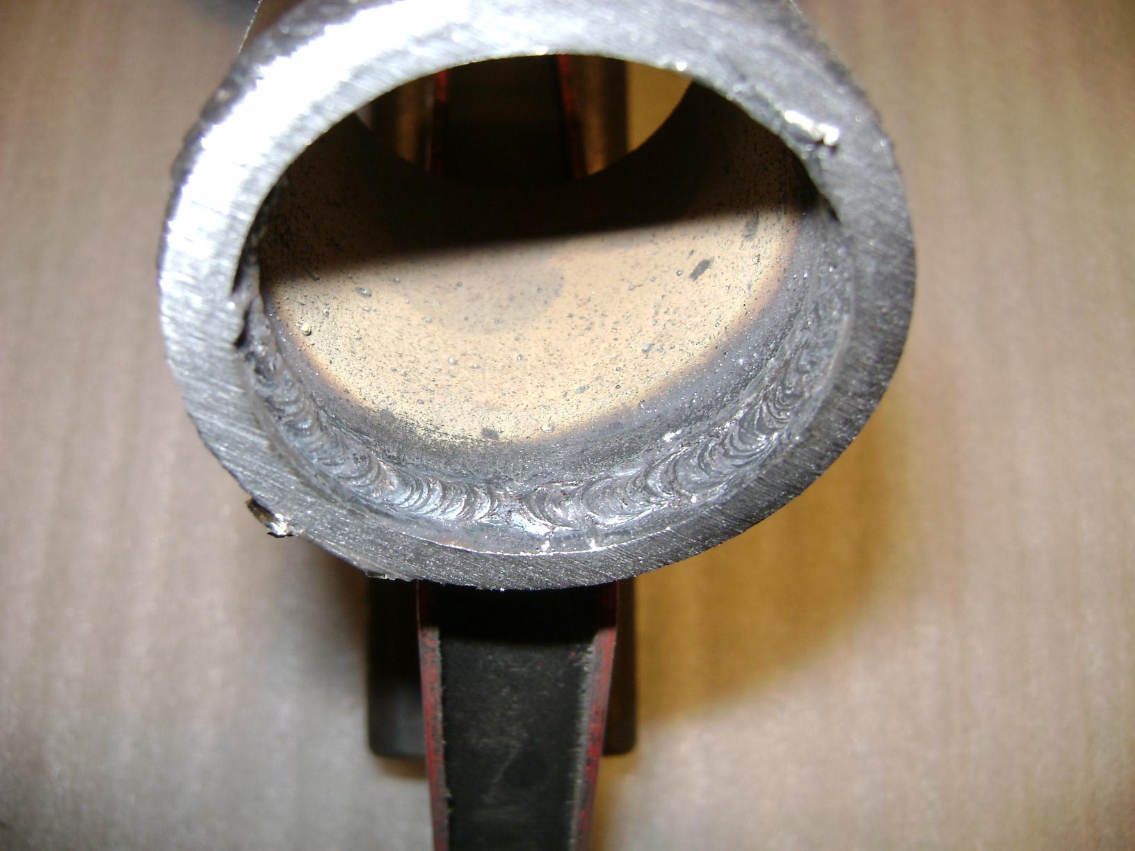

SA, are you using a band saw to prepare your bevels?
Yeah, because I'm lazy!:laughing:
That's just about how mine looked with 6013
Wow that's great! I don't have a lot of luck with 6013. Just soon avoid it!:confused2:
Have you tried any open root pipe yet?

I haven't. I don't have a lot of pipe to work with so I might just have to go to a supplier and get some to work with.
