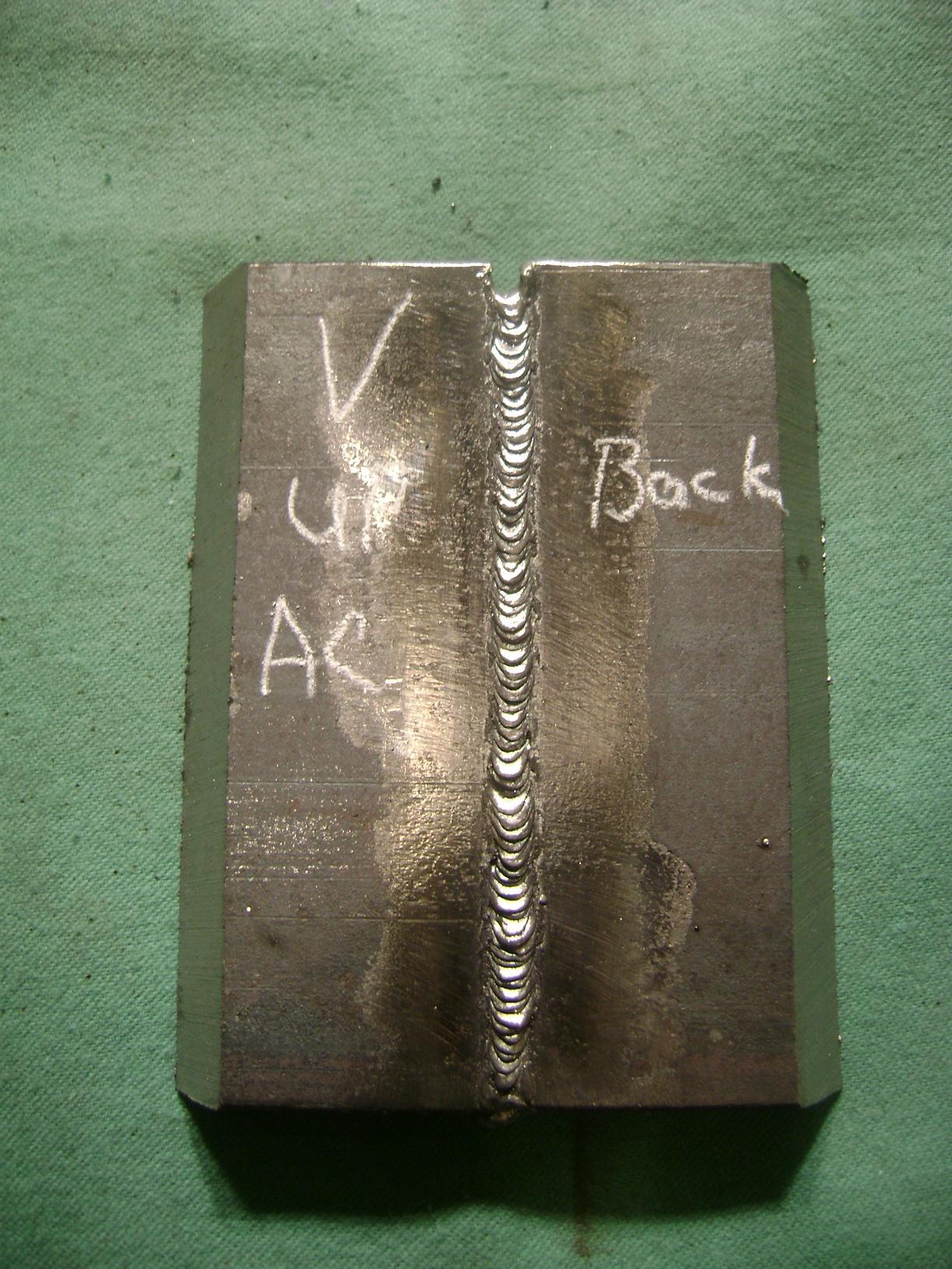

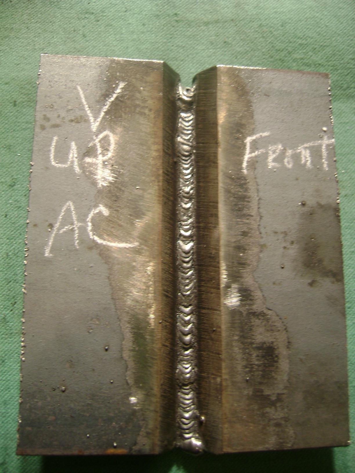

Until joining this site and another tractor site I never thought about welding SMAW on AC, so here again curiosity got the better of me. I didn't notice much difference, but the sound. Now the sound when I first started really set me back, I almost stopped, thought something was wrong with the machine!:laughing:
Here is a vertical open root plate I did with 6011 on AC.

Shield Arc said:
Until joining this site and another tractor site I never thought about welding SMAW on AC, so here again curiosity got the better of me. I didn't notice much difference, but the sound. Now the sound when I first started really set me backhttp://imageshack.us/photo/my-images/268/shockd.gif/, I almost stopped, thought something was wrong with the machine!:laughing:
That's just about how mine looked with 6013
