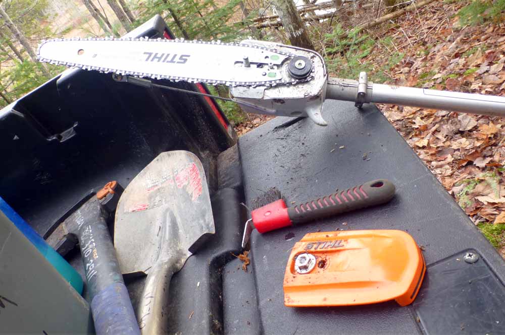

The saw head has been good so far. With its mini sized chain, all the tolerances in the chain case are tight. I thought the chain cover might get plugged more often, but i can't yet say that's the case so far. The single nut on the case is attached so you can't loose it. Echo uses 2 simple nuts, so we have lost them in the field. The chain tension is easy to adjust and designed pretty much the same as there regular saws.
Jstpssng, Can't say we've had the chain pinched in a branch yet but that does happen to us now and then. We've only ran about 1 gallon of fuel through this machine so far. We have had it pinched in ground logs but no ill effects. I can't say the chain gets dull quicker or not, but it does need to be touched up with a file over the course of the day. Our type of work is hard on chains, so that is normal for our chains. I will complain about finding these super small, 1/8th files for sharpening it.. So far, the only supply we can locale for them is Sthil! The chain seems to stay on the bar fine.
The 1/4 turn oil cap has worked fine so far. So as of today, the saw head is a keeper. More review to come later......

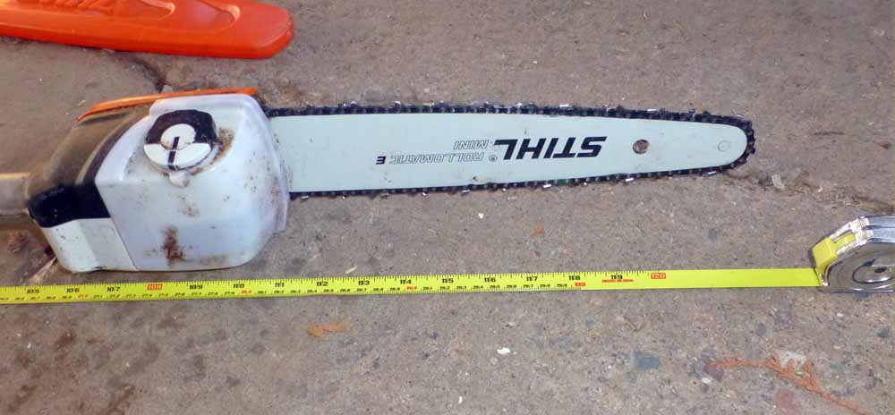

Does anyone know the total length of the Kombi pole saw with the extension? I have a cheap Poulan pole saw that is on its last leg. Every time I’m at the Stihl dealer for oil and what not I look at the Stihl pole saws. I have been considering the extendable pole saw which Stihl’s website says has a reach of 11.5’. The website only lists the length of the extension pole for the Kombi extension and not the power head or pole saw attachment.
Buck, Give me a few hours and I'll measure the length for you. Many folks get the telescoping type pole saw and later discover, its toooooooo heavy to work with.
   / Stihl KM 131R kombi review
#17

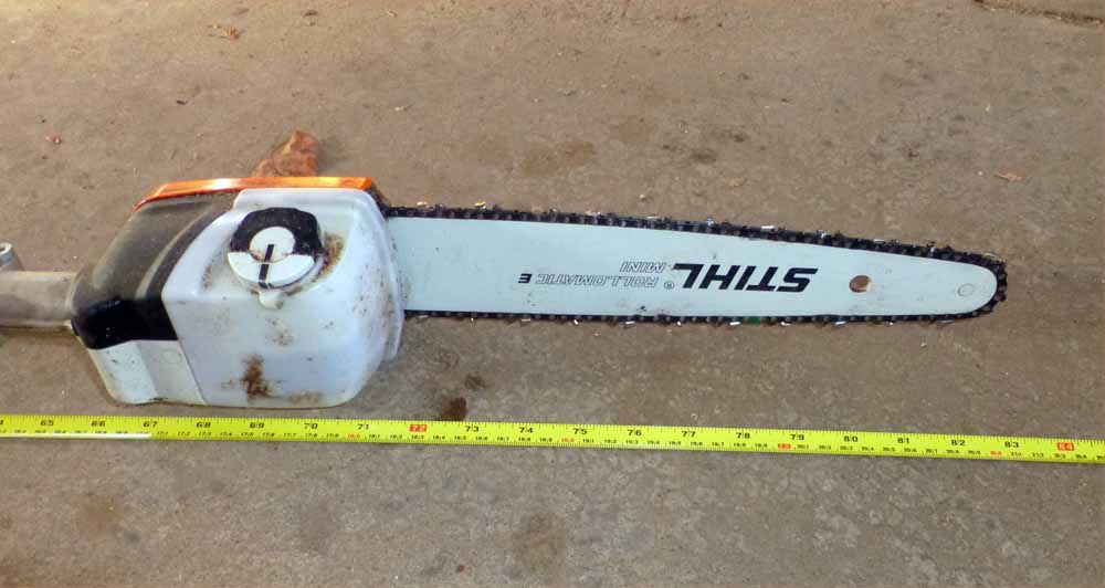

Here is the length of the unit with pole saw. 1st with just the saw end, then with the extendo added. My little tape is just 10ft.

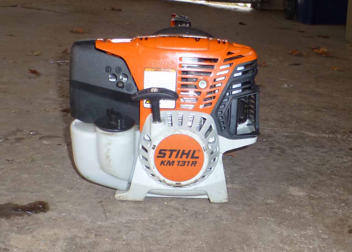

The Echo power heads we've used for many, many years are rather round in shape. That is, when you set them on the ground, they readily roll over. When we file chains or do any servicing to the power units, they tend to roll over. Sthil put a wide base on theirs which is much, much better at keeping the power heads upright. You wouldn't believe how much nicer this is work with over the course of the day.
Thank you! It appears from what is available on Stihl’s website the extendable pole saw would be about 2 pounds heavier than the Kombi with the extension.
