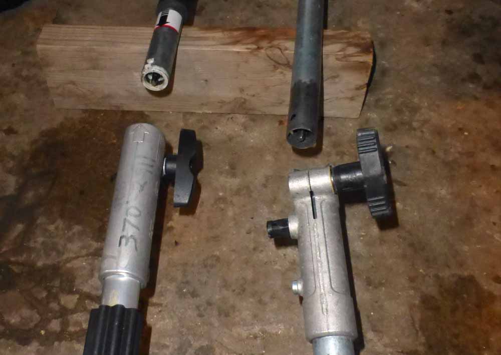

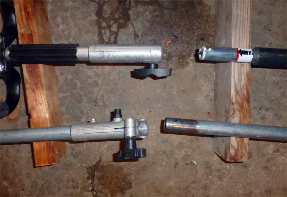

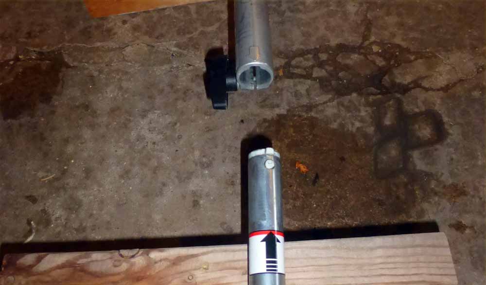

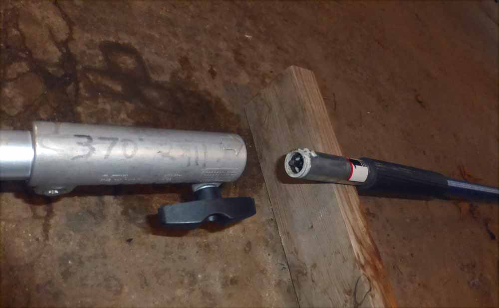

Here is some comparison photos of Echo and Stihl attachment systems. The Echo uses the spring lock pin where as Sthil does not. They do use a plastic key to keep it from being spun. What you can't see is Echo clamp is designed so you can't tightened the clamp down to the attachments tube, snug yes, but really clamp tight, no. But on the Stihl, you can tighten it and keep your tool from wiggling around.
The Echo locking pin is not glove friendly and is difficult to find the locking hole in the attachment's shaft. Plus the drive shaft/coupler end does not like to slide into each another. The large T nut will unscrew while in transport so they need to it snug or or you'll loose it! (been there, done that!) As stated above, the power head side clamp will not hold the attachment shaft tight.
Stihl doesn't use a locking pin but does have the key which is quite easy to locate and slide in. Its T nut will not unscrew since the thread has a stop built into it. The attachment clamps down tight and make the attachment rigid tool.
Stihl's attachment system is faaaaar better of a design than Echo's, and much easier to use.
