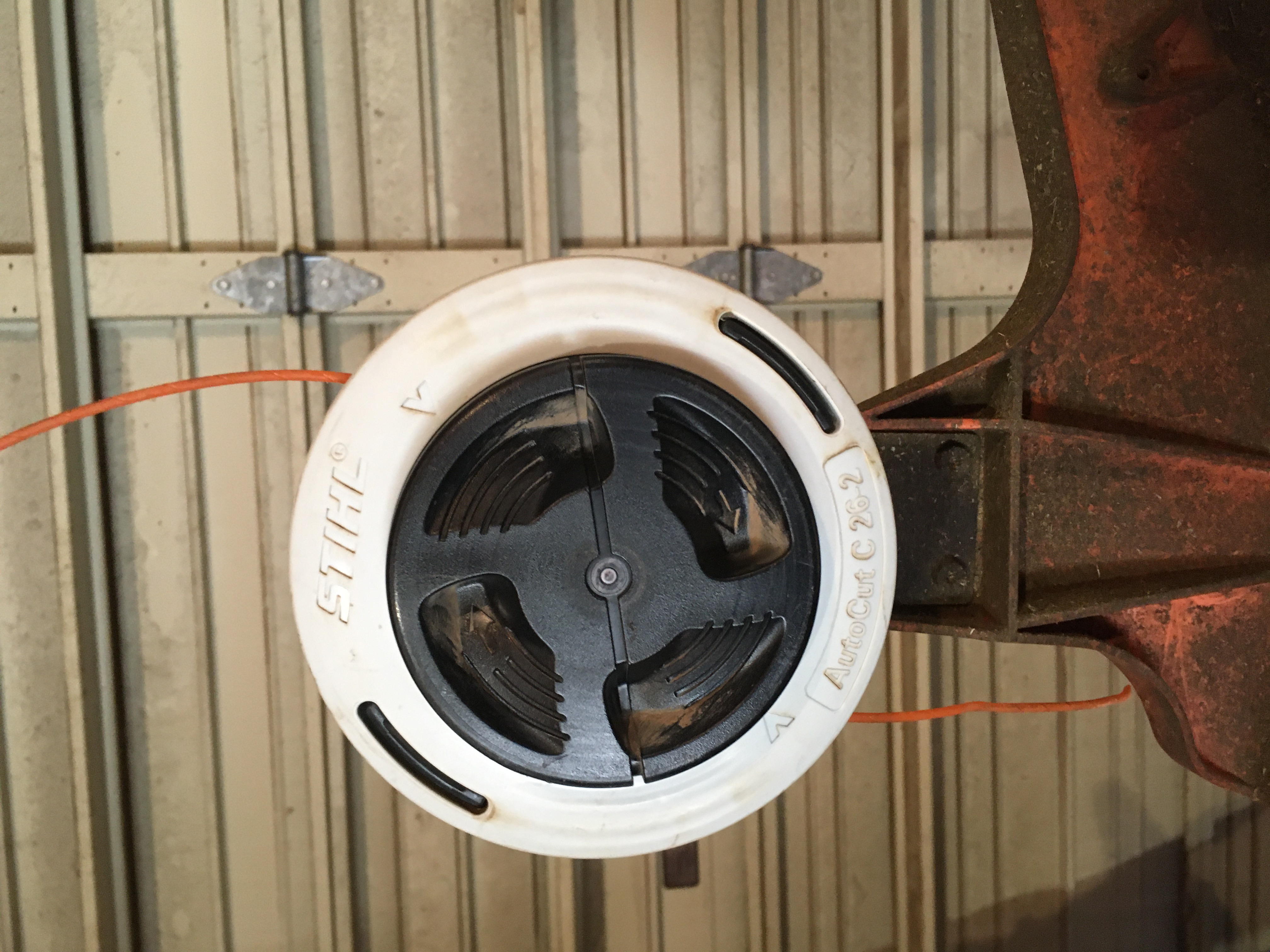

I just changed over to this newer trimmer head that is much easier to load. It has .095 on it now but will take .105.
So far very pleased.
So far very pleased. View attachment 676682
You do understand that we are using string nearly twice this size?? We've used .155 for years with great success but now we are trying to swtich up to .180. Smaller just doesn't cut it.
