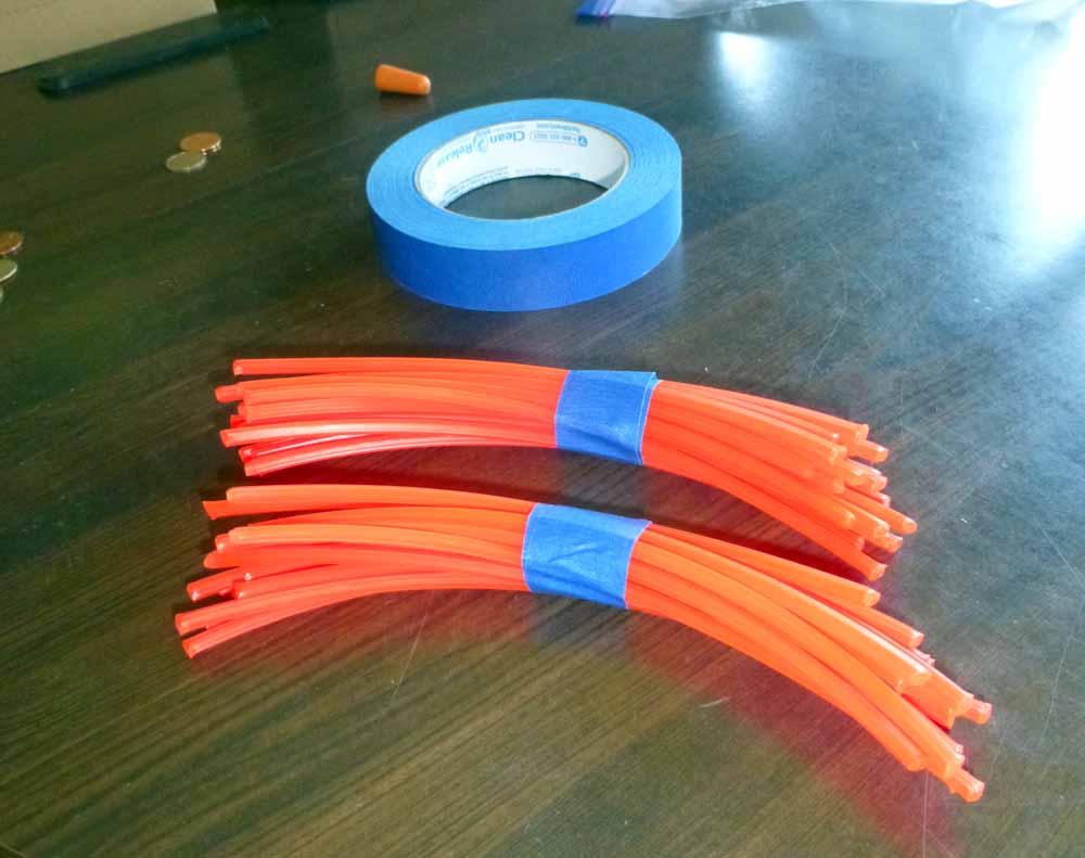

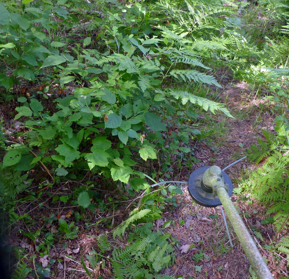

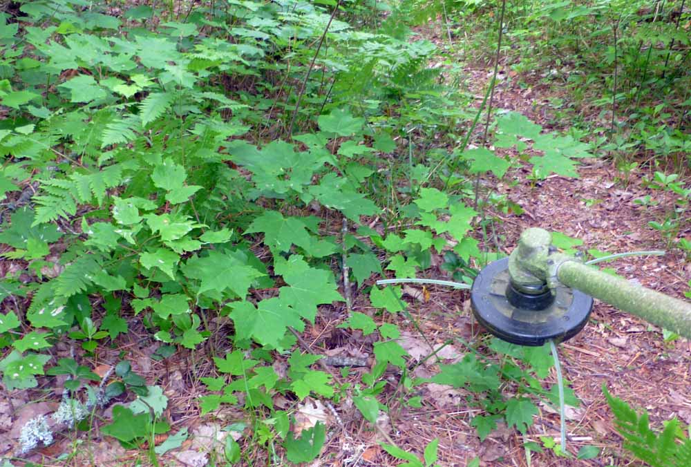

All the major company's are selling these cam-lock string heads today. Below is one of ours. We buy string on reels in bulk and cut it, then tape them together as seen in a photo to be carried into the field. The string cost us pennies per string and I can change out all three, in less than a minute. We also run these heads right against the ground, and it makes no difference to them. Some of the photos shows the maple shoots we need to cut. No, its not a good photo of the shoot we cut.
We've given up on steel blades because there cutting radius is so small and the rocks we work among.
Thanks for those pics! I had a head similar to that, may have been the same. It used the black .130 line. Really liked it until it got to where the cams would not “lock” and hold the line in. Stihl changed the design.
When I was using that head I basically did the same thing, cut the line into strips and kept them in my pocket.

The string heads I shown here might be made by Oregon, then sold under various names. They do get gummed up and not hold string very well. But they also can be cleaned via running paint thinner through them, then blown out with air. This must be done now and them, but nonetheless, they also simply ware out. Sthil cam-lock heads we have not used before and they do function differently..

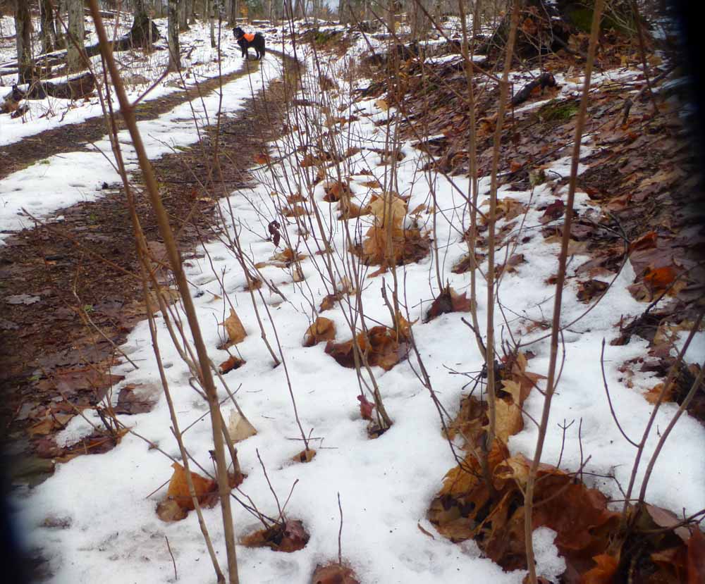

Here is a better photo of the maple shoots we need to cut off. Among the larger ones seen here, the .155 string we've used for years couldn't quite cut so we are hopeful, that the .180 string can. Time will tell! As stated earlier, if you beat the stem up enough, they are effectively dead anyway, but your trail doesn't look as nice as cut.
