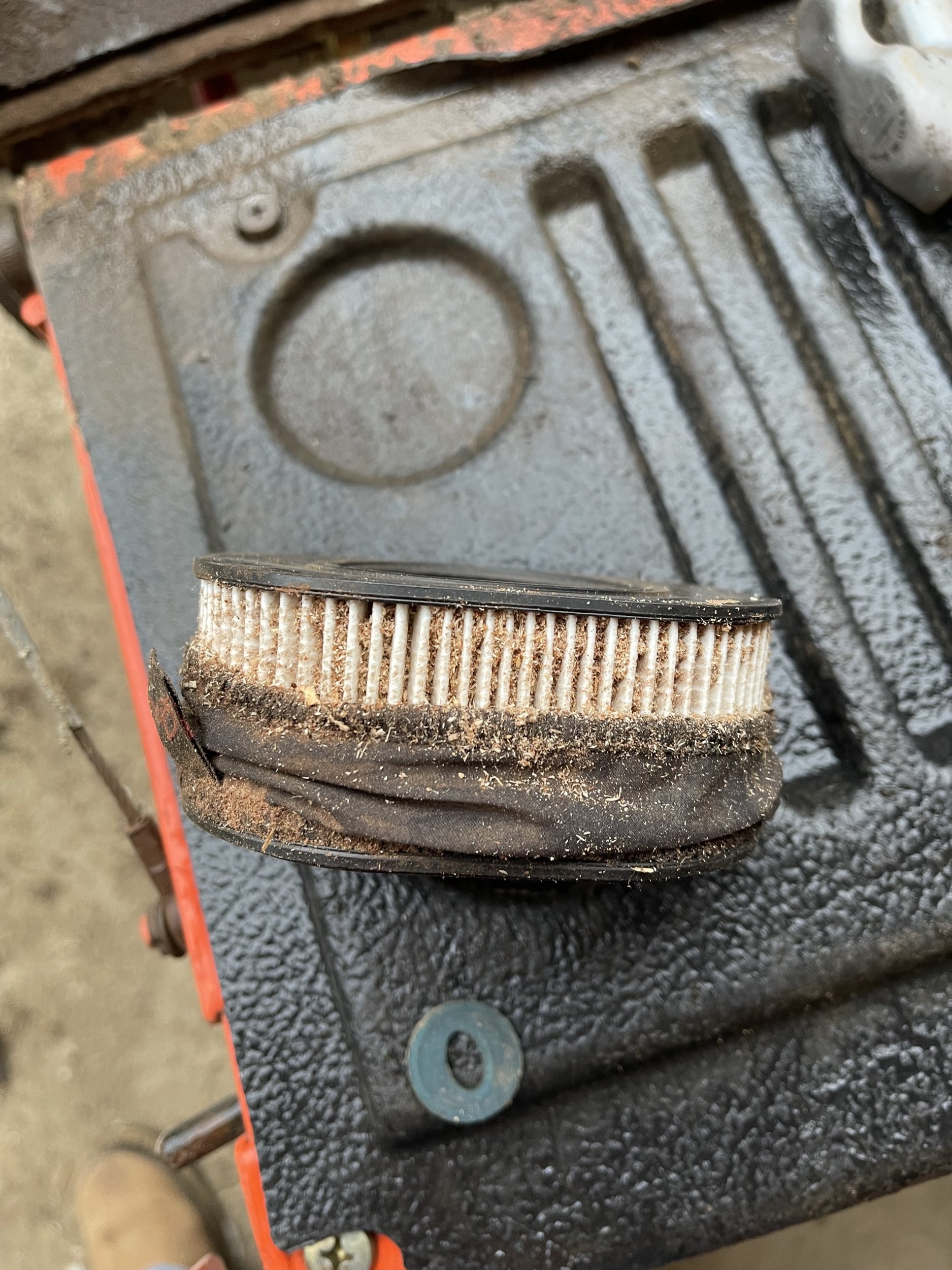

I personally own and run both falling timber the 462 reminds me a lot of the first generation Husqvarna 562’s that run good with up to 28’s sometimes 32’s. That 500 is completely different animal in that if you don’t have a long enough bar with an aggressive enough chain on it, it’ll four stroke in the cut. Some complaints about it are the suspension on it was too soft for the 36 I normally run on it all the time and the air filter sucks on the 500.View attachment 822273View attachment 822274air cleaner after a few trees without the outerwear it’s plugged up with bark, it’s not uncommon for falling saw here to have some fine run through it.
Jason's filter set up can be used with stock covers. UNI and oiled. Air Filter Kit (Stihl 500 & 661)
