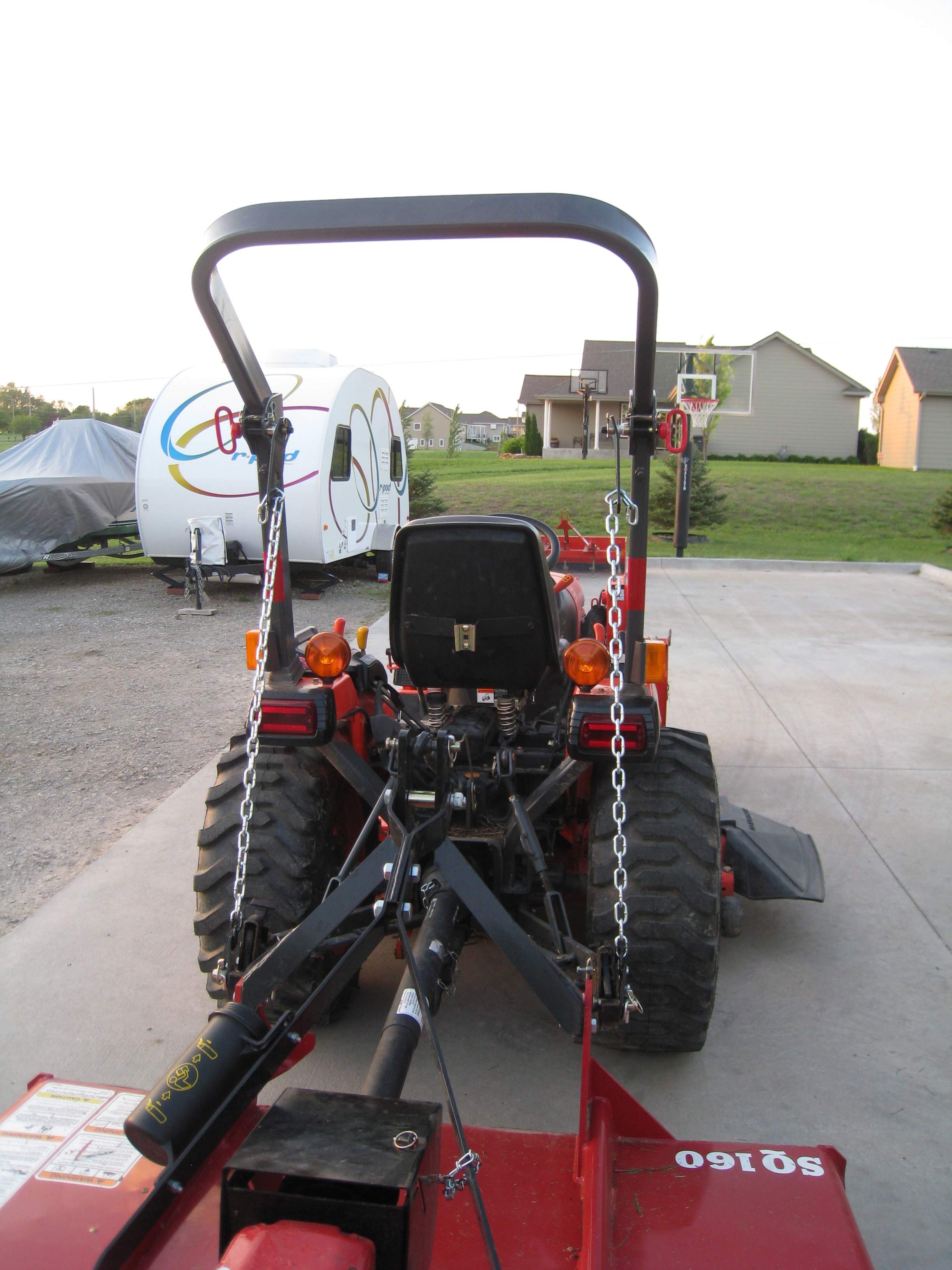

Well I am new at all this (obviously) and have never owned a tractor, just driven one. That's why i am trying to learn as much as I can before purchase.......It sounds like w/ a mmm, the added maintenance plus costs might outway the benefits versus a RFM (or is there just as much maintenance w/ rfm?).....guess thats why so many use a RFM over a MMM, or is it that alot of tractors don't have the mid pto?? (I thought it was the latter) Also, I have read about rigging up a chain to prevent bush hog from dropping on 1/4 valve......if thats what i end up with, how effective is this and how hard to rig up?

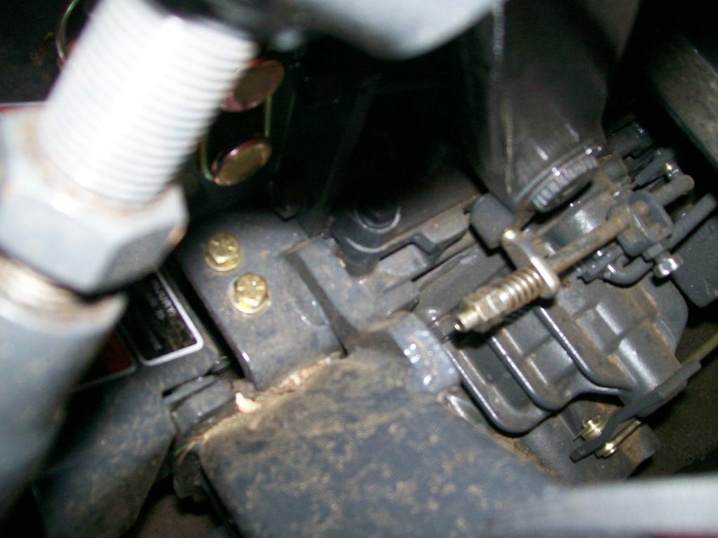

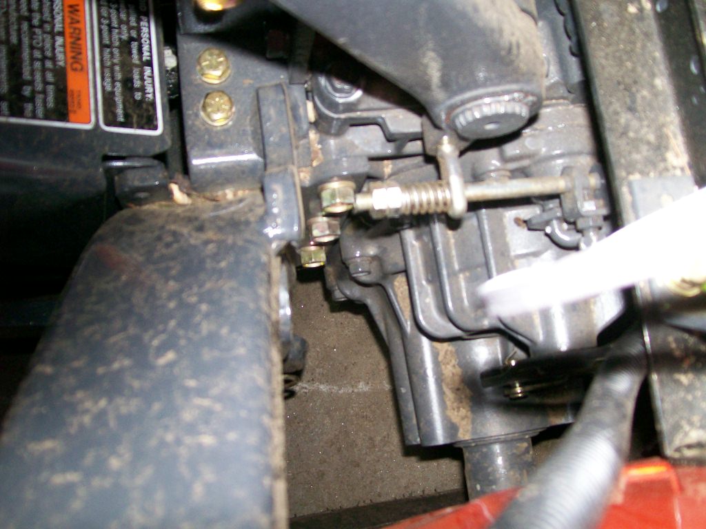

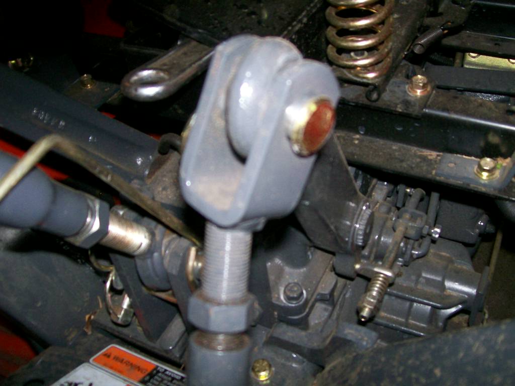

There is a down travel limit that can be adjusted on Kubota tractors with 1//4 inching. To start with, I would get the cutter a bit higher than you want it, and set the stop since they do tend to go a bit lower in use. Here are some pictures of the stop set up.

Thanks Chuck....if it as simple as that why do people make such a big deal about having to keep "bumping it up"?
