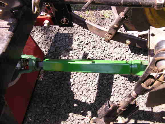

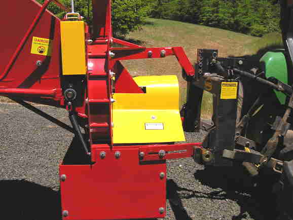

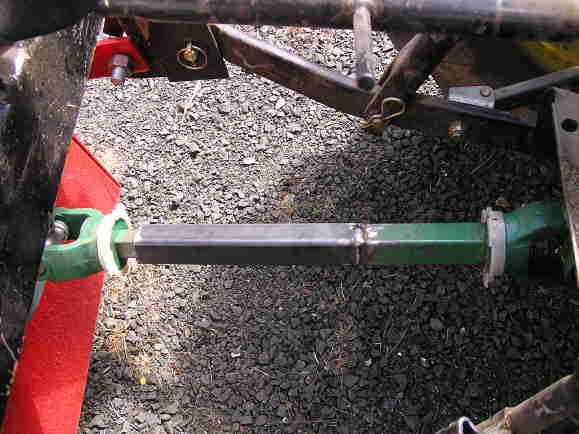

Someone asked for photos of mods. Here is what I did to adapt my chipper to my Speeco quick hitch.
The upper and lower mounts for the 3 point had to be lengthened and so did the PTO shaft. The PTO shaft is now double walled and because of that the plastic safety cover could not be reinstalled. I felt if I was smart enough to not put my hand through the chipper I was smart enough not to get around a spinning PTO shaft.
On our first use of the chipper I shot the chips directly into the truck bed, which was a mistake. I ended up with little specks of tree sap all over the truck, what a mess!
