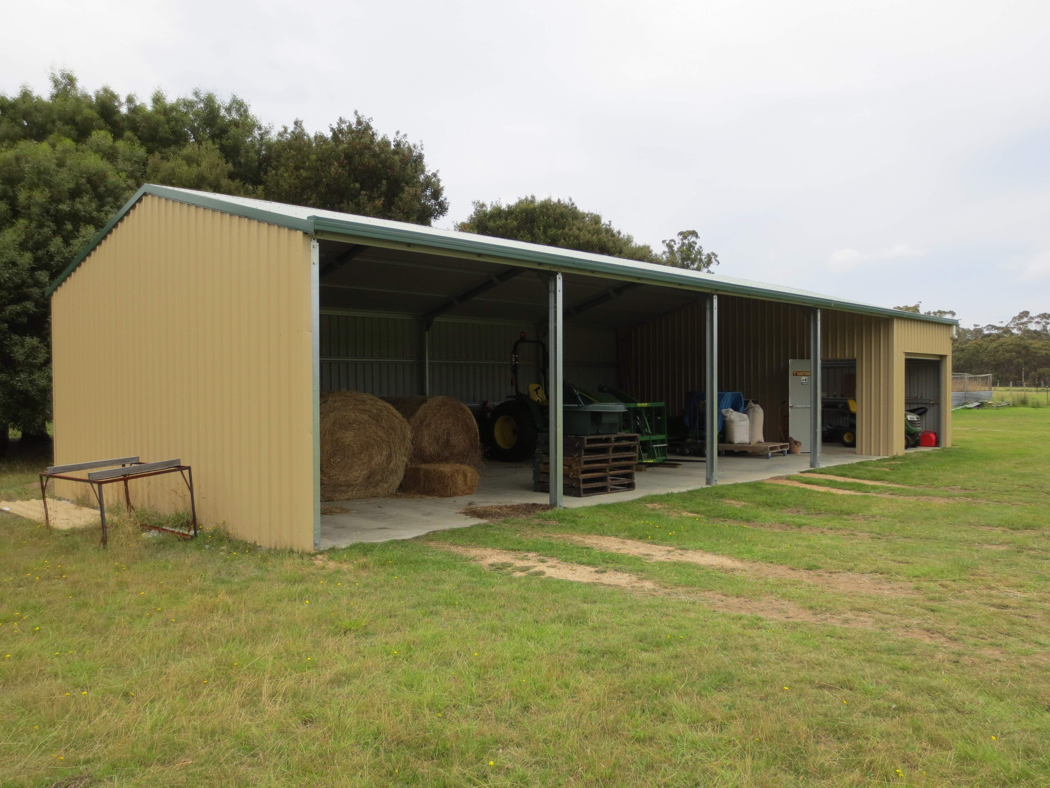

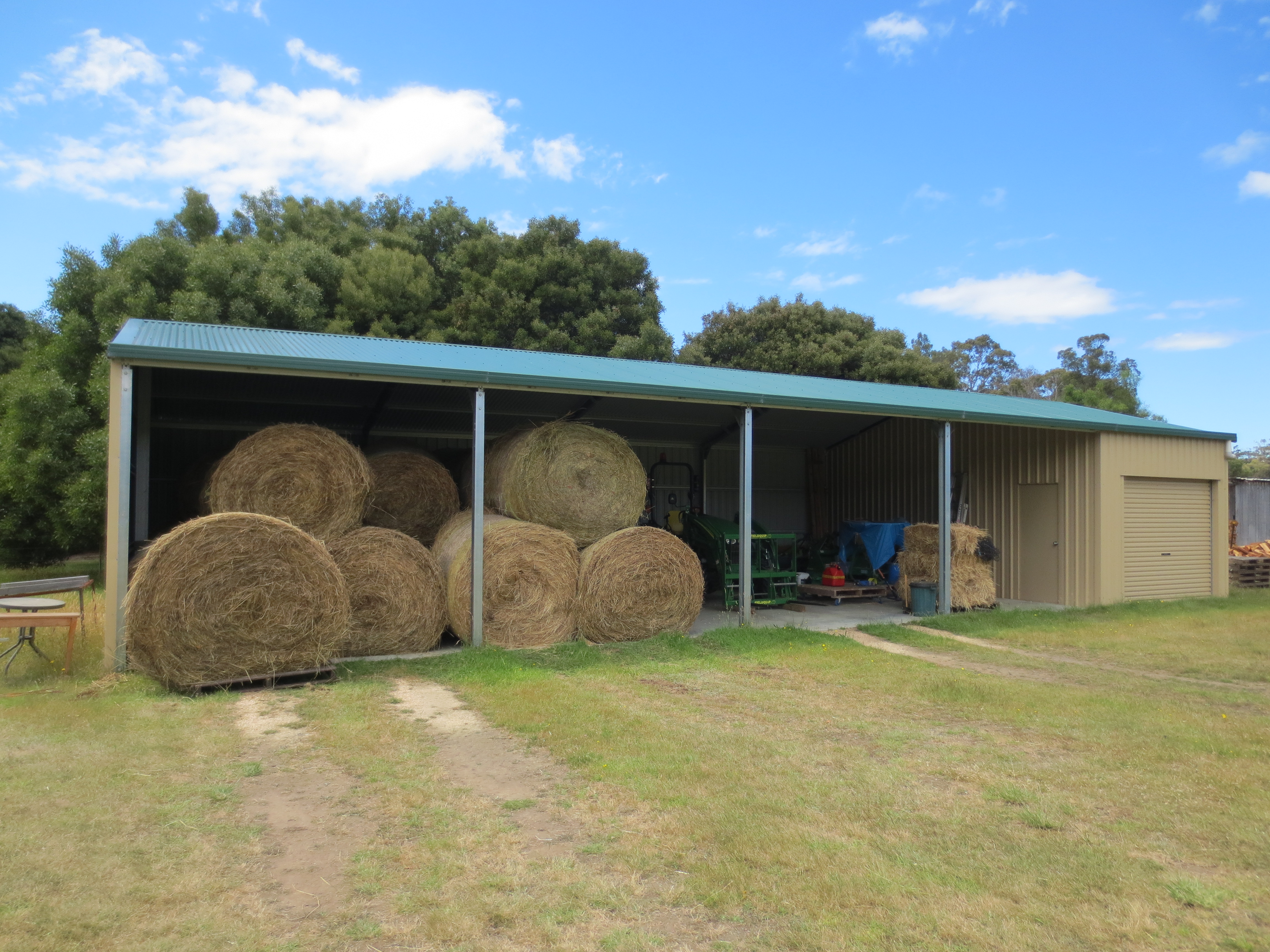

The tractor(s) and all implements are stored in my 5-bay shed (exception is the ballast roller). With a concrete floor, the implements are all on wheeled pallets for storing them away in a group and for ease of rolling them into position for changing around.
My shed faces South (Southern hemisphere) to keep everything out of the sun.

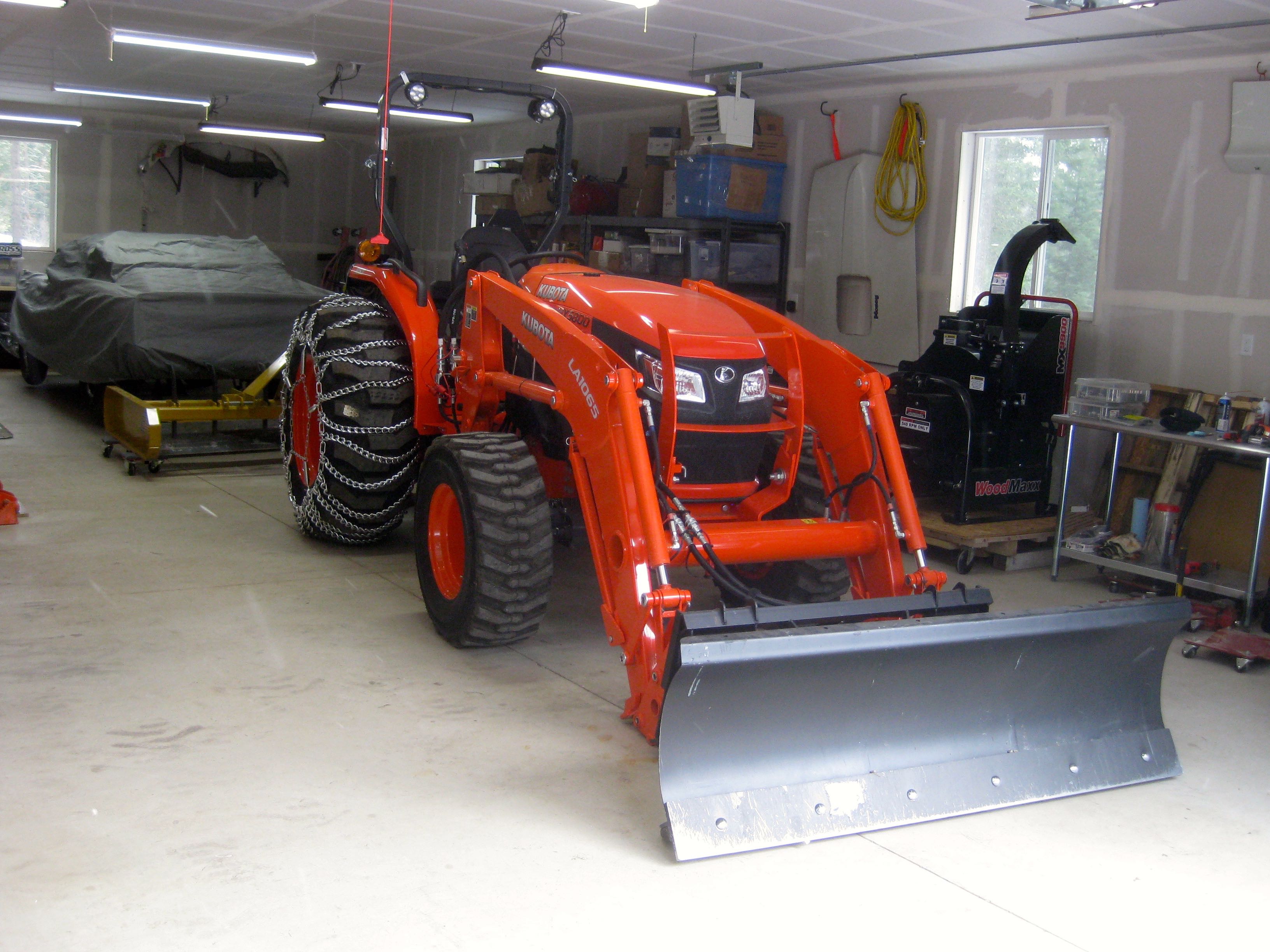

My tractor was in the heated garage last winter, and will be crammed in there again this winter. But with any luck, next summer will build a 32 x 40 or so metal quansi-hut type storage garage and that will be its new home. That's the dream anyway.

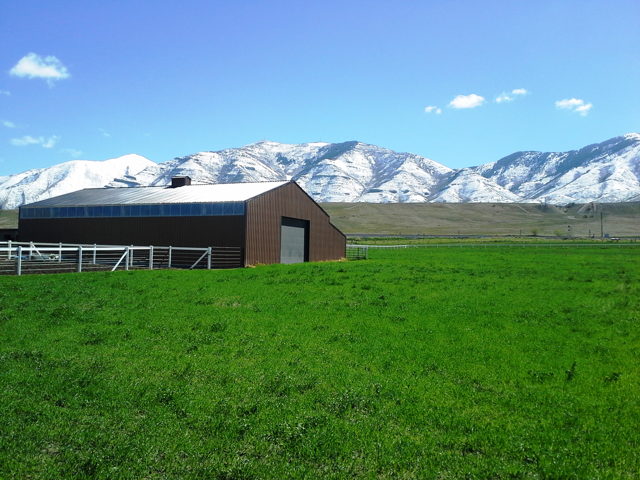

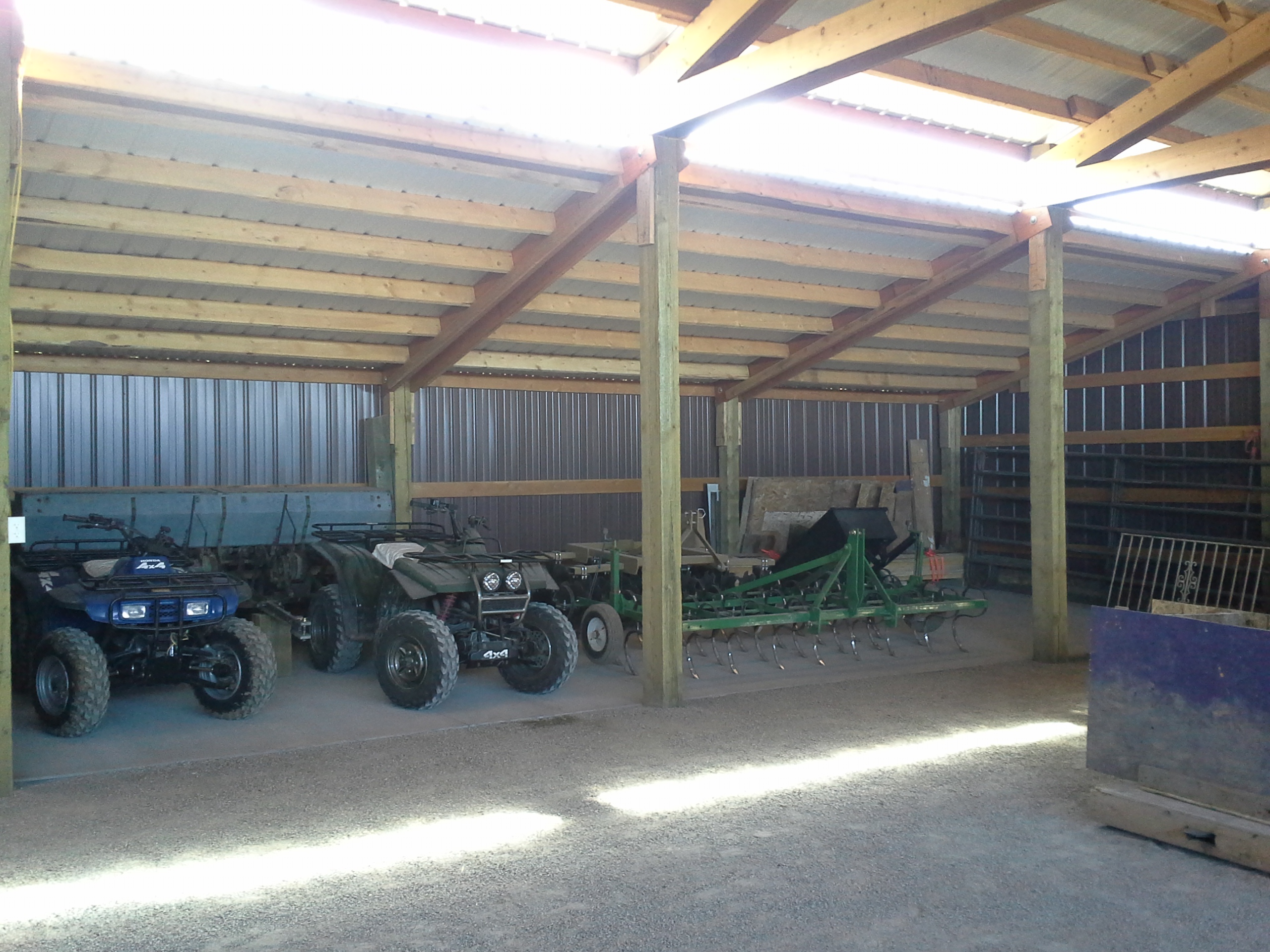

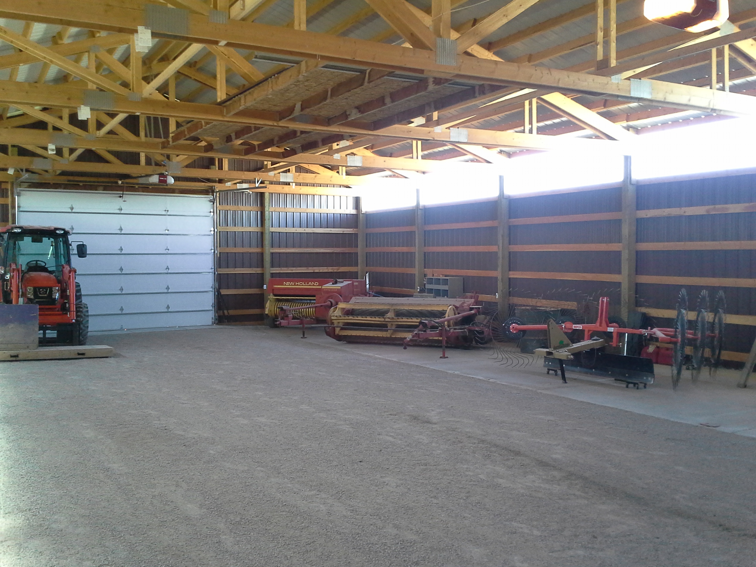

I store all my equipment in the barn.
The hay is in a different barn.
View attachment 516460View attachment 516463View attachment 516462View attachment 516461
Lynn, every time I see pics of your property, I get jealous. Just beautiful.
It looks like you have a combination of concrete and gravel in your equipment storage area. Correct? Is the gravel crusher run? I am going to put gravel in a dirt floor pole barn I use for equipment storage. I have debated in my mind about whether to use crusher run or maybe 3/4 clean gravel. I am thinking that if i use crusher run and wet it down a few times, it will pack nicely and work well. Any suggestions by you or others would be welcomed.
   / Storing tractor and implements outside or under a roof? #15
I would recommend against crusher run for inside use. I had it in my pole barn for a couple years. It was a dust storm every time I started something up. Fan would blow the dry dust around and make a mess of everything. Use washed gravel or, ideally, concrete.
