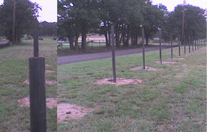

I couldn't find the old threas so heres a new one.
I got 1000 feet of fence i'm putting in and here is about 400 feet on one side.
My camera phone is pretty crappy so the pic doesn't do it justice.

Tom, I've never been able to get pictures that good with my camera phone, and I'm not all sure I could fence posts set that straight. Just what method did you use to keep them straight? A string, just line of sight, or what?
Bird,

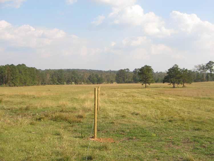

On my place for cattle fencing, I just set the corner/end posts and run the first wire from corner/end to corner/end and use that first wire as my "string".
Works for me and the cows don't mind if it is slightly off. Here is about a 1000 foot run I'm working on right now and you can see the first wire and the line of posts can't be seen very far because they are directly in line.

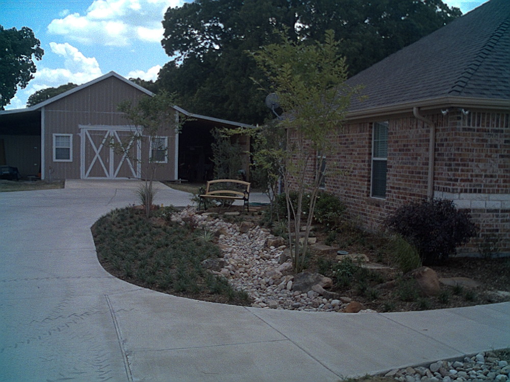

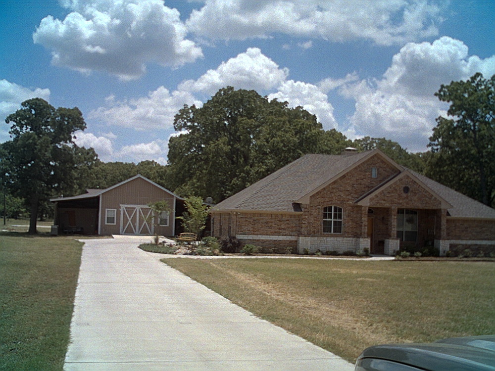

I'm putting the top rail on now and all this pretty work goes to pot. Thats because I'm putting up the woven wire and there is a lot of contour to follow. No matter how I try to gradually follow the grade it still looks hilly especially before the wire fence is on.
For this Guy I've already done his front and side landscape and irrigation that was last year.
This year I did his outdoor kitchen, water fall now the fence.
Left to go is Gate/operator, Landscape around the new pool landscape and irrigation. I like ole' craig.
