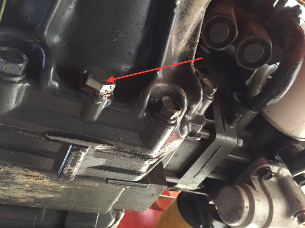

About 2 months ago I drained and attempted to replace my hydrostatic fluid and filters on my Kubota B2920. I followed my manuals directions of first opening and draining the main plug on the mid PTO then I went to the other plug on the right side of the rear axle. Well that is where the problems began. When I was removing the plug it seemed like it was just spinning but not backing out.... Hm..... After a while it finally came out and but I noticed a bit of a silvery, shininess to the threads.. I didn't have my reading glasses on and thought nothing of it until I went to reinstall the plug. It won't start in the drain plug? After many failed attempts without my glasses, I went and got them to get a better look.
Well that silvery shininess on the threads were the threads pulled out with the drain plug!!!! OH CHAUTAUQUA!!!! The plug won't start because there were no threads for it to start in on! At this point I realized that the repair was going to require removing my loaded tire (which I've done but its a PITA doing it alone!), and retapping the housing with a new plug (which I've never done). Additionally the tractor was in my driveway at the time and we were forecast for another week of rain again!
Not wanting to screw around with this in the rain I called my local Kubota dealer and asked them if they'd be able to get this fixed for me. The dealer is really a good guy, he's my wife's old neighbor and picked it up the next morning, 2 days later it was back with a new plug and crush washer in it and no leaks. About 2 weeks later it started leaking from the drain plug they "fixed." Thinking it worked it's way loose, I tried tightening it up but it just never felt "snug." If anything it felt like I was about to strip out the repair. The leak was never that much, just a few drops overnight. I put cardboard under it to get a gauge of how much it was leaking and checked the dipstick before using it. But the other day after running it hard dragging logs I found what I consider a significant amount of leakage from the replacement plug (see the picture below).
Any thoughts or suggestions? Thanks in advance for any guidance!

My preference would be to repair it with a Time-Sert or Heli-Coil.
/ Striped out Hydro Drain Plug #3
Use a Dowty Seal or bonded washer, instead of a crush washer.
They'll seal a sump at finger tight!

Get a Heli-Coil or insert that fits the diameter of the existing hole.

Depends on how far the dealer is away from you, how well you 'get on' with them and your future relationship ("good guy, wife's old neighbour") etc.'
The dealer is likely to refer you to the thread being damaged initially and their "lo-cost' repair effort... blah blah.
Plus, I believe the tractor is now oil-less and still at your residence? You may wish to do the work yourself depending on your level of mechanical ability? So...
It's unlikely that you'll need to 'drill' the hole for the thread-insert. The casting is aluminium so it is quite 'soft' for machining purposes.
There is a desire to be able to re-use the standard drain plug size, so the suggestion from 'airbiscuit' is along the right path.
You can thread the exisiting hole with the Tap for the insert by hand. Use an appropriate-sized spanner in the square end of the Tap and work it 1/4 turn at a time. (It's soft aluminium.) Support the end of the Tap with your free hand's thumb to ensure your Tap runs straight-in.
Fill the flutes in the Tap with grease to catch the swarf. Back the Tap out every 1 - 1&1/2 turns to clean off the swarf and re-grease the flutes. (tedious but effective to stop swarf being pushed into the housing you are working on).
The insert is about 6 threads long so this process won't take all day. Rinse a litre of oil through to flush any possible stray swarf that may have carried inside (Unlikely), install plug & Dowty washer and re-fill oil.
The 'tang' of the insert can possibly be left in-situ if the plug won't contact it (Wind it in far enough to clear the end of the plug) or it can be broken off with long-nosed pliers for guaranteed retrieval.
