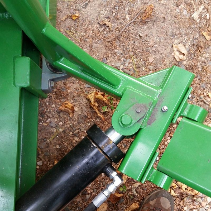

Some more pics now that I'm on my laptop.
So this was just plain dumb luck, as I couldn't retract the cylinder at my shop and just had to go off measurements and hope the geometry was right. The original head tilt flange was out further from the cylinder rod pivot pin flanges. There's no contact at the collar or the hose fitting, but it's real close!
I'm going to make a bulkhead for these and re-do the connections, but this was what it took in off the shelf parts to get my valve connected.

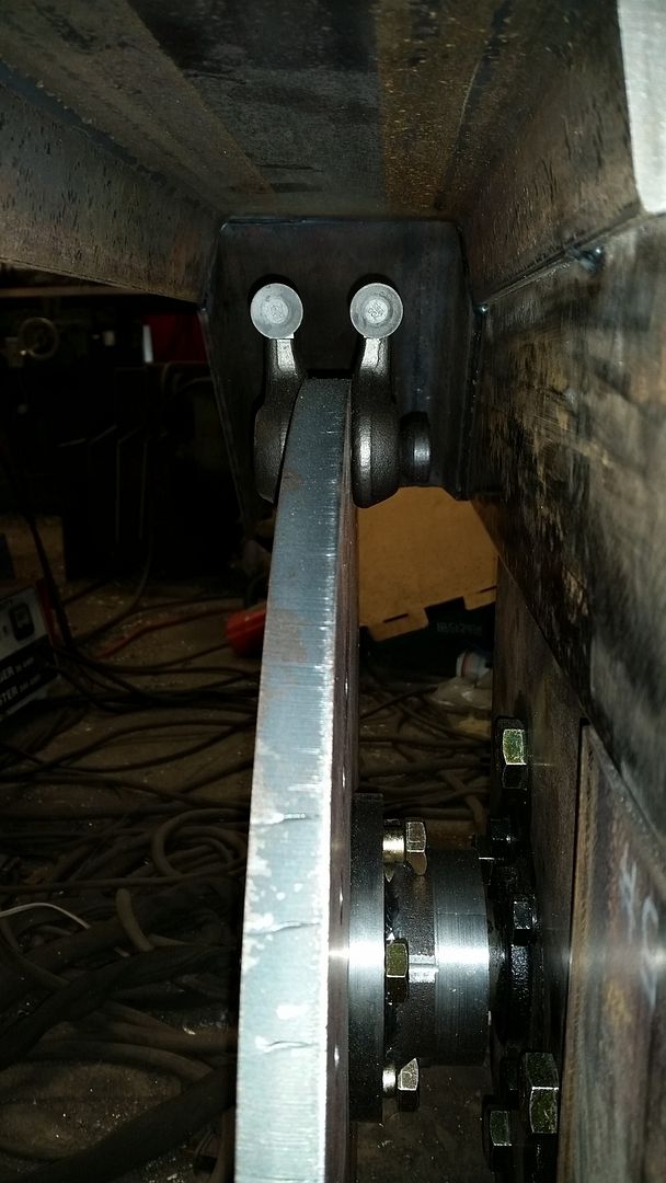

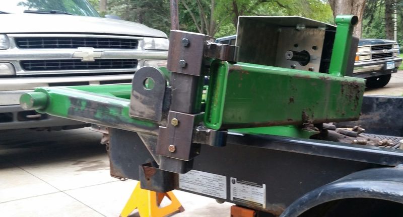

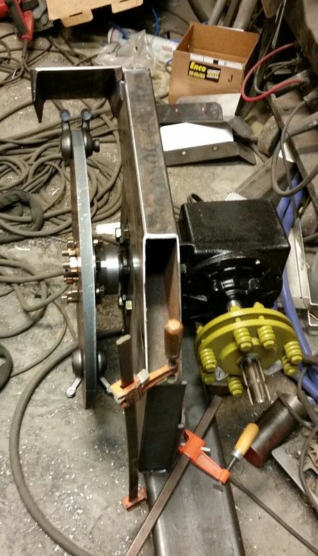

The original head pivot bearings didn't hold up to the abuse.
Ended up changing the ends on the top cylinder from the clevis' that it came with.
Having a bridge crane really comes in handy!
First check of the cutter clearance.
Getting thing's situated
More high tech sharpie drafting :)
You can see here, my first layout didn't provide enough room for the flange.
Ends are pressed and welded in.
With a relief groove for the seam
