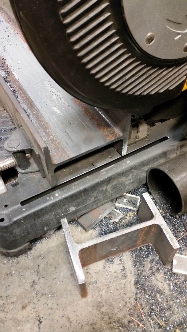

Dry cut saw doing one thing it does really well

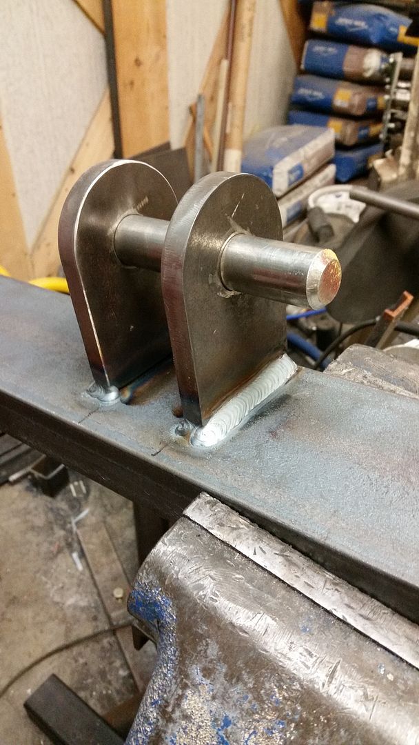

I use a temporary pin to hold things in alignment for welding
This is a different view of the hub flange before being assembled to the splined sleeve
