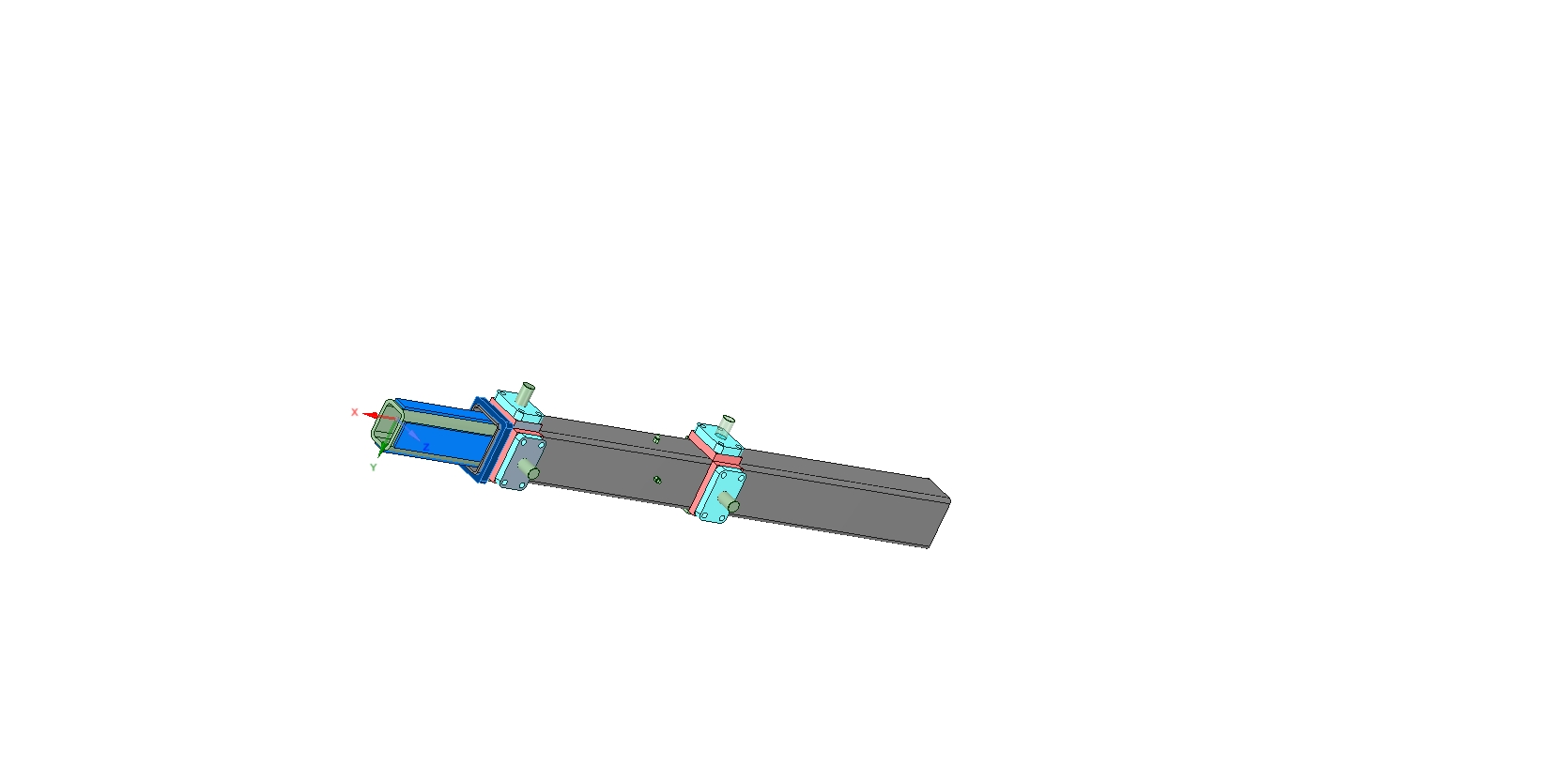

This is my concept for a boom. A double acting cylinder inside the tubes will extend and retract it 12". There a four single acting cylinders to lock the inner tube when cutting. Opinions?

I wouldn't worry about the locking cylinders, and I'd go longer if you're going to bother telescoping. Use 5/16" wall mechanical tubing and size it so you can bush it with UHMW.
