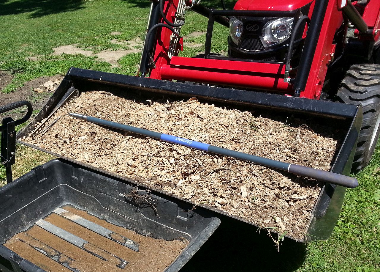

I bought one, and have used it a lot (though I seemed to find a lot of metal fence bits with it!) I have a shuttle transmission, which is not recommended, but most of my stumps are on slight slopes and I can point the tractor downhill and use the brake to feed the cutter. Otherwise, I can roll the bucket on the ground to put the tractor along; I've gotten good at that! The lowest gear gives me 1.3 MPH at PTO speed, which is waaaay too fast for grinding stumps.
One advantage of this style of grinder is that you can grind a stump that's almost against another tree. I ground three small stumps next to a large tree, and a large (36"+stump) next to a small tree.
This is not the be-all/end-all stump grinder; a dedicated unit is probably twice as effective. But like you, I'm "sneaking up" on finishing my landscaping/clearing, and I never know when I may need it. I've done nearly 100 stumps, walnut, maple, pine, whatever. When I want something done, with my quick hitch I can get it hooked up in a couple of minutes. So for that type of work it's very nice. For a large land clearing project where all of the targets are known, I'd go rent a big, powerful dedicated unit.
Note that you'll make a ton of shavings if you have large stumps; I've probably used ten or so bucket loads as mulch in the garden, the rest spread on freshly cleared ground.

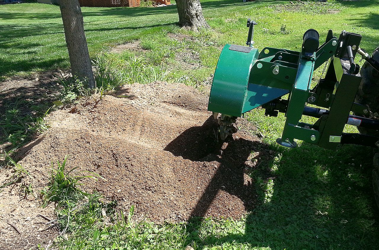

Truck driver easily put the pallet on my Pickup. Receipt and transport were simple.
Opened the crate up and am very impressed with their packaging. As others have mentioned, they have a steel pallet.
Minor assembly was required, instructions were excellent. Was warned about slipping the slip clutch before use and that was no problem. I didn't have to cut the shaft for my setup (Kubota L5740 with Pat's Quick Change hooks.
First thing I noticed was that lengthening the Toplink was necessary to be able to see the blade. Don't have great view of the blade but it is more than adequate.
Short learning curve on this implement. A few notes:
1 - For those of you that run 540 implements at less than 540 to save fuel (I've been guilty before) - Don't. This machine does a much better job and bounces less if run at 540.
2 - Tighten down your lift arms so that there is as little sway as possible. The machine wants to pull to the right. This makes perfect sense when you think about it.
3 - Keep your hand on your lift lever. You can make fine adjustments that way.
In 1.5 hours, I ground 9 stumps. A couple were very larger than 24".
This attachment will pay for itself very quickly. I'm very pleased with the prompt shipment, packaging and, most of all, performance.
I wouldn't want to spend 6 hours straight with it. Can develop a crick in your neck from looking back all the time.
For my purposes, this is perfect.
Hope this helps.
   / Stump Grinder Woodland Mills WG24? #180
I ground more stumps today. For large stumps, it chattered/bounced less when I started on a side instead of starting in the middle.
I continue to be impressed with how quickly stumps can be removed. Perhaps it is because I'm taking them level or just below grade. I'm not totally removing them, just making the area so that I can run a bush hog over it.
I also used it on a number of smaller stumps on a trail I'm cutting in dense woods. 6" diameter stumps are gone with one, sometimes two passes.
Only real complaint is the crick in my neck from looking backward.
