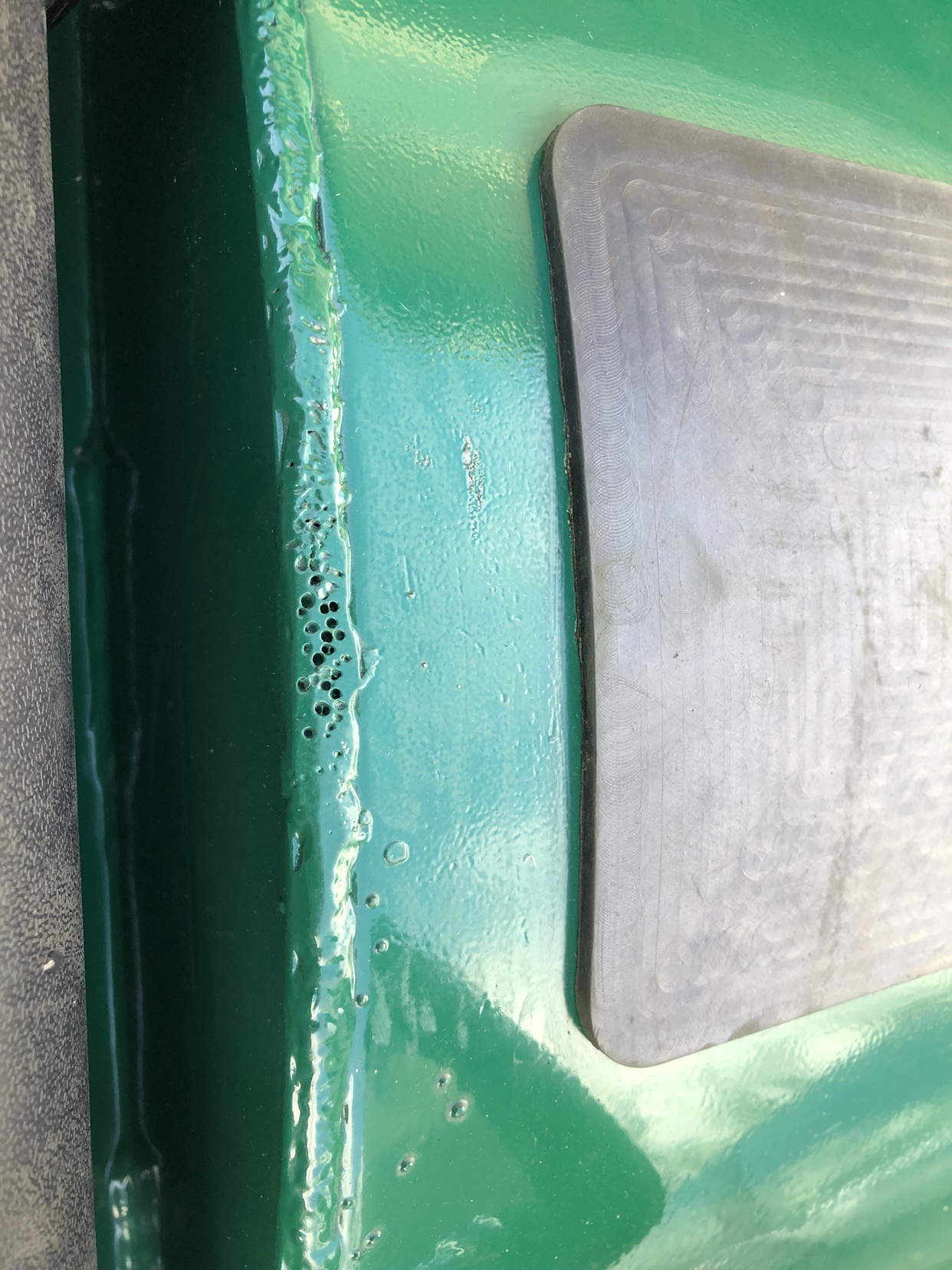

Unboxing my new toy. This thing sure looks beefy. Being a welder in the past I am quite disappointed in the quality control of the welds as shown. I’m going to have to grind this out and reweld it. Too bad this didn’t come with touch up paint. Working on getting my backhoe off so I can see if the drive shaft is too long. I love the disclaimer that states if you cut the drive shaft you void the warranty but all the instructions teach you how to do it and tells you to do it or the unit won’t be safe. More to come... View attachment 545176View attachment 545177View attachment 545178View attachment 545179View attachment 545180View attachment 545181
Omg those welda are embarrassing!!! I would call them back!!! Ask for a partial refund or discount for time to redo them.
   / Stump Grinder Woodland Mills WG24? #195
Wow - my welds look better than that and i'm self taught. That is sort of disappointing. I am looking forwarded to seeing others in the future as I been thinking about ordering one but would like to see much better quality.

Aside from the swiss-cheese welds, how does the grinder perform?
I'd be getting a partial refund and a can of paint out of them or having them send a new unit that passes QC by someone other than Ray Charles.

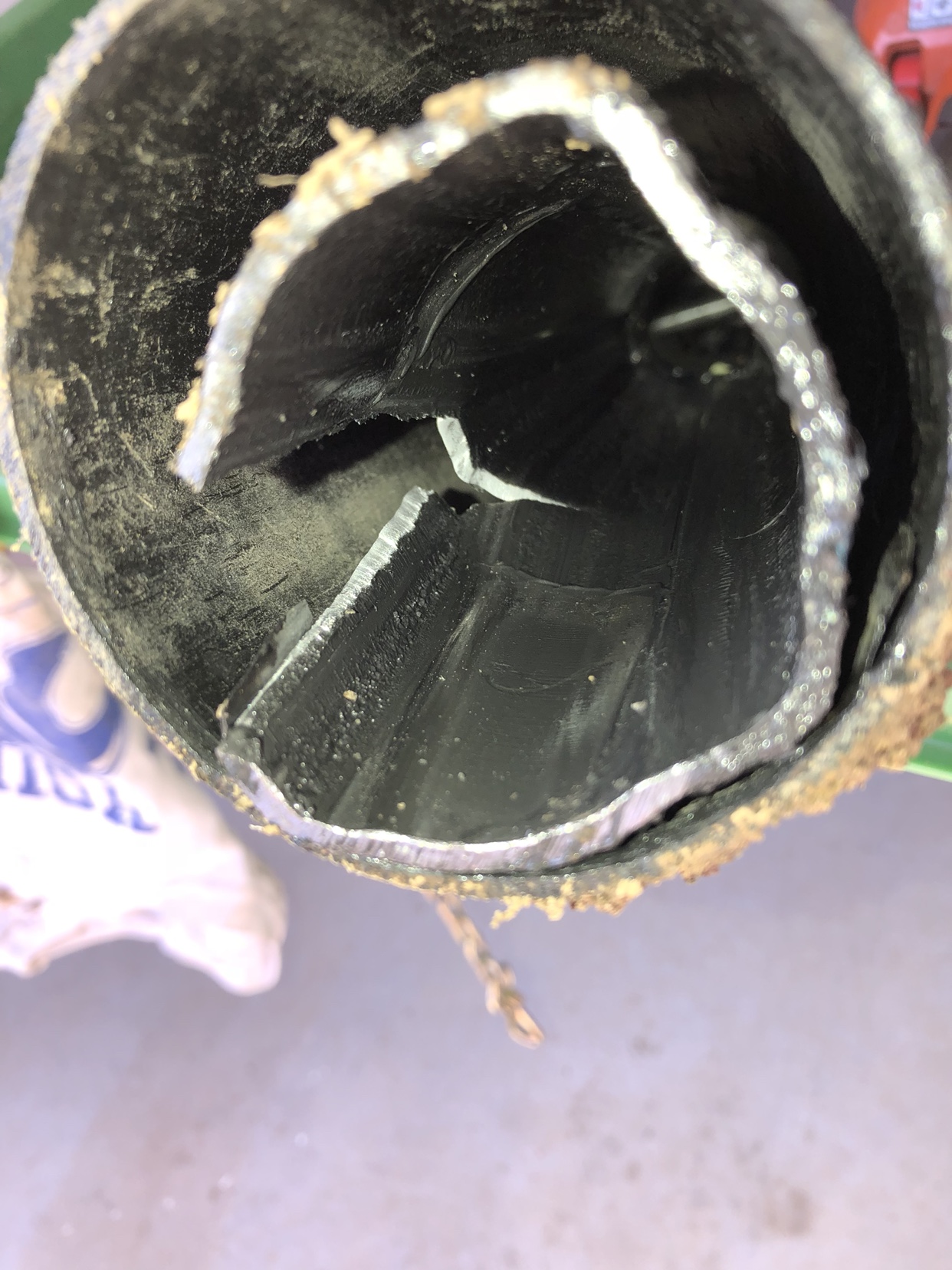

IMG_0516.JPG here is an update on how my grinder is performing. I am hoping for a warranty shaft. If not I hope I can get a replacement tube and repair this one. The slip clutch works fine if the grinder is bound but I think there was a void in the metal. I barely touched the stump and it just popped.
