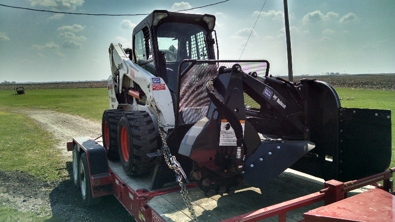

I just rented a skid steer with stump grinder last weekend and completed 6 stumps in just under 2 hours. Good size stumps and one that was 3 foot tall yet.
That machine was a beast.
