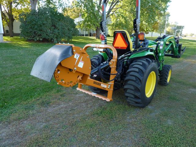

Remind me again....what was the purpose of PULLING these stumps? :D (those little ones could be ground out in about 10 minutes....or YOU could use your large grapple :laughing:;) )
