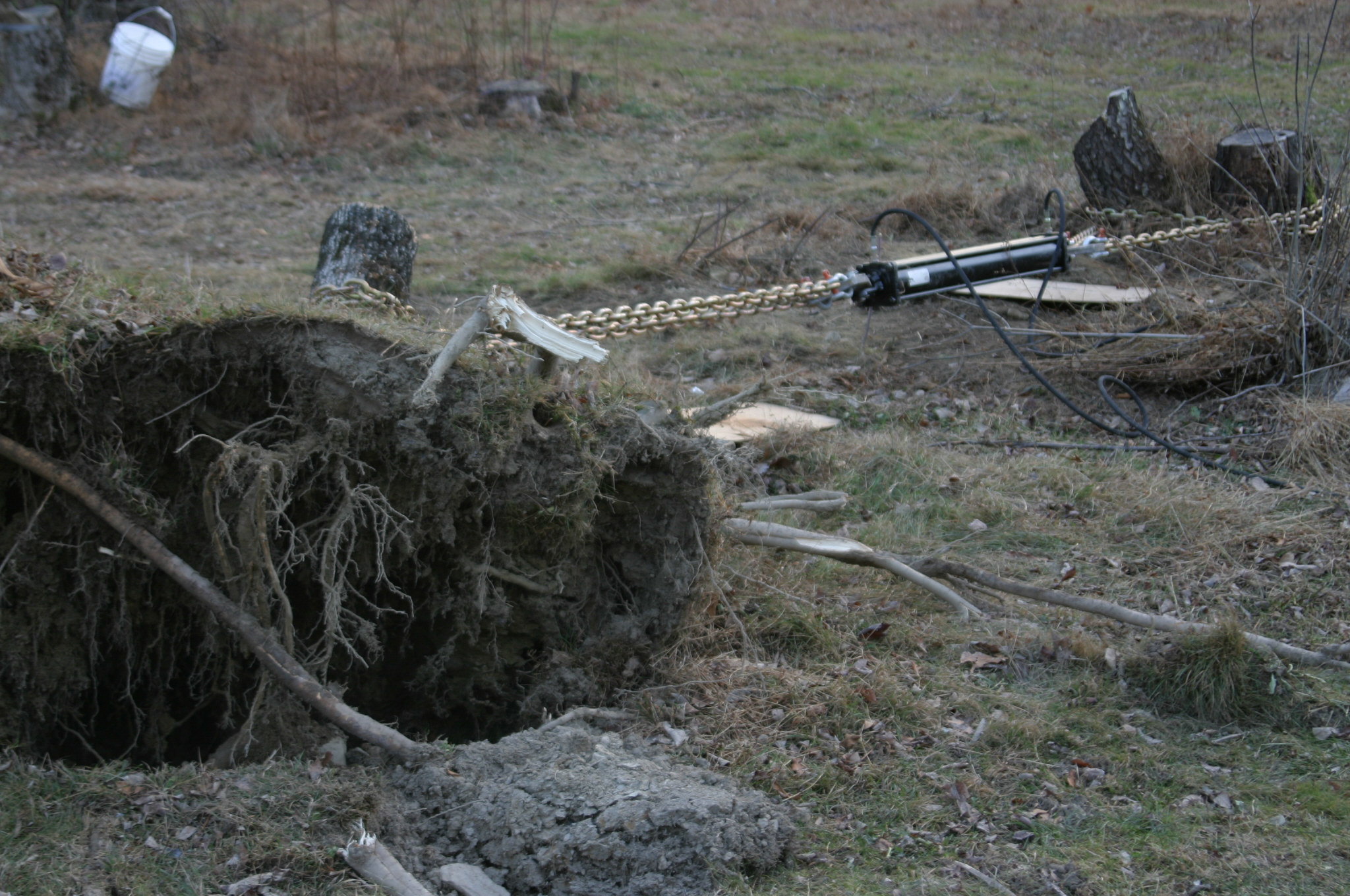

I'm wondering about the actual forces involved now. If I could do it with single chain on each end it would make it alot simpler. I need a way to set the pressure to the chain strength to avoid breaking expensive chain. I guess the gauge and the throttle will do it.
Breaking strength of GR 70 chain is 4 times the work load limit. This is there because most working loads involve inertia and acceleration/unintentional jerking. Your load does not. I would not hesitate to go to 2.5 the WLL of the chain for your type of application. Actual chain stretch will happen above 3 and then youve damaged the chain, but not necessarily weakened it any ... just less stretch available to absorb jerk energy. Watch out for hook problems. The chain is stronger than the hooks.
Does the cyl have 14T pull force ... or is that its push force?
larry

that was just so I could use single chain, but after feeling how tight they were I was glad there were two of them on there. Don't have much experience snapping chains but I bet 1/2" grade 70 isn't where I want to start.
As for getting the trees to lean I'm going back and forth between trying to yank the stump halfway, or using a lever to increase my draw length, and going with like four 1" ropes up high. I know what you mean about 'almost' getting it to lean the right way. One is going to be tough. I'll save that one for last.
You cannot break or even come close to stretching a 1/2" Gr70 chain with 14T force. Breaking strength of that chain is 45,200 pounds.

Thanks Larry, I've been wondering about that. The pull calculates to 29,158 if my pump goes to 2700lbs., so I guess I'm at close to 3x WLL on the (single) chain. Gotta check the hooks I ordered again, I think those are chineese.
edit. the hooks say they're rated the same, 11,300.

Looks like I'm gonna have to rent a POD to store these things.

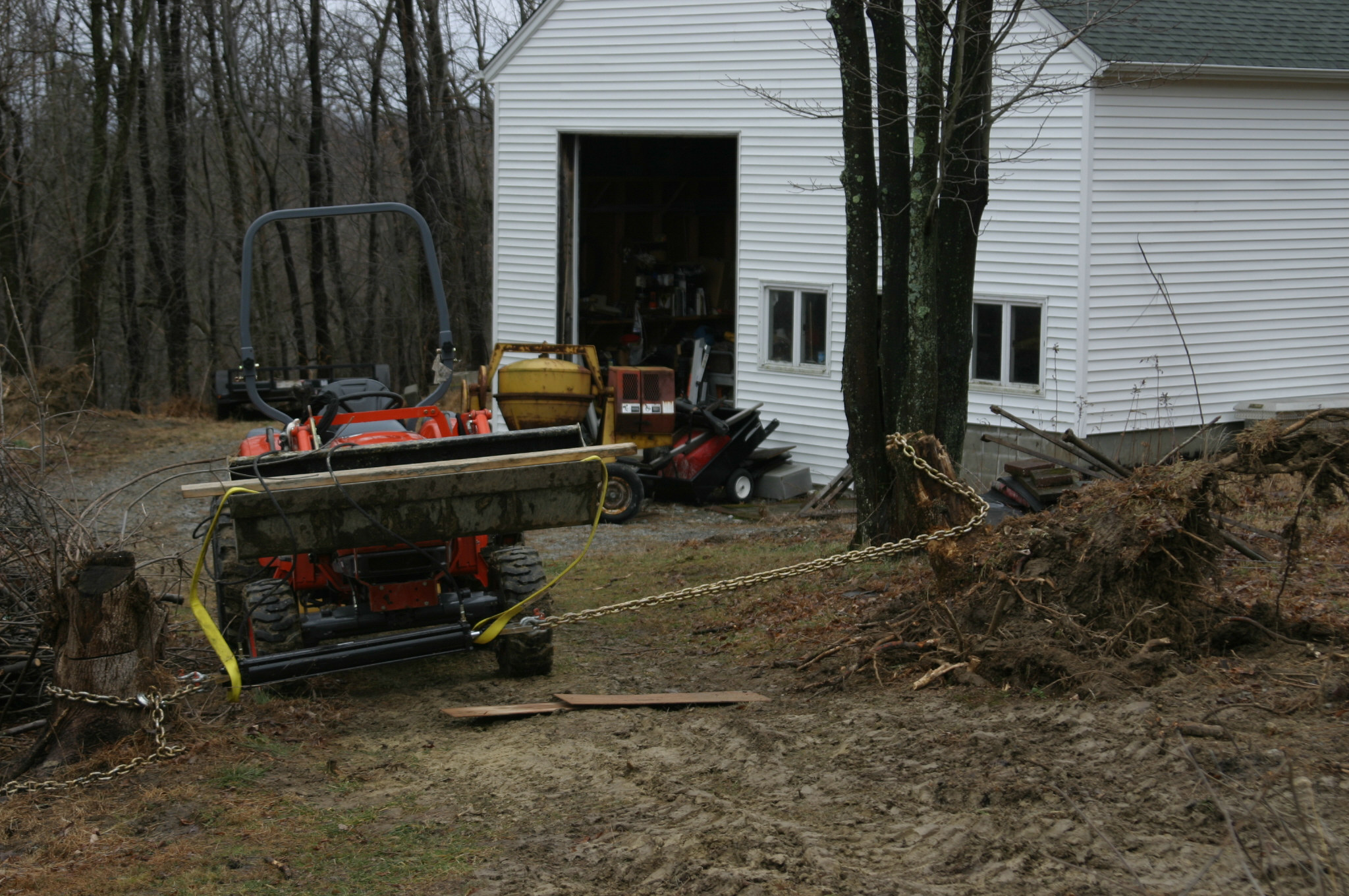

I think I'm gonna call this the final system. The straps allow me to move it, (they're a little long, but I had them), and I can set it on the next stump for storage. I picked up a couple grab hooks for adjustments, only one used here on a short piece of chain, gonna put one on the other end tomorrow.
