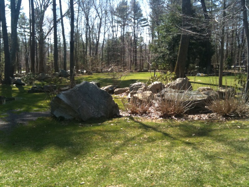

dave1949 - My wife wants to realign my rocks too when she heard the estimates. Basically its moving them to the perimeter, and maybe some "farmer style" walls on the interior area to create a nice looking natural effect not a "landscaped" effect.

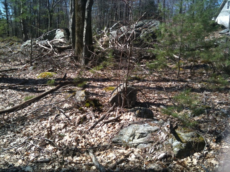

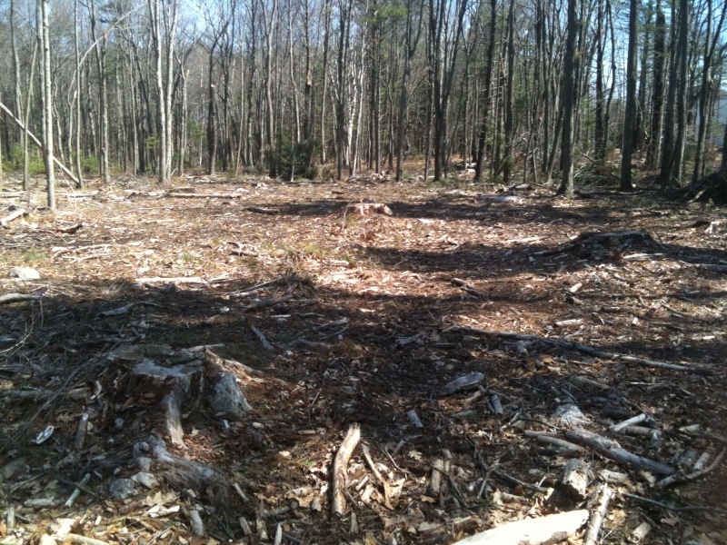

Once the large rocks (3-6') are generally placed and the medium ones in order, I will deal with the balance. There is probably an area 60' x 80' that is just ledge and needs the most work - see the pics. Also I got the "new" 1/2" thick rachet rake two weeks ago for my B21 so it will be getting a workout once the major stuff is out of the way.
Here are several shots of the "project" area, and one is of our current lawn area - these rocks are all natural, lived here all their lives, and dont like to be realigned with little machines like my B21..

I think the part that is already done in the first pic looks good. Adds character. On the bright side, ledge requires very little mowing :)
Dave.

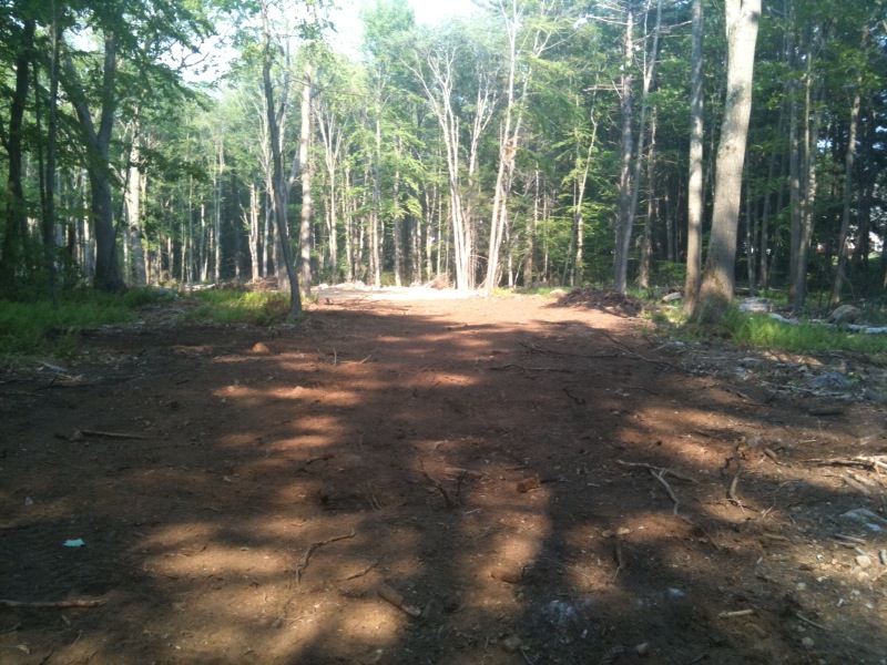

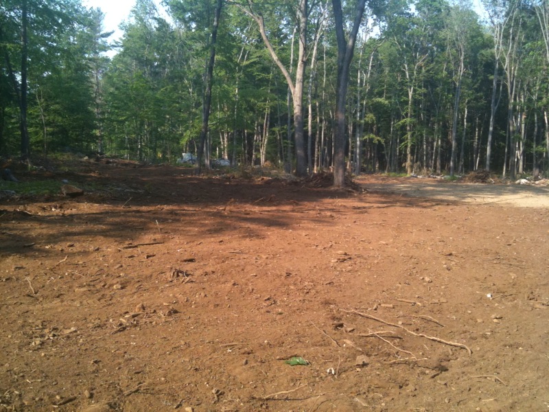

/ Stumping & Clearing Project Estimates
Well the stumping is done, lots of ledge so the dozer didn't do much to rip up the roots so that has been my task with my york rake. Lots of piles of roots now and more rocks!
The stumping took 3 days then a day loading out the stumps and then final rough grading with the excavator and burying the left over pieces of stumps and misc debris.
Here are some shots after york raking and some 300' of walls built. After york raking and rock picking I seeded grass to get some ground cover.
Next is the select replanting with some hemlock and hardwoods.
