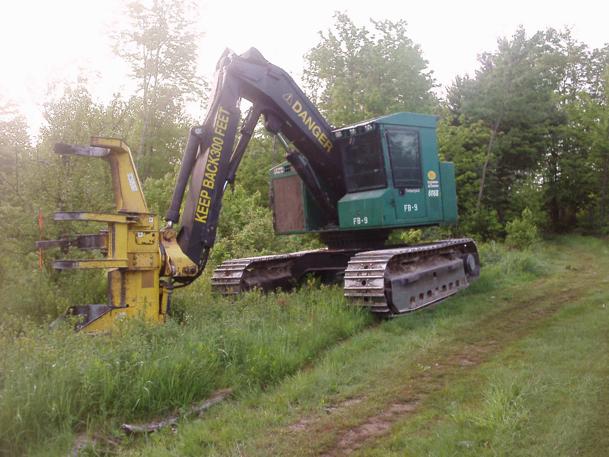

Hardwood is in big demand in my area $$$ I certainly wouldn't waste my timber. I dunno what you have either but a 14 inch + tree is worth something..
   / Best way for clearing HUNDREDS of stumps? #29
I was thinking the same thing. That's before we start talking about what to do with all of those trees afterward. As a very rough estimate if the field is completely grown in. you have 1 cord of biomass per acre for every foot of height.
