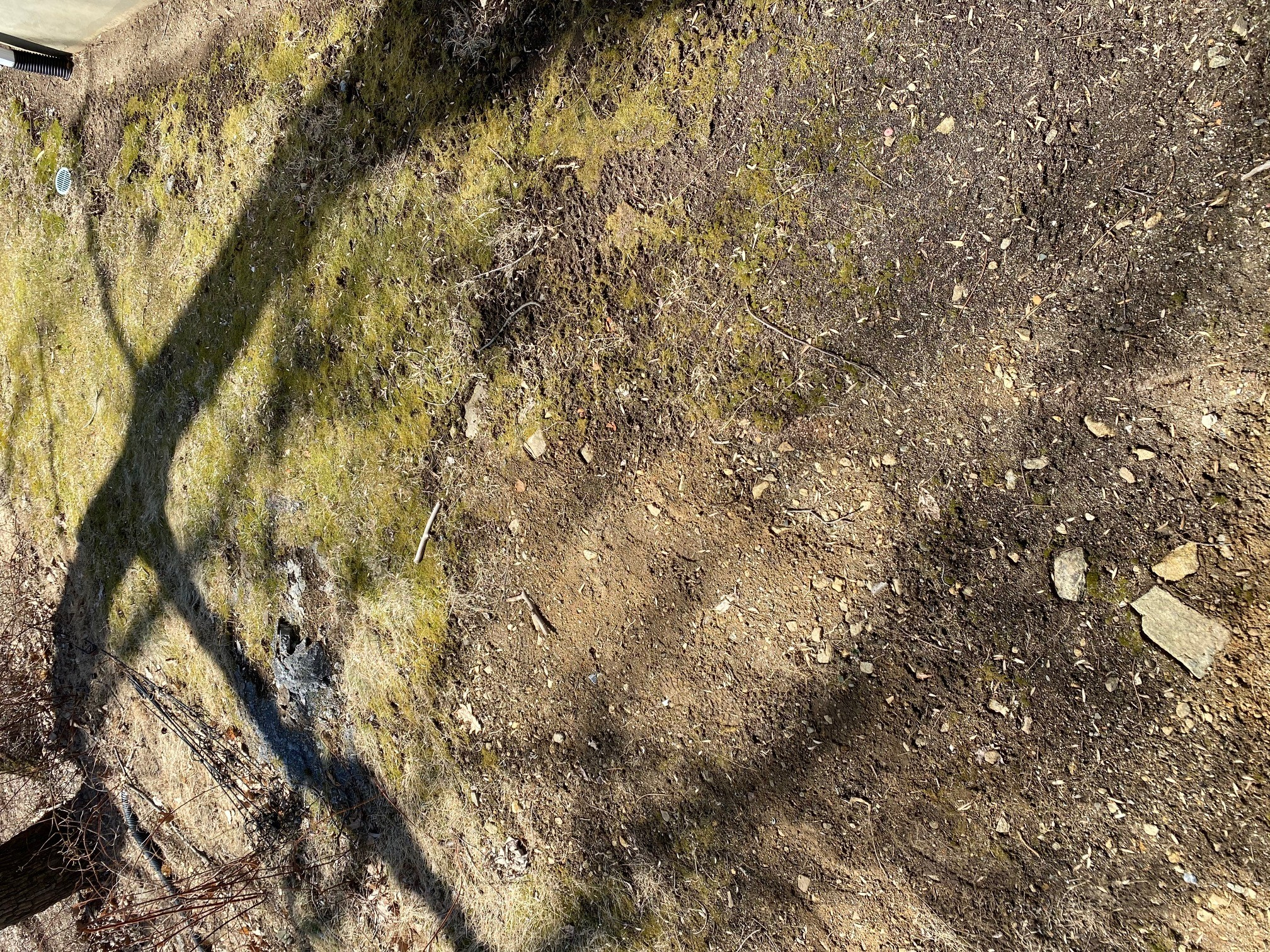

Def decided to go with a BH at this point. If they can help me get stumps out that is a bonus. Will probably be going with 2 or 3" spacers. Will add cast weights if I think I need them later.
Here s a question, is there a single implement that would be useful in preparing ground like this for lawn?

The BH will be useful. Up to about 18” stumps you can generally do within a reasonable amount of time. Bigger can be done, but takes longer.
Fill your rear tires, simple, best ballast there is.
If I wanted to plant that, depending on depth of top soil, I would just cite aerate it and overseed.

Sure is, ratchet rake, it's a tooth bar that straps on your loader. It's like $300 I think I paid for mine. You're gonna want a ratchet rake for what you're going to be doing out there, I think. Google it, you'll see what I mean. And I got vids on youtube of me using it, clearing out brush, leveling and preparing for seed...but something is wrong with youtube right now, I can't load any pages of it.

I have looked at the ratchet rake and love the idea that is all I need! Do you know if it can be attached with a piranha bar or similar installed or does that have to be removed to use the rake?
