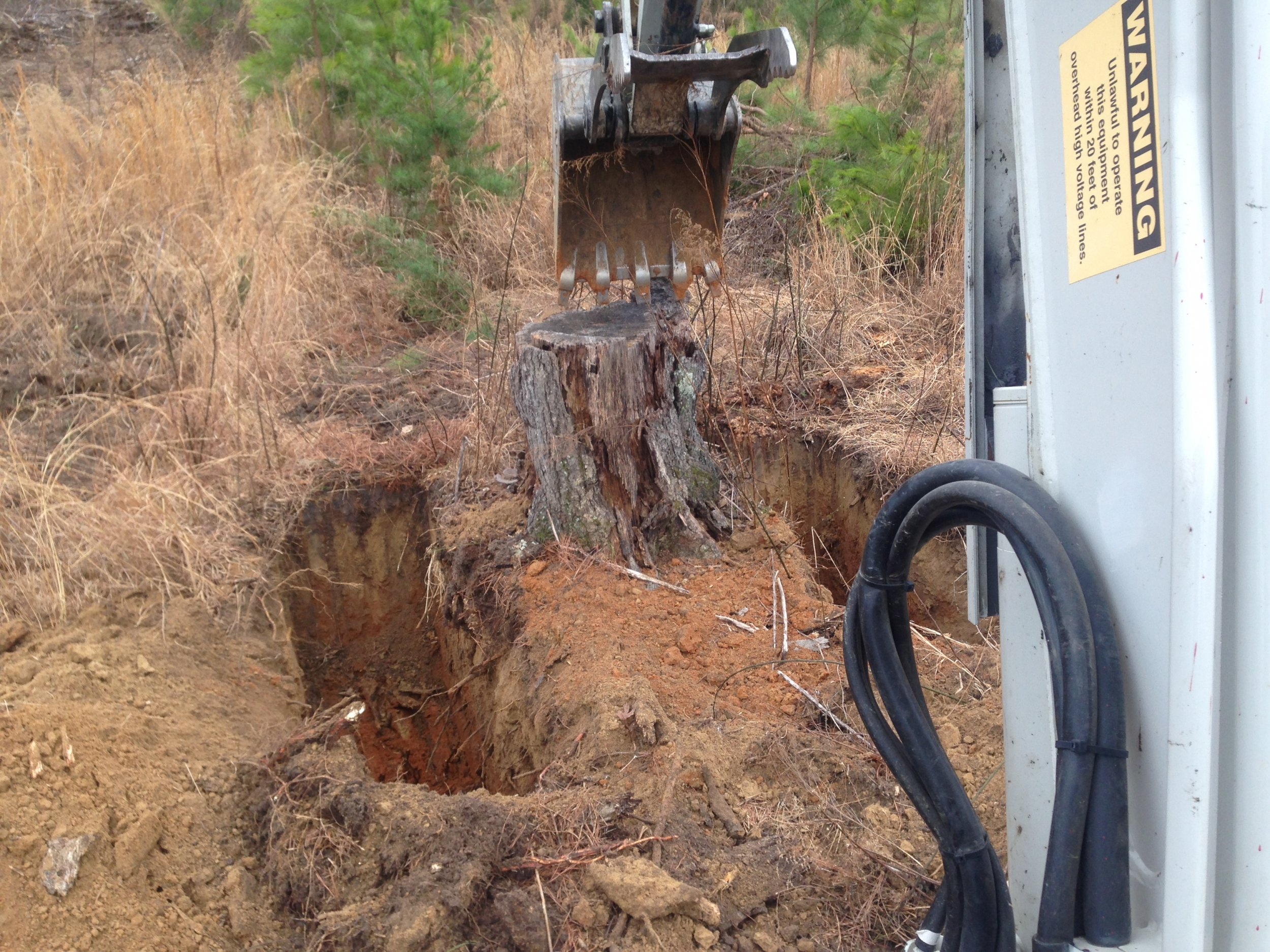

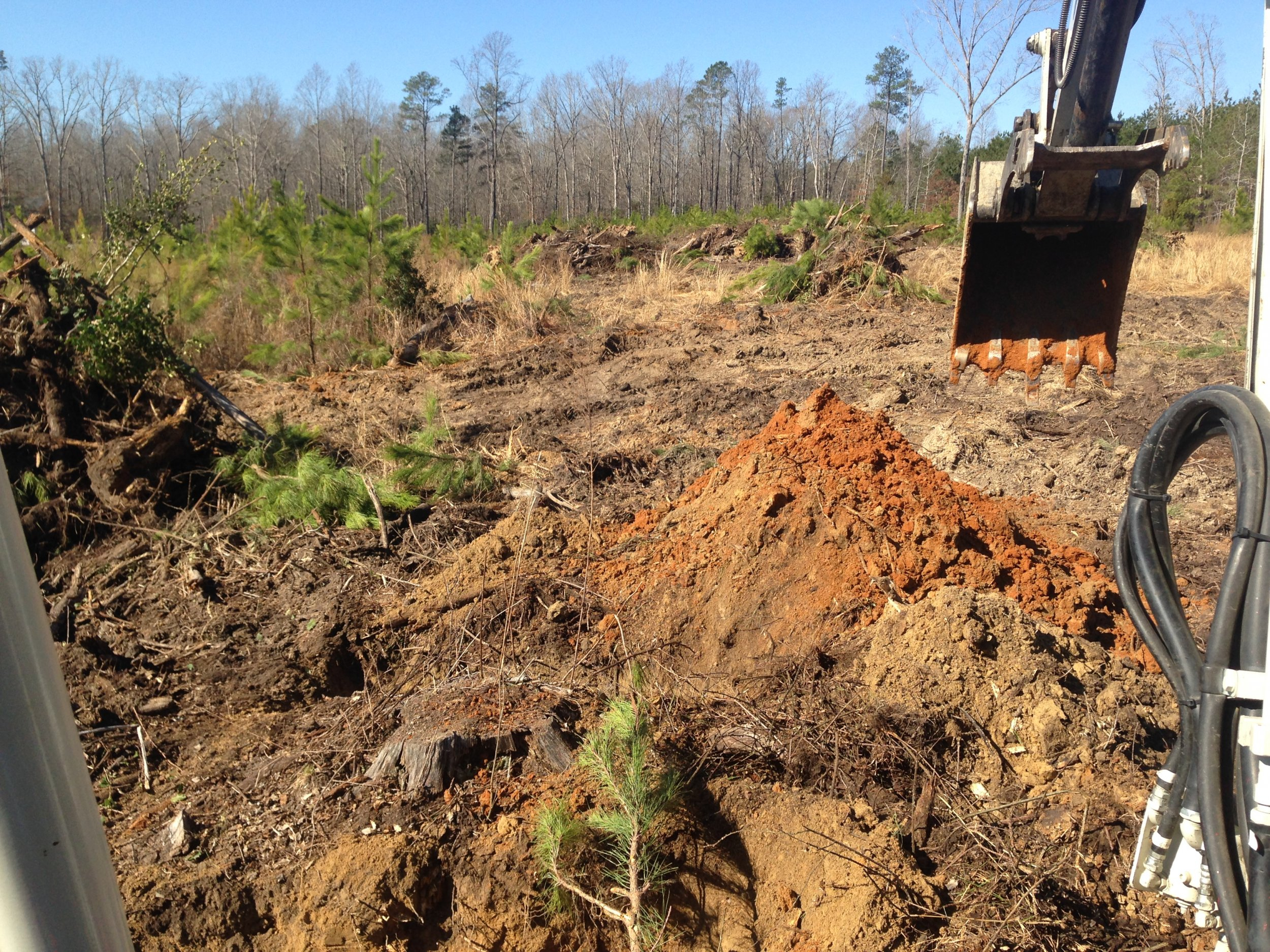

Nothing wrong with getting a sub-compact for your property with back-hoe. It will come in very handy. You will love having a piece of equipment to assist you. I would like to have one as well
However, when you say 24inch stumps, a sub-compact is not the choice I would want. I rented the biggest takeuchi mini-ex I could get (Think it was 16,000 lbs machine)when digging stumps on three acres of my property. It took 45 minutes to an hour to get those big stumps out of the ground with that mini-ex. Some of those stumps where deep as well, not to mention the hard pan dirt stuck to them. I spent two weeks digging stumps to clear that land. I could not imagine digging a 24 inch stump with a sub-compact tractor. It can be done but you can dig one by hand too, just a LOT of work. When you say a few 24 inch stumps, are you talking 3? If so, just hire someone to dig them up. Maybe get them ground up? A sub-compact BH is not designed to dig 24 inch stumps. I attached some pics of that job to give you an idea of 24 inch and bigger stumps. The bucket on the mini-ex is 24 inches.
