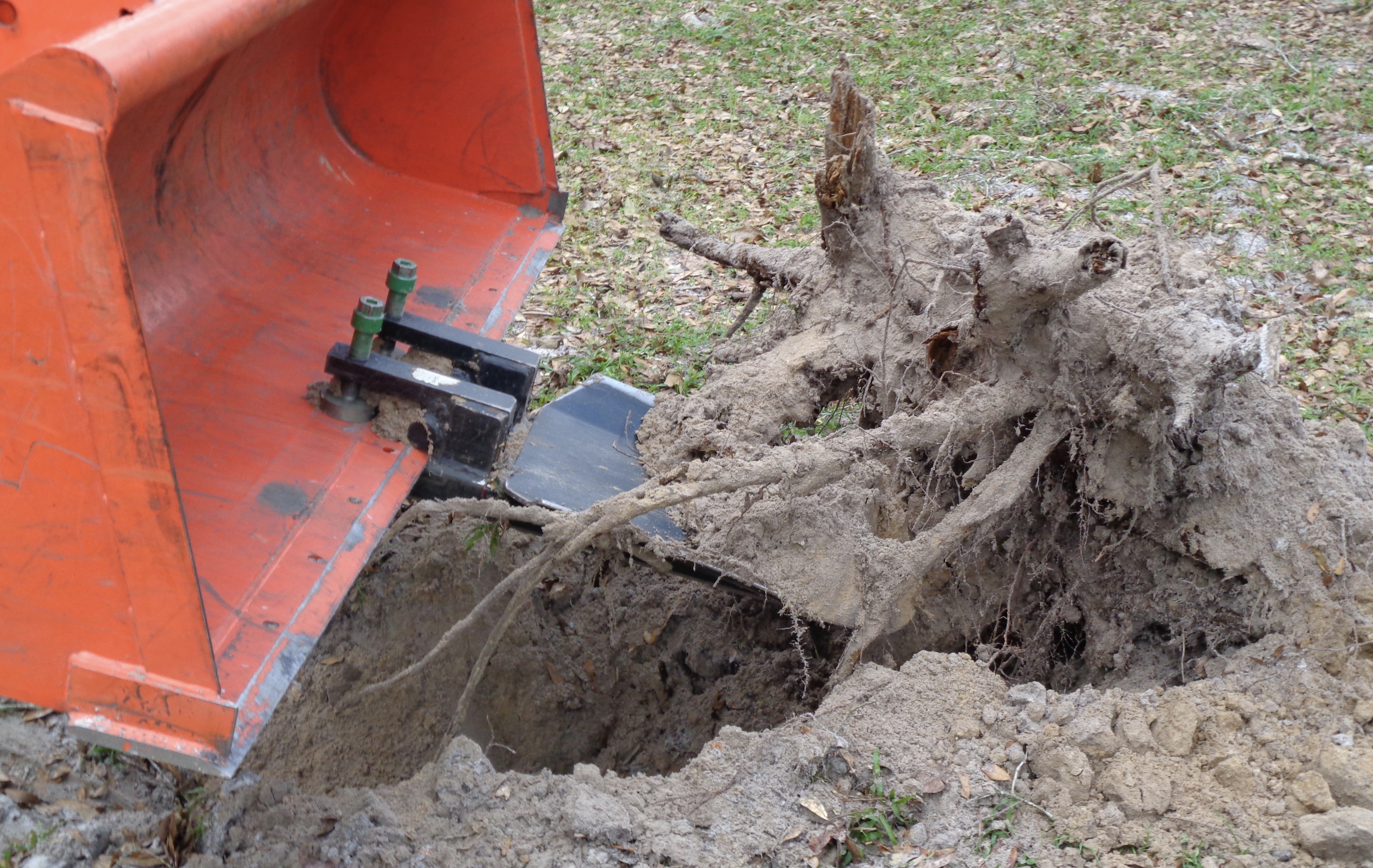

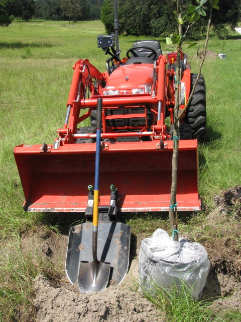

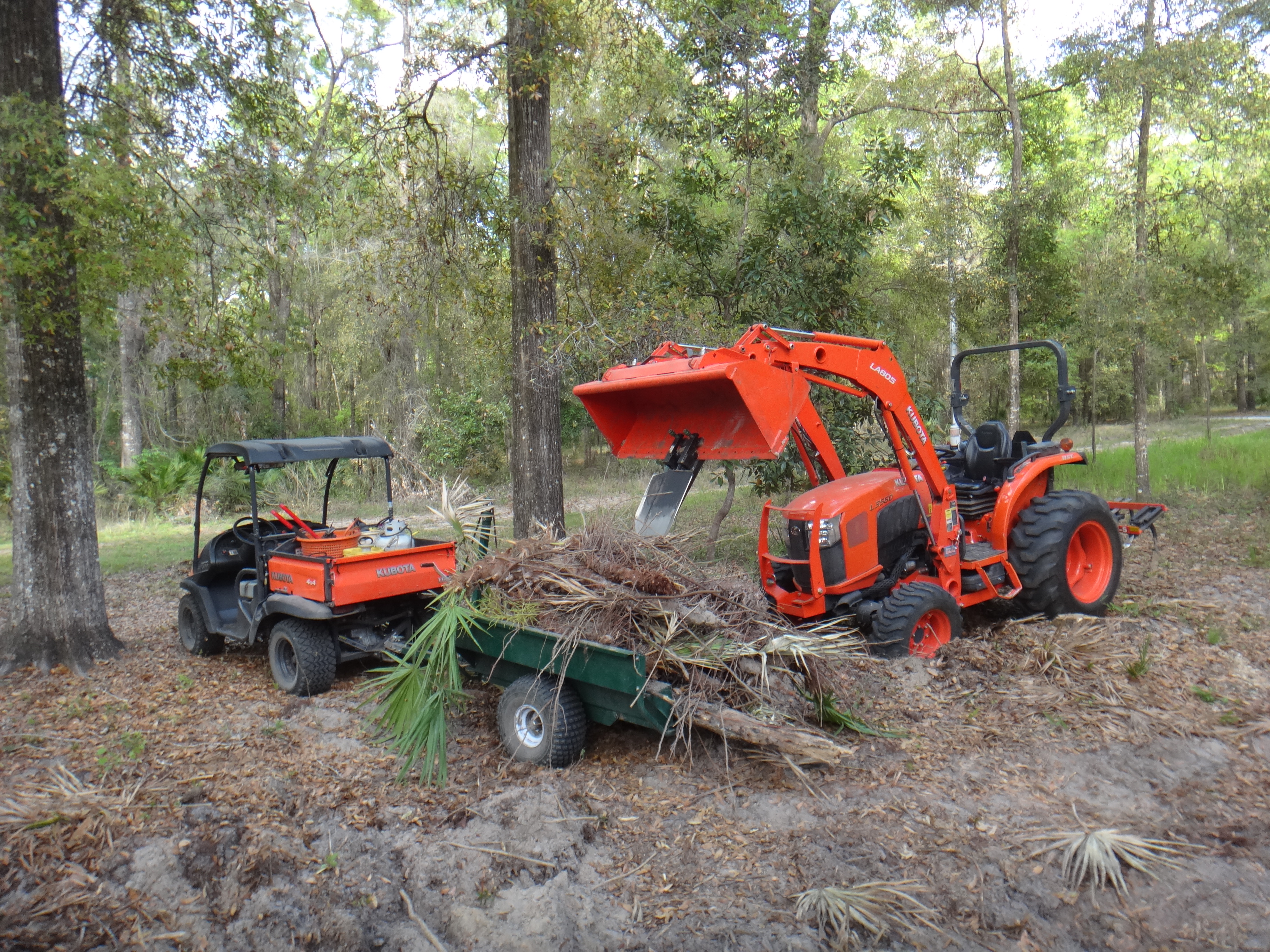

A FEL Bucket Spade costs $400 and will do a fair portion of Backhoe tasks on an 'L'. Good mounted on a standard bucket, better on a Kubota optional L2296 SSQA heavy-duty, round-back, bucket. (SSQA = Skid Steer Quick Attach)
MUCH MORE: https://www.tractorbynet.com/forums/attachments/328798-bucket-spade-today-fel-bucket.html?highlight=
If your neighbour is happy to help, or if you can occasionally hire a mini excavator, you'd be better of with the heavier machine without the backhoe.
YES. L2501.

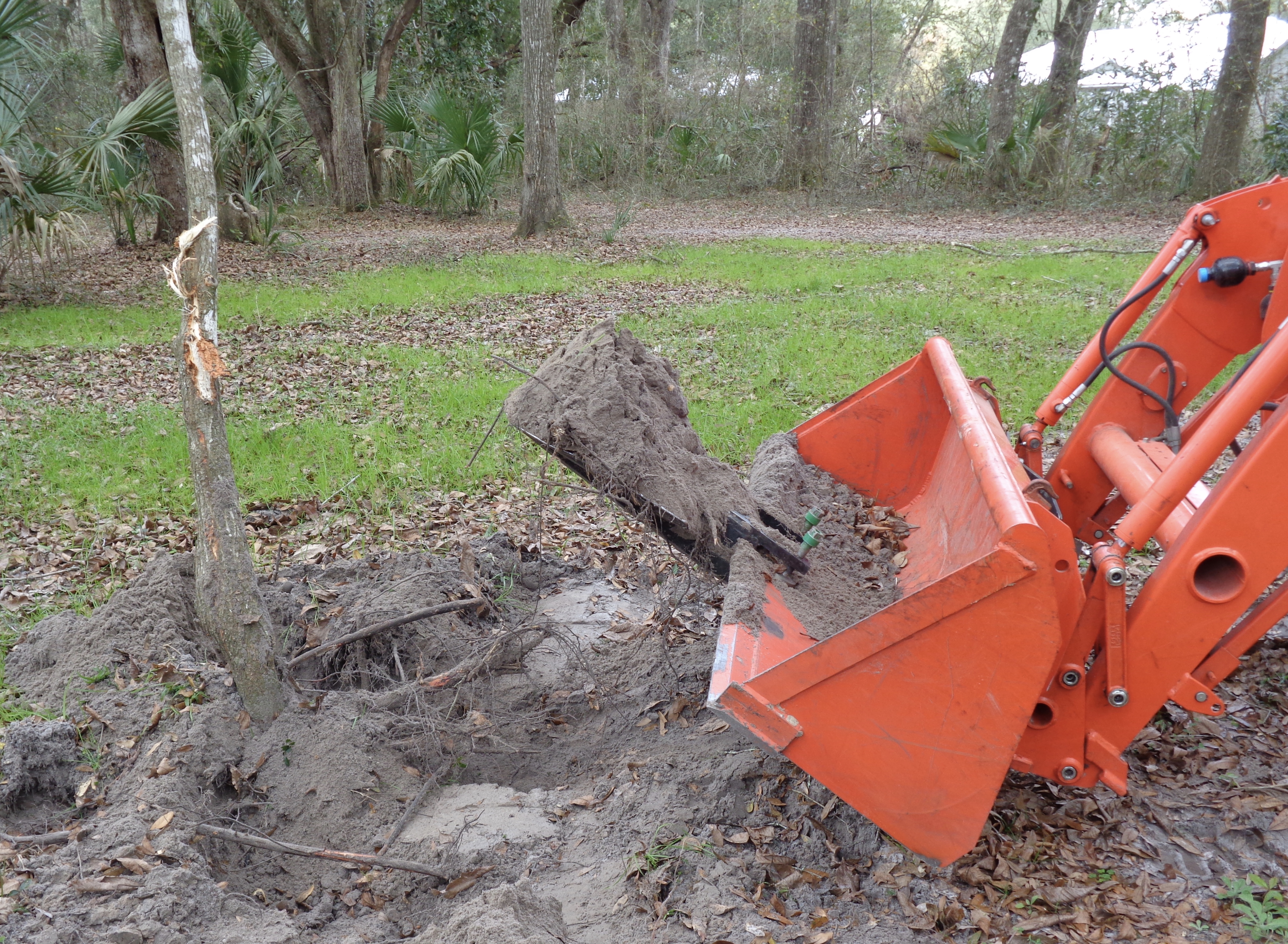

/ Subcompact with Backhoe, or Compact without. #20
Well, as those pictures show, 10-12 inch stumps aren't really an issue. I've taken out another 20 or so smaller ones.
