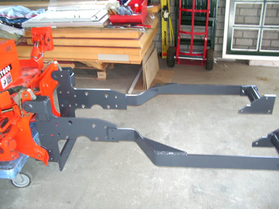

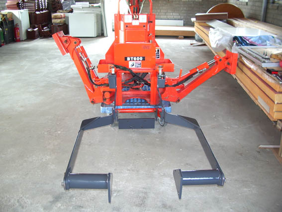

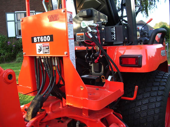

   / Subframe BX24
#29
Hallo Gentlemen,
My job..to put a Backhoe BT 600 on a Kubota BX2350 is finisched and is
working perfect see attached pictures!!
Thanks everbody for the information I needed..if sombody needs some drawings or other information please let me now!!
Regards 'zunnie'from Holland
