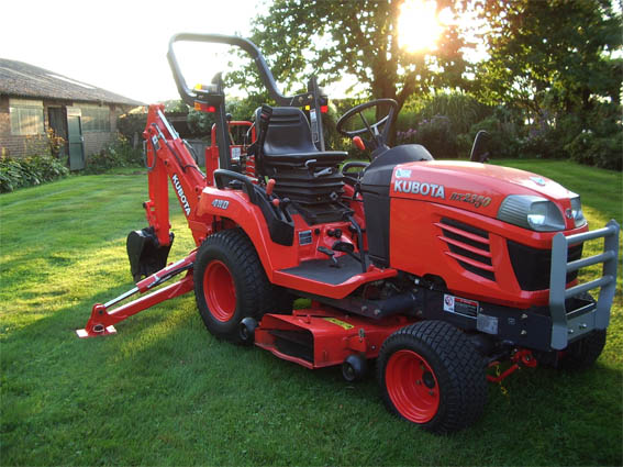

First, I disagree that the BX2350 cannot handle a BH. With the appropriate subframe, the Woods is a great unit. I have no reason to believe that my tractor is going to die anytime soon by the simple addition of the backhoe.
Second, I'm confused by something. THe BX24 and the BX2350 share the same wheelbase, length, width, engine, body, wheels, EVERYTHING. I'm confused as to what the critical differences are between the two frames that make it IMPOSSIBLE to simply mount a Kubota BX24 subframe to the BX2350. Though Kubota would probably have a fit. But it would seem odd that they have these two tractors come off the line and them not consider both in the frame production...what I mean is the holes necessary to mount the subframe. Installing the hydraulics is a piece of cake after you get this feature tackled.
Lastly: I'd be VERY, VERY, VERY weary, Mr. Zunnie17, of making a subframe from scratch. My subframe goes from the back of the tractor all the way to the front wheels with complex heated bends, castings for the mounts, and all other manner of complications. Given the amount of stress the subframe must absorb and send through the rest of the tractor and given the UGLINESS that would occur should the subframe break while in use, I would not pursue such endevours. Not for a second. Surly there is a way to get a hold of a proper BX24 subframe with less difficulty...

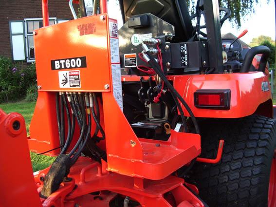

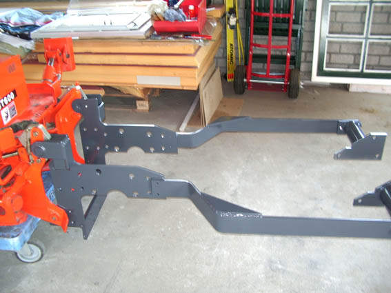

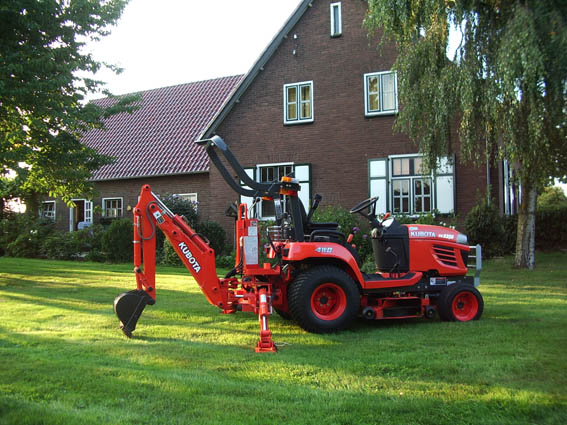

He is in Holland and I don't think he meant Holland Michigan.:D:D
So that will drastically change the cost factor. Importing Woods equipment may be an impossiblity. He already has a BT600 backhoe so there is most of the cost righ there. And he looks like he has some pretty good fabrication chops. Check out that picture.
Hey Zunnie don't forget about the ROPS, you will bang your head on it if you dont extend it. Getting the rotating seat fixture might be a problem.
   / Subframe BX24 #15
Totally concur regrading Woods. Silly since he already has the BT600.
I picked up on what he's really asking...isn't the BT600 for the BX22/23? Kubota lists the current BH as the BT601. And THAT's what he wants to put on the BX2350.
Assuming there were different holes put in the BX24 frame for the subframe than a BX23...dunno.
Concur that he clearly has the fabrication part down, but I hope that is just the beginning of the subframe...can't say what Kubota's looks like, but mine is over 5 feet long. Just don't know if it wouldn't be easier to see if Kubota would sell a subframe seperately.

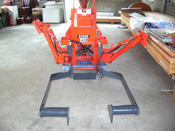

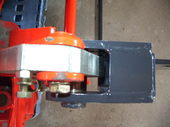

   / Subframe BX24
#16
The next step is to put some frontend rear-and leftbracket welded to this
subframe untill the support of the FEL.like it is done on the Woodssubframe BH6000 ( some more picture will be send !)
Regards Zunnie17 from the Netherlands!
   / Subframe BX24 #17
I can't wait to see the results.
Are you cutting your parts on a CNC plasma table?
Bernie, I see that you have a BX23. I would like to know whether you have ever sat on a BX1500, 1800, 1830, 1850, 2200, 2230, 2350, or 2650 that had a Woods BH6000 added to it? I have a BX2200 with a Woods BH6000. For me, there simply is NO issue with the ROPS, and I have never read anyone else who said he had one.
I would like to know if you are speaking from experience or if you are simply guessing.
My mistake, I was in a hurry when I posted this.
I should have put "you might bang your head" I do know that a lot of people, even most, don't have any problem with the stock rops. However, when I first started researching my BX purchase (sometime in 2004) There was a lengthy thread about a person putting the woods unit on a BX and he did have a problem with the rops and found an after market solution. Whether from Woods or somewhere else I don't know.
I have banged my head on my extended rops so I "guess" I would be able to hit it on a standard BX. Although it should be something that is easy to learn to avoid.
As you might tell from my posts I was dropped on my head as a child and am sensitive to this issue:eek::eek::D
I apologize for making a statement about something that I have no direct experience with.
