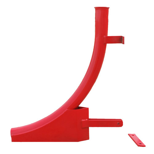

Yep, local codes rule. In Fairfax County, VA, in addition to the minimum depths, the electrical and water lines must have a minimum of 12" of separation of dirt, either vertical or lateral. They can be in the same trench so long as that separation is maintained. But running the water line directly below the electrical cable creates a huge headache later if you need to access it! If one trench is absolutely desired, the better practice is to use a 24" hoe bucket and lay the lines on either side. Or a narrower bucket and create a ledge for the electrical.
problem in same trench, is i like to "snake" both electrical and hose lines within the trench, so if there is some frost heave, "more so settling" the wire and/or hose. has some slack to move. vs stretching and breaking / cracking / splitting.
when i say "snake" more of a WWWWWWW back and forth through the trench. (if the W's were one constant line)
digging up old lines, i have found a noticeable difference between say someone taking a potato plow / middle buster, and just pulling wire/hose in one constant tight line/trench. vs weaving / snaking the wire/hose into a trench. the stuff that was put in as one straight line, has more nicks in it, and for wires the insulation was discolored in some places (stretching of the insulation happened) or you could take your fingers to the insulation and almost roll/rub it off. and like doings with plastic hose water lines and LPG copper line.

It works, but Agri supply sells them for around $80, not including subsoiler. Hooked it up to my old tractor supply Company subsoiler without much problem pulled in a bunch of sprinkler lines
   / Subsoiler for burying PEX #36
Also I haven't really been able to bury below 6 inches starting from Grade, which is fine for sprinklers but.. On the other hand I think I could get it lower by digging a starting hole down so I'm not trying to pull down, just straight.
I was originally going to pull pex but decided 160psi poly was cheaper and made more sense.
Looks good, but I'm not sure it would bolt up to the Fred Cain subsoiler I found. ASC says it works with 3 Point Subsoiler-Subsoiler Attachment | Agri Supply #73410
Anyhoo, finished up all the backfill today. All the water connections are dry and all the electrical works fine. I did take the added precaution of putting GFI plugs in both circuits.
