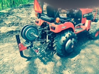

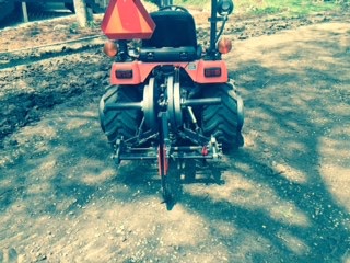

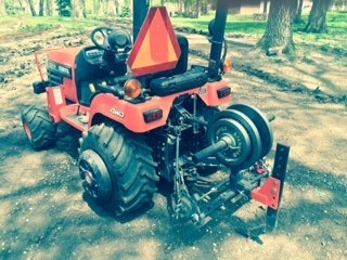

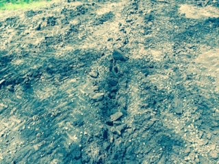

Reviving this old thread. This ripper built by Greg at Heavy Hitch is a versatile and useful tool designed for SCUTs, and mounts to any 2 inch receiver. The ripper worked well to break up compaction before using a Kuhn tiller and before reseeding the lawn. Using a crisscrossing pattern and maintaining a 6-8 inch depth, the Kubota BX2200 pulled it well. Tree roots, rocks, and hard compaction were all loosened up plus an inadvertent cutting of 4 inch flex drainage tile! This was all done after landscaping machinery and trucks had torn up the yard.
The tractor has front end ballast and rear wheel weights on ag tires, traction was adequate. The ripper was held down (no draft on 3 pt) with 120 lbs of Olympic free weights with the adapters set screwed tight to tube steel over a 32 inch Long 5/8 rod, substituted for the standard top link pin. This set up would also work as rear ballast for FEL work.
Haven't tried the middle buster yet.
