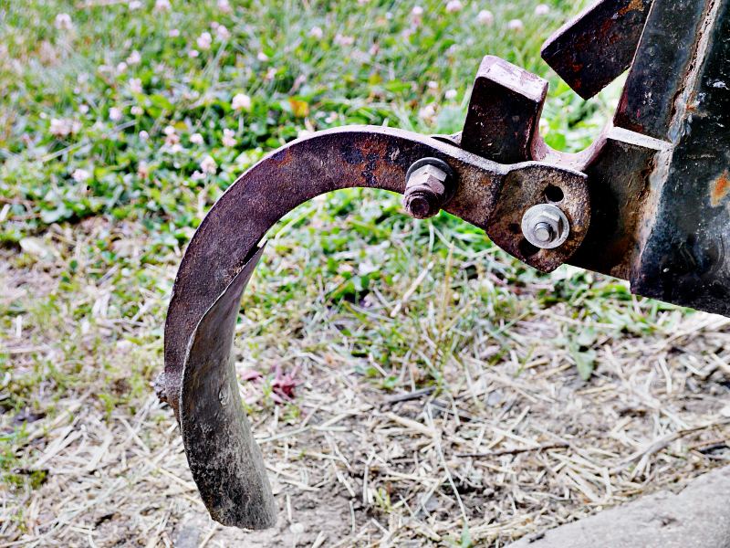

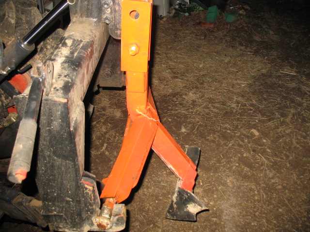

I have, should say had until today, the KK XB combo unit. Purchased mine from TSC with County Line name but is exact same as KK. First to note this is dimensioned to fit a SCUT, has narower lift point width and lower top link height. I modified it to fit my Quick Hitch, no problem until today when cutting a ditch through the yard for the TV dish cable.
Below is pictured what can happen when it meets an imoveable object with too much traction. Snagged a stump I had cut off below ground level few years go and forgot about it. I can't blame it all on the subsoiler. It was doing a great job on roots and I did stop when it first hit the stump but thinking it was another root I raised it a few inches and tried again. That time the tip of the tooth was against the stump and just folded it back.
Think I will upgrade to a little stronger version.

Excellent evidence that a CT225 is not a SCUT even though it puts out the same HP as a BX25.

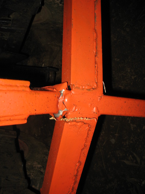

I use the middle buster from TSC. It is not the subcompact version that has the subsoiler blade. The reason I went with this one, was because I had read the reviews on TSC about the smaller version breaking like in the photos in this thread. I have very rocky soil in New Hampshire with large chunks of granite, and I have hit several of them, and the middle buster actually pulled them out of the ground without a mark on the unit. They redesigned it a bit, and TSC's 3 point equipment is made by King Kutter for the most part. Again, I have been very happy with this You can see the design differences between this one, and the lighter orange model that they sell. I would recomend it, and they go on sale a lot.
