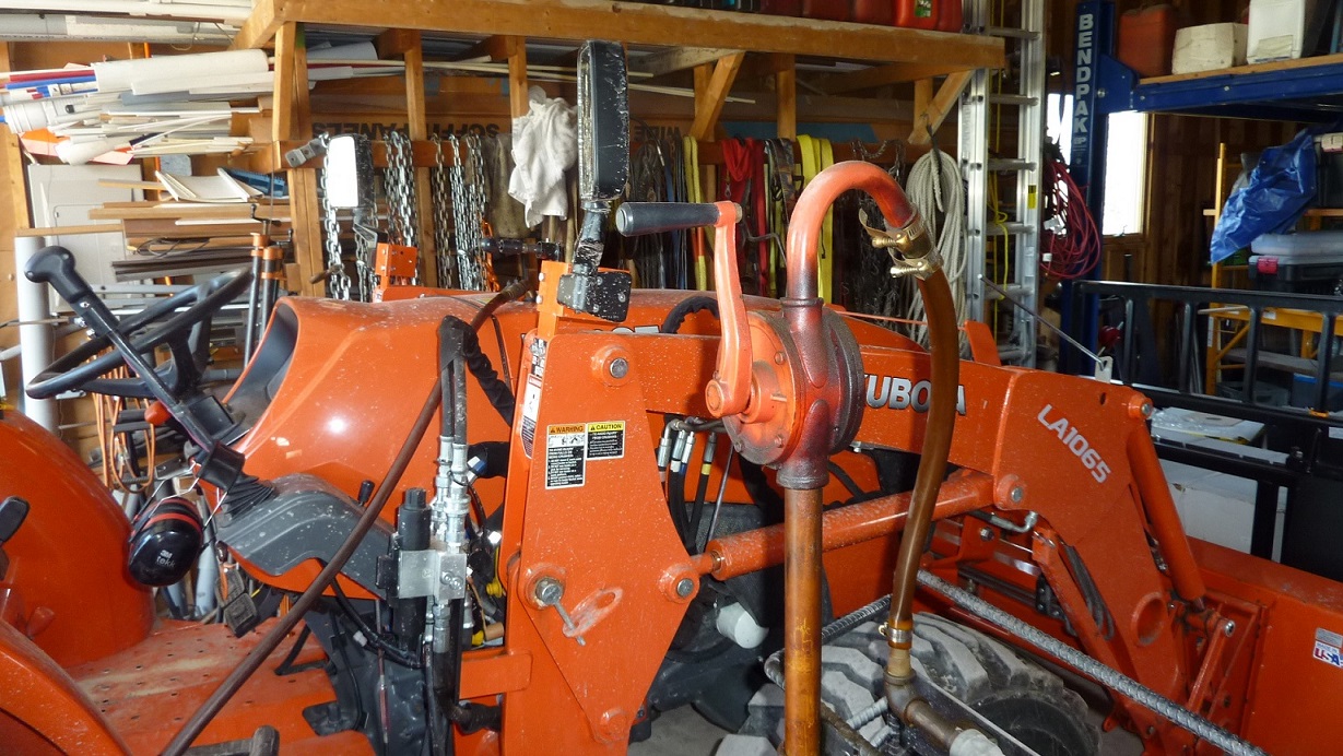

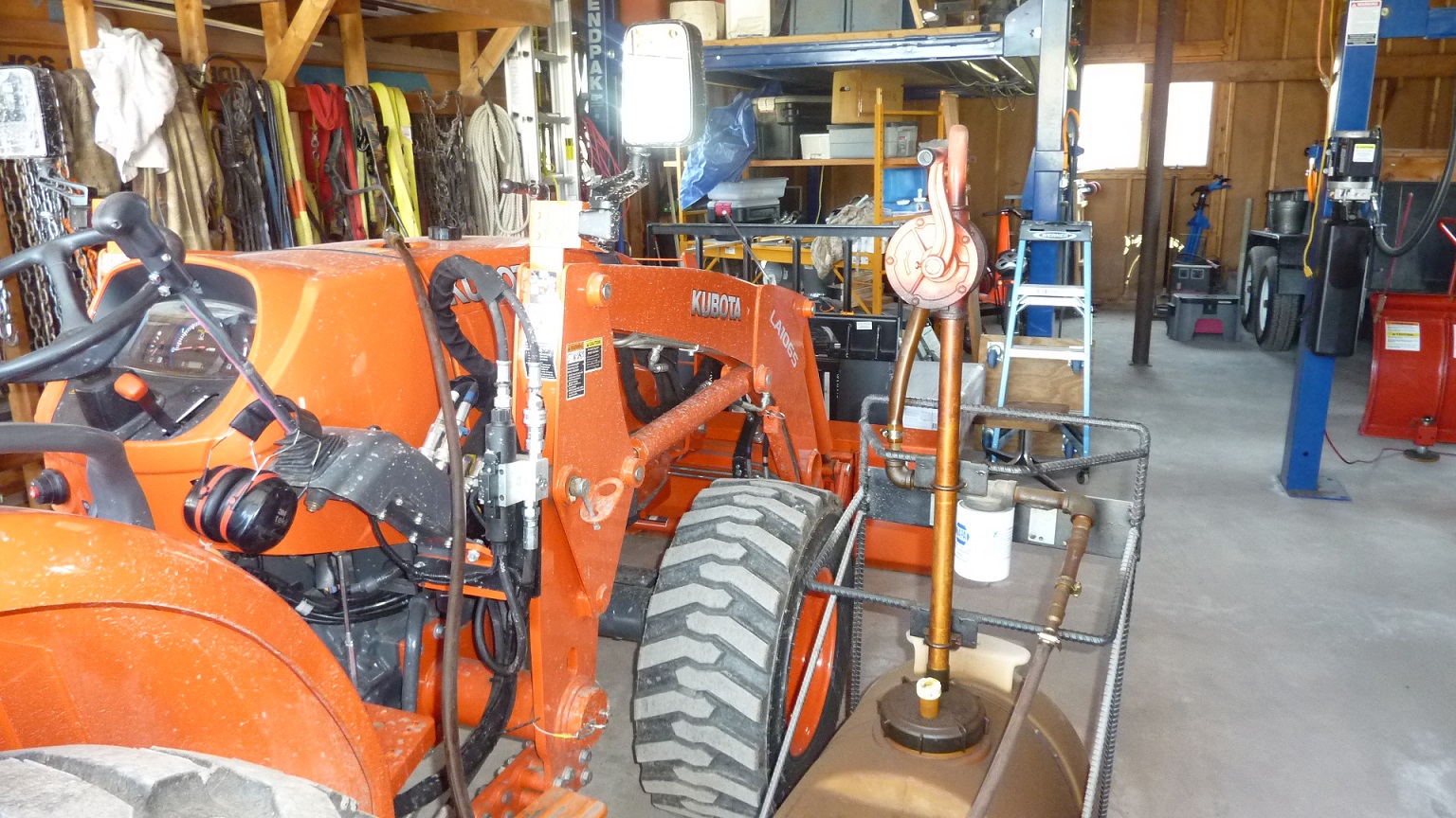

I have W&R Long 3rd function kits on both my L6060 and MX5800. The kits were reasonably priced and relatively easy to install with all necessary hoses and hardware included. On the MX5800, the control switch is located in a joystick knob which replaces the OEM. The wiring and control shaft are encased in shrink wrap which makes for a clean installation.
The switch on the L6060 is built into the OEM joystick and uses wiring already in place.
