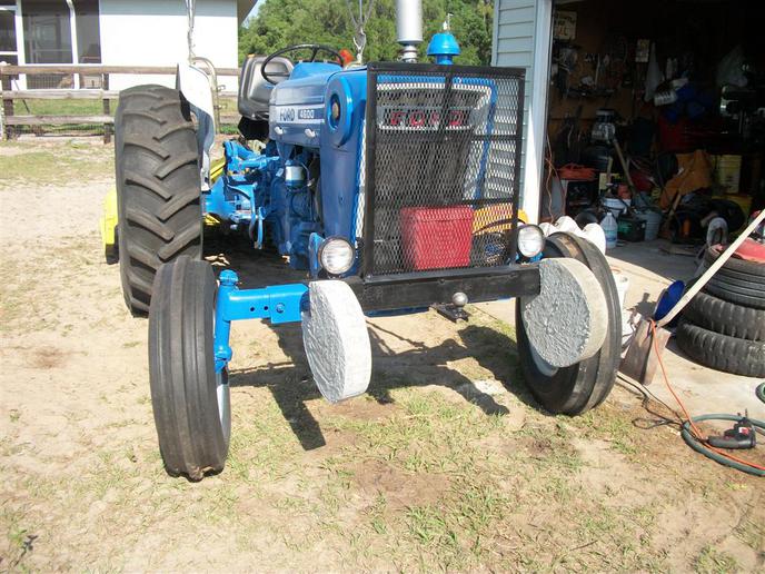

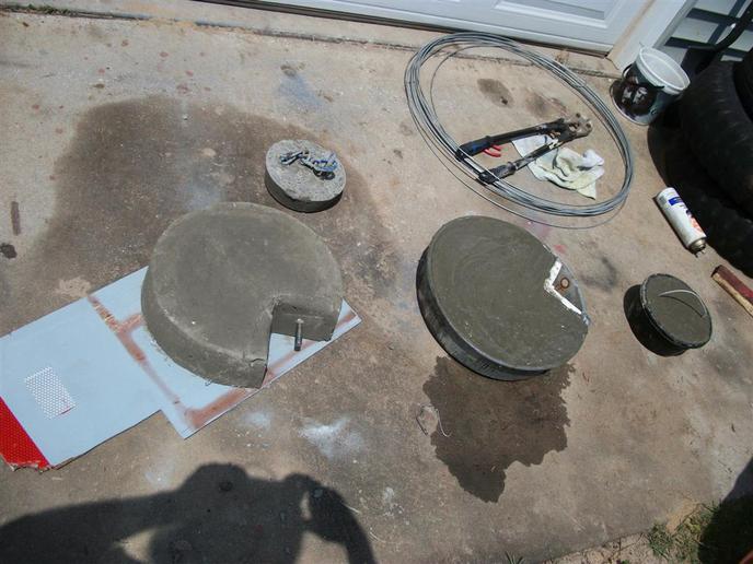

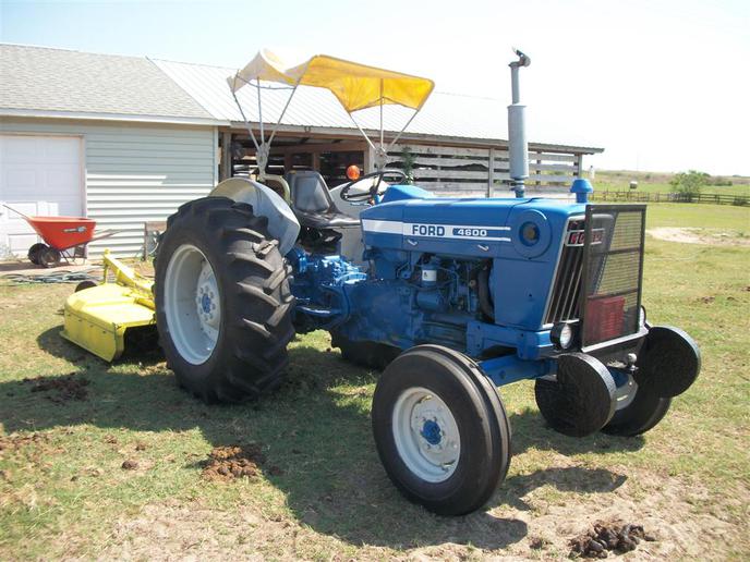

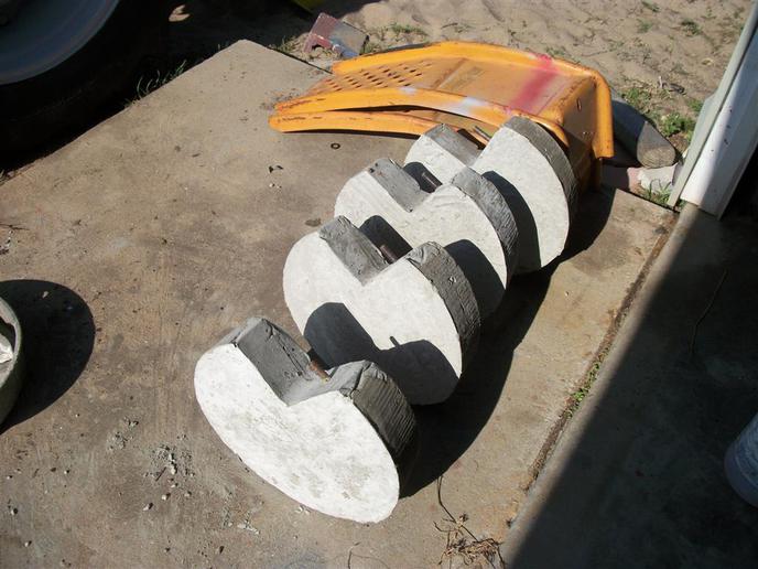

yep.. here are some fronts I casted for my 4600 ford
used an old feed pan, fence brace heavy gauge wire.. and long carriage bolts I bent to shape..
I used leftover sakcreet ( like quikcreete ) from a project I had worked on setting some posts.. turned out awesome once I put black paint on them.
I had a very heavy mower on the rear of the 4600, and I have a deckover trailer with a steep dovetail.. befor ethe weights, sometimes the front came up a lil while loading!

Those came out great! Thanks so much for the photo and the idea! I am going to try to reproduce these for my tractor, to add some additional weight. I am impressed how the final outcome is once they are mounted and painted. Nice tractor too.. Thanks again!

yep.. that 4600 is a great machine.

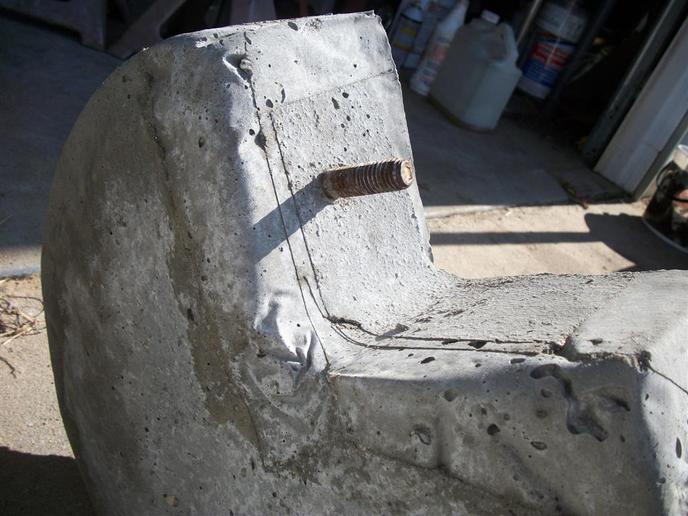

i used the pan and some duct tape and styrofoam to make the forms.. spray pan / pam.. add wire and bolts.. poked bolt thru styrofoam to hold in place.. pour.. let set.. pop out weigth and foam.. pull foam off bolt reset foam and go.
do wrap bolt threads with tape to keep 'creete' from traveling up them..
after cured.. hit em with some black paint.. almost looks like cast iron.. but at 1/20th the price .. and still significant weight..
