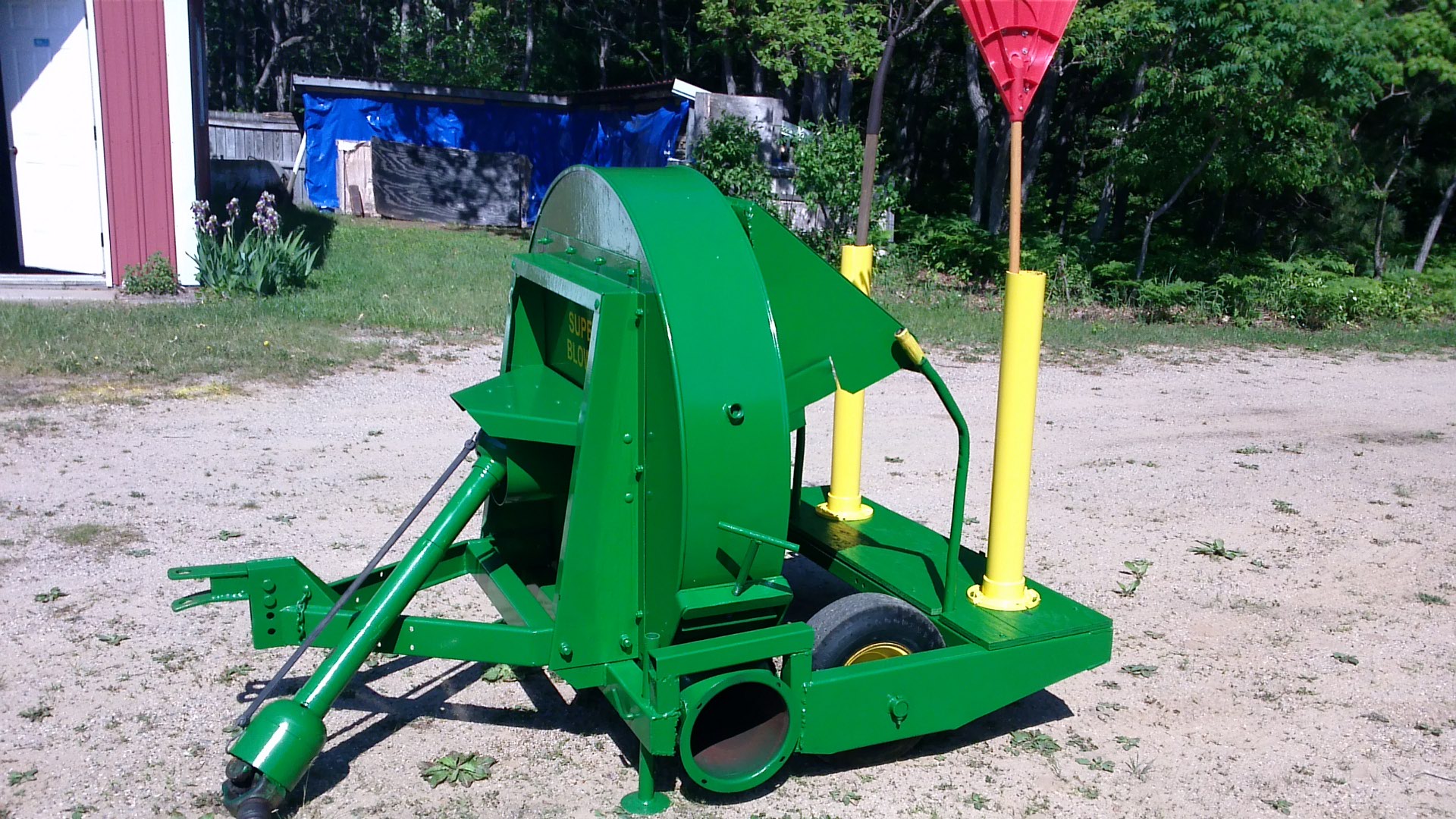

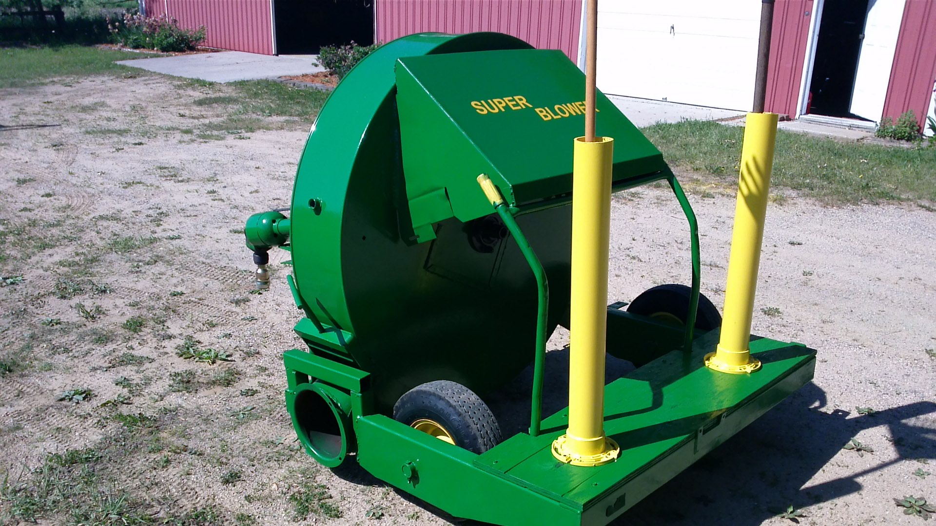

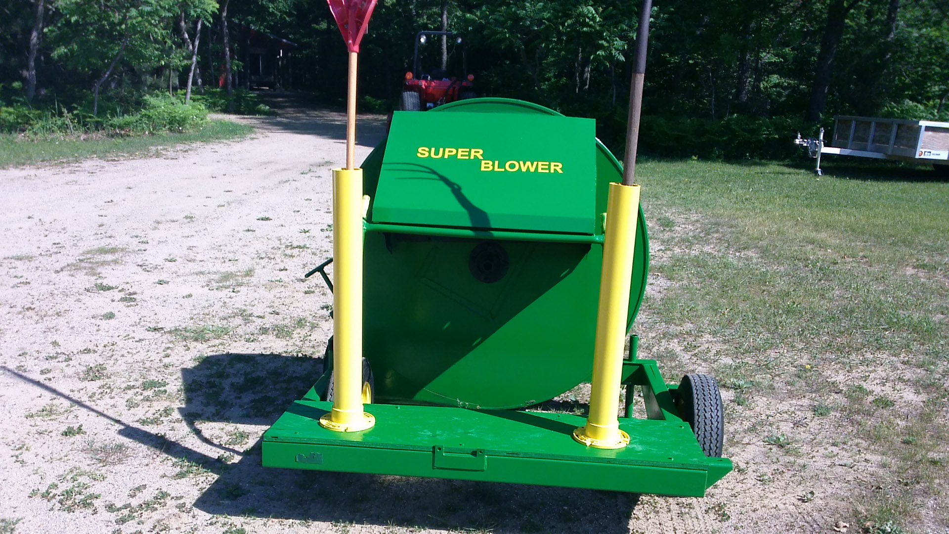

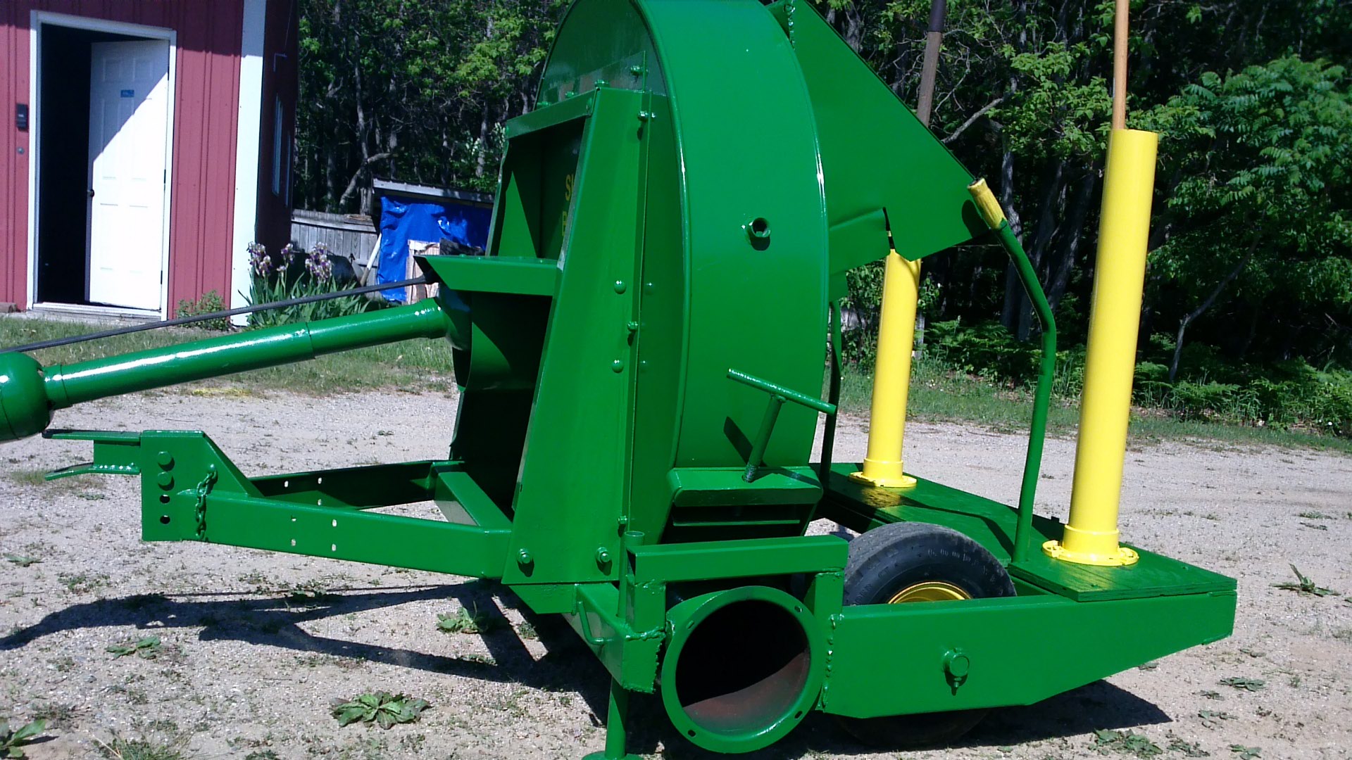

Our home is surrounded on three side with woods. In the fall the lawn gets covered with leaves. I am getting older and tired of raking. I have been looking for a big leaf blower to use. Couldn't find any that I liked or wanted to afford. So I built my own!! I picked up a used JD 6000 forage blower for $400 and modified it to make my "Super Blower". I removed everything on the blower except the fan, frame, wheels and hitch. I recycled some of the sheet metal to cover the fan inlet and add extra support. I had to cut the frame so that I could rotate the blower outlet to 90 degrees +- and used a piece of 2" square tubing in rebuilding the frame around the outlet. I added a platform on the back and added two pics of 4" PVC for use in carrying a rake, fork etc. The blower spins at 1000 rpm and will blow my hat off at 30 feet. I think I am going to like this new toy!! To date I have less than $500 invested!

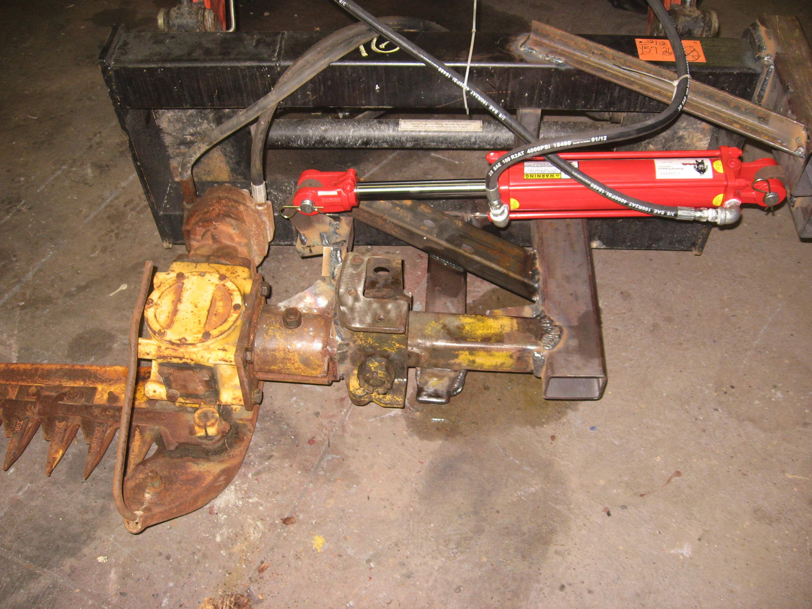

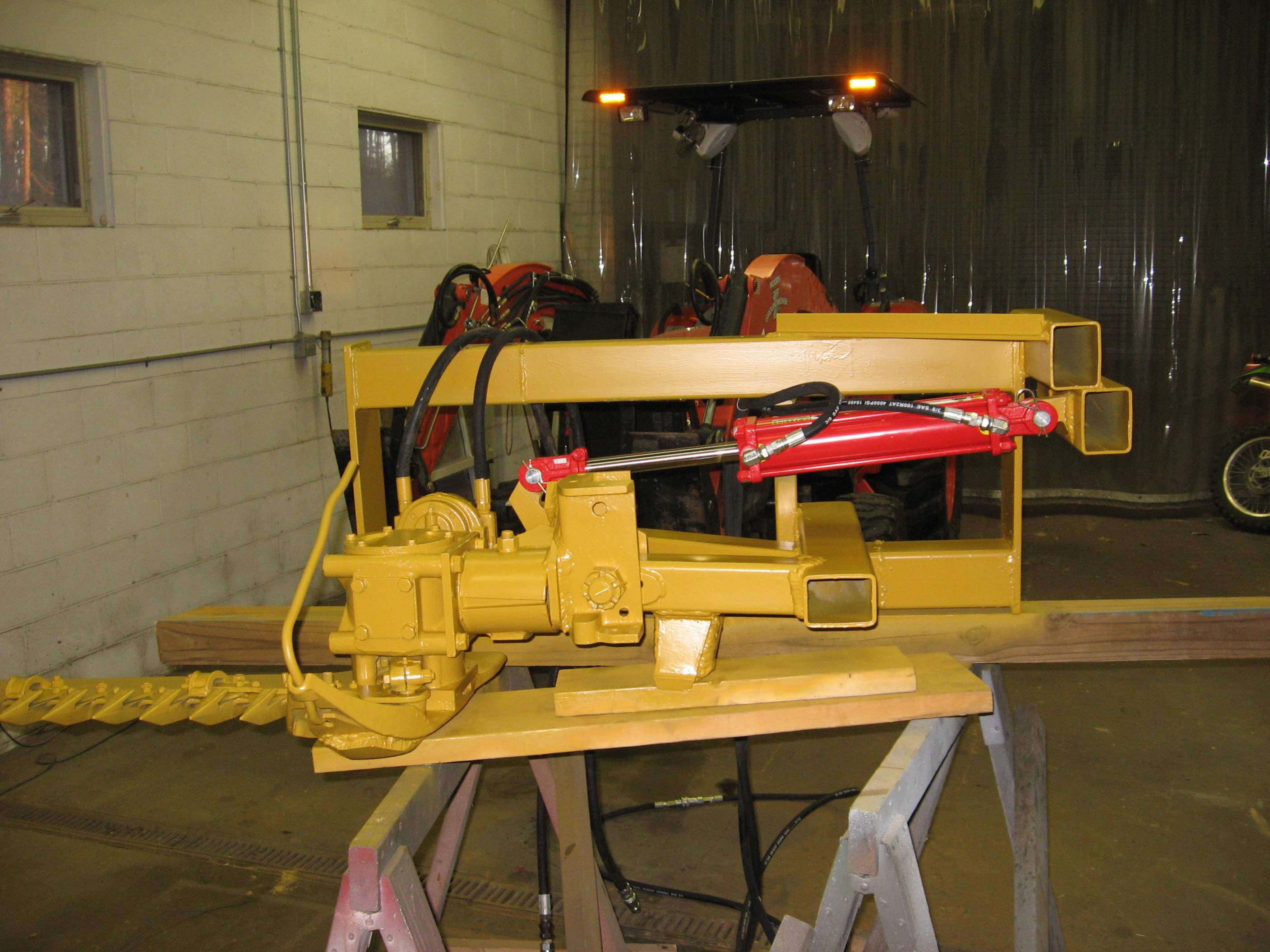

That is very cool and a great build. What exactly is a forage blower so I can start looking for one at a auction ? I would think they would be used for burning brush.
It is very similar in my quick attach front end sickle mower. Just made out of junk and a lot of hard work. It will be my next project, if I can find one.

Yes, that was a consideration and still is. I thought that I would try the trailer type this fall and see how it works. If it is a major problem I'll probably change it over to a 3 point. I did try it around the yard and didn't seem to be much of a problem as long as I didn't turn real sharp. I use a compact 1140 MF tractor with turf tires to operate the blower. Weight on the 3 point was one reason I kept it as a trailer. Also it is easier to drop a pin in the hitch and go compared to hooking up a 3 point every time I want to move it. We'll see how things evolve!!

A forage blower is used by live stock owners to fill upright silos. It will blow chopped corn or grass 60 Ft. straight up an 8"pipe at a very rapid rate. If you look for one, get one designed to turn at 1000 RPM provided you have a tractor with a 1000 RPM PTO. Otherwise you can use one rated for 540 RPM, standard on most tractors. It just won't blow as strong. Good luck!

Tried out the blower today and it works great. What used to take me 2 hours raking now takes me about 20 minutes using the "Super Blower". It will blow leaves 50+ ft. I blew them into a large pile and then hauled them away. I use engine speed to control the distance I want to blow the leaves. It is kinda fun to use.
