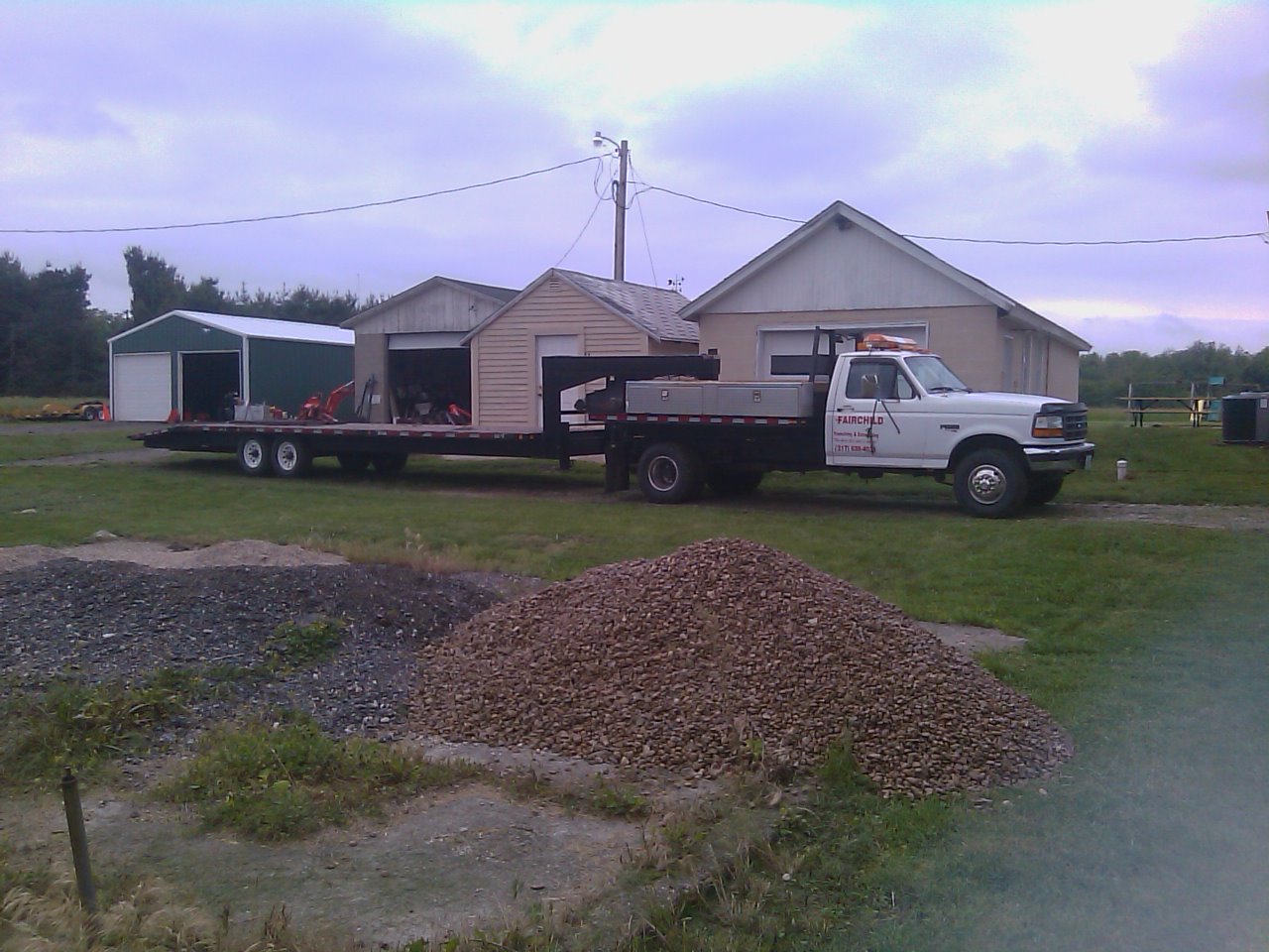

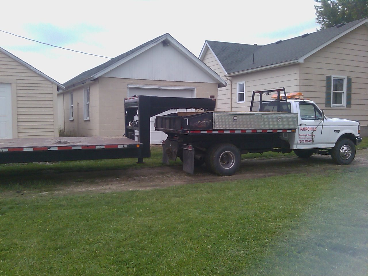

Well been a while and truck has been working well. Had several really overloaded loads on it and it dumped them with easy. I have had wet dirt in it and dumped it fine. Tonight was 1st time I need to put the gooseneck on it and worked fine. I went through several ditches in a field and bed never hit trailer. The pictures make it look closer than it is.
