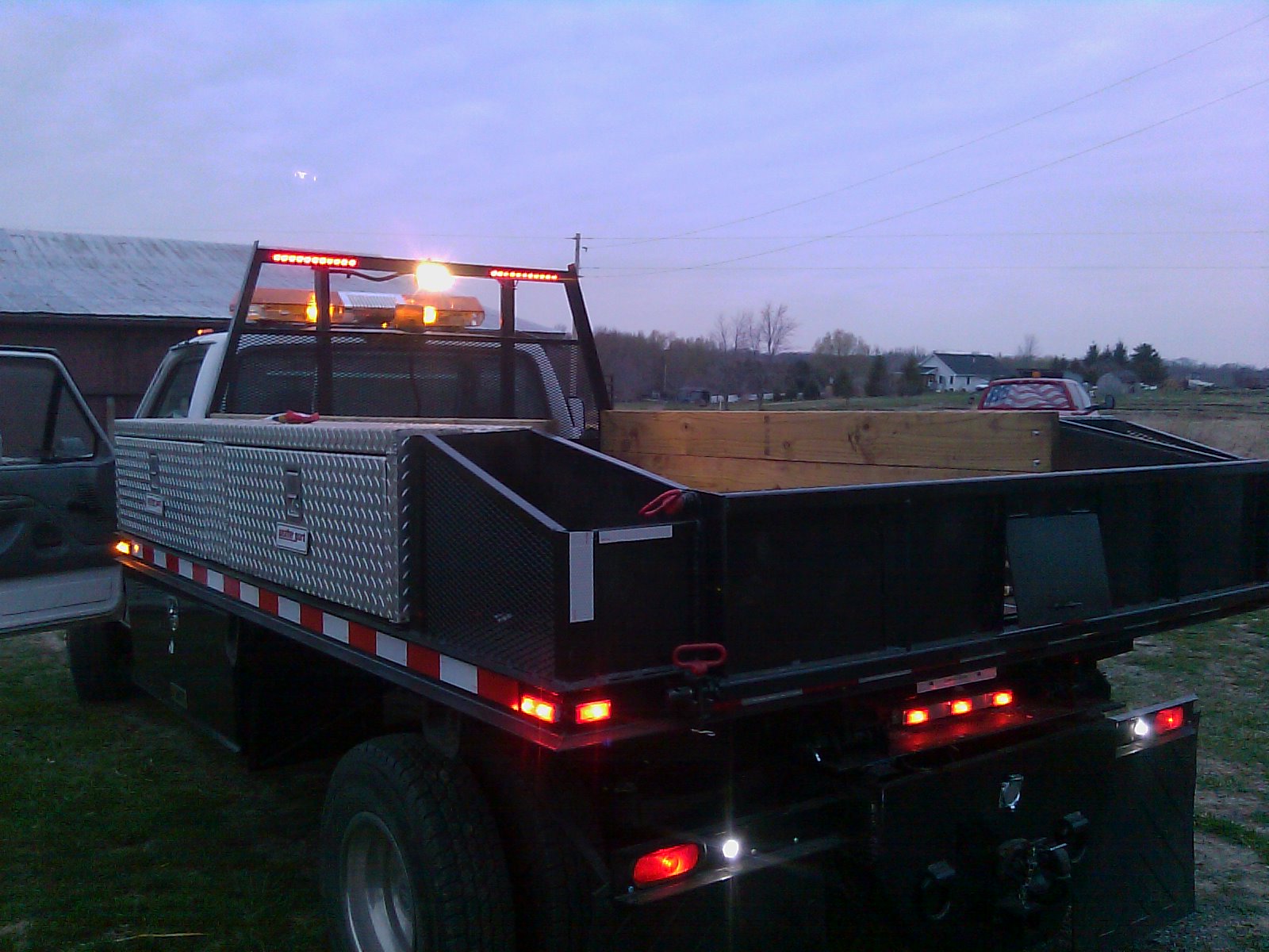

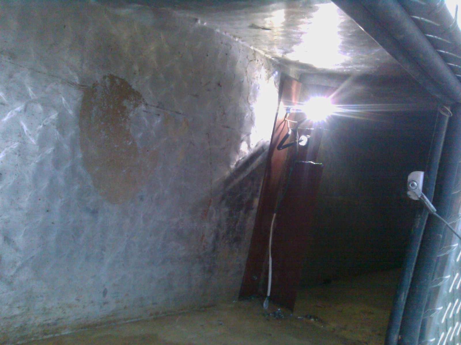

I have 2 8 foot 16 x 12 boxs on the top of the bed along with a 2 foot open box to put stuff in, then put 2x behind to keep dirt and rock from the boxes. Then on the bottom I put a 48x18x18 box on the drivers side which has the pump and a 2500w inverter in it them I am putting a 48x24x18 box made out of expanded metal to put my fuel cans and other junk in on passanger side.
Reason for all the boxes is this truck gets used for a service/supply truck that gets worked out of. it will be nice to have all the stuff in one place and not have to load up for every job.:thumbsup:

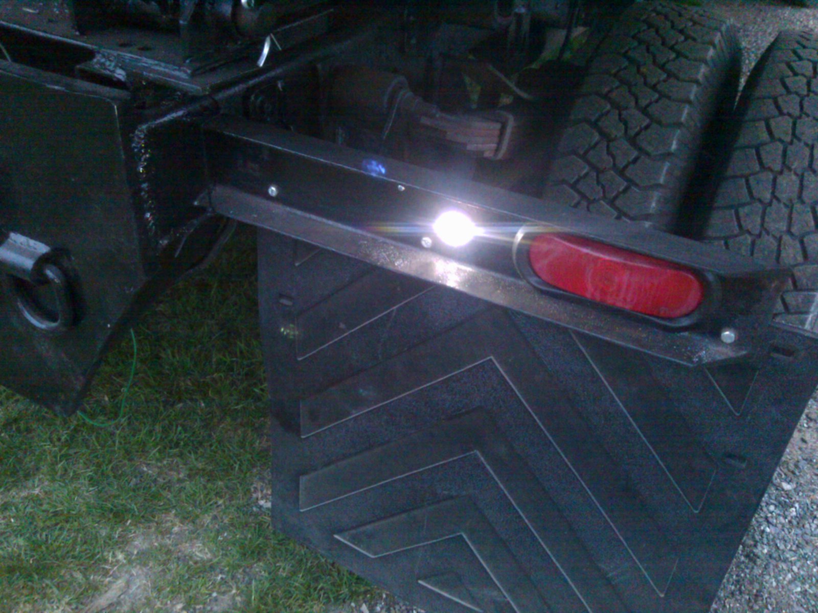

here is a picture of the lights that i put in the boxes and under the bed they are bright and seem to be good quility. I got them from Maxxima M09400WCL WHITE Clear 6 LED 1-1/4" Marker Light - eBay (item 370467857938 end time Apr-17-11 14:05:24 PDT)
good people to deal with I have gotten lots of stuff off them over the years.

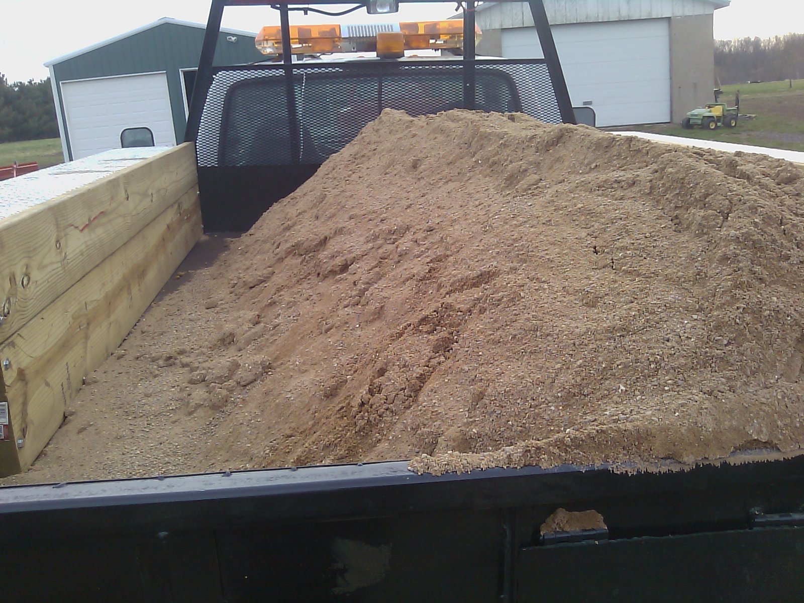

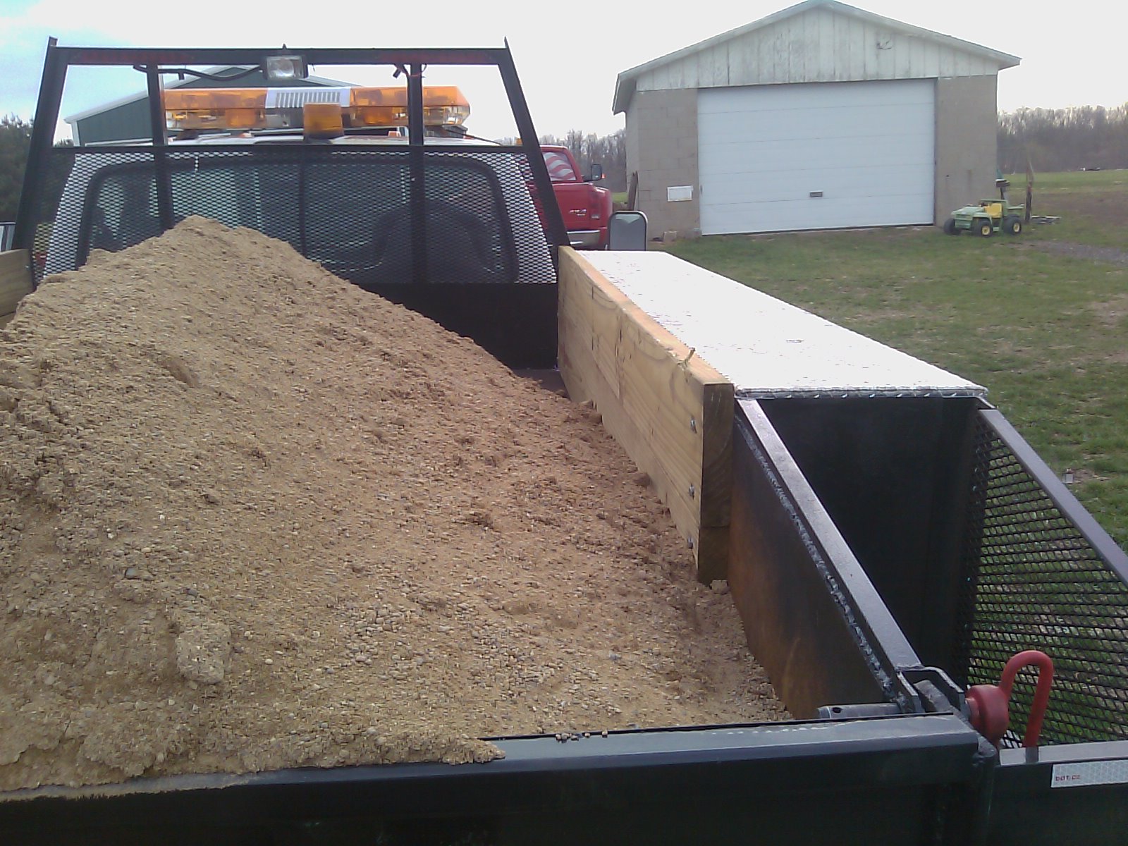

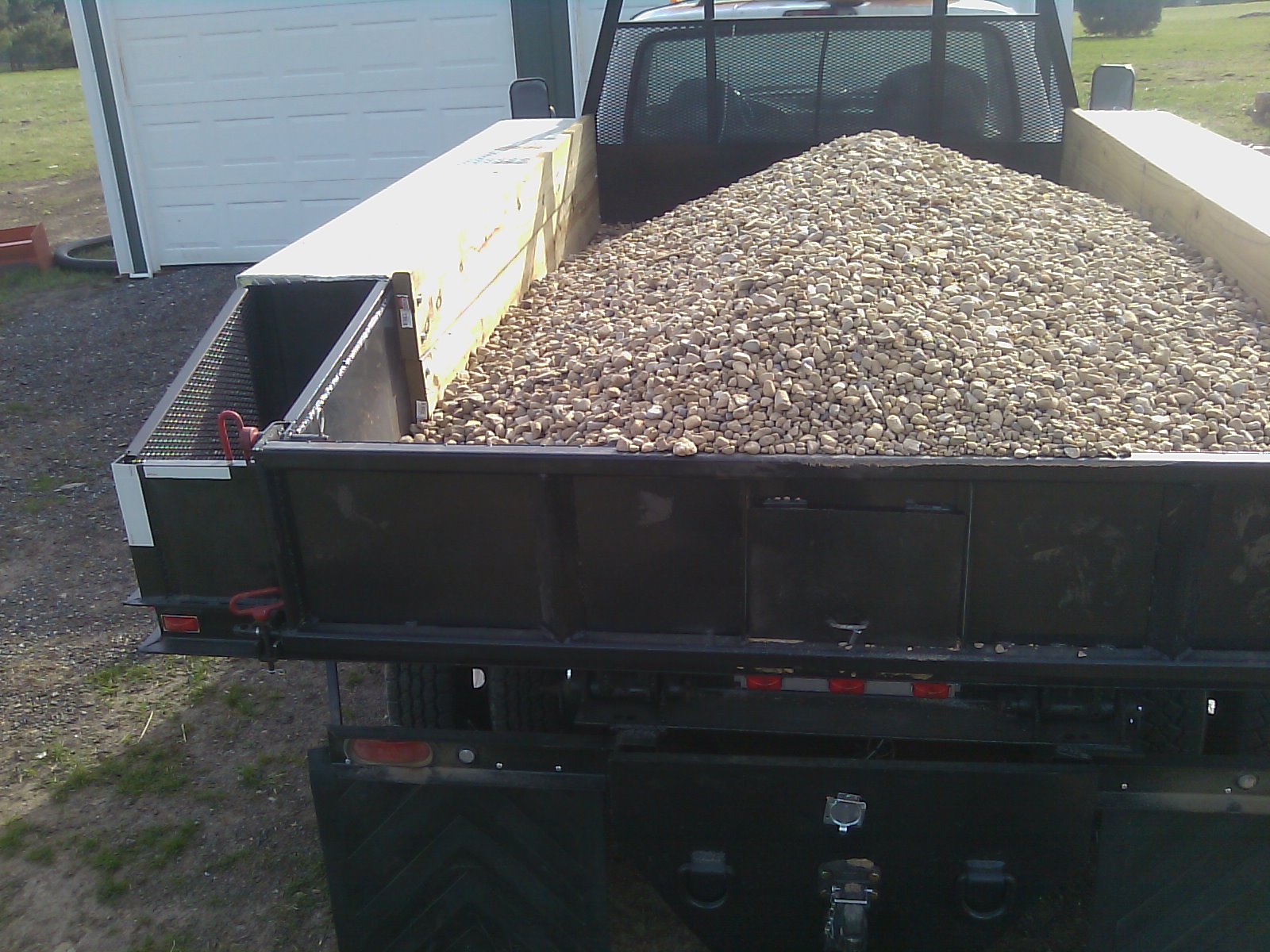

Weighs 8650 with me and 1/2 full of fuel and some stuff in the boxes so came in a little lighter than I thought but that is a good thing. With the other bed without fuel or me it was 9500 lbs. Only thing I have hauled is scrap iron but dump it just fine.
   / Superduty dump build
#49
Well been using this for a week or so and hauled some scrap iron, sand and landscape rock. it works very good and dumps with more than enough angle that nothing sticks in it. The gravel pit were I get material is very good at loading so I have kept it at 3ton and no more as dont want to over load the truck. It dumps just fine and 3 ton looks like such a small amount in the bed of the truck so I will have to be careful not over load when loading it @ home. Enjoy the photos
